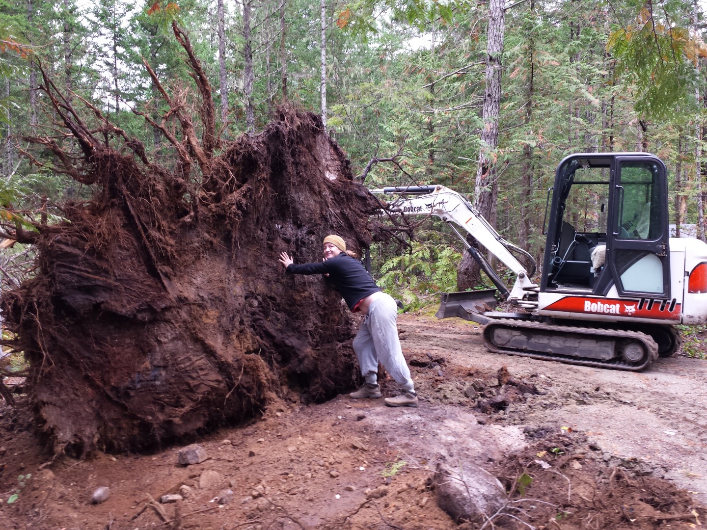

It is January and I'm not so sure I'd be out and about with a canopy version. A cab version not only makes it cleaner, but quieter and comfortable, temp-wise. I prefer winter weather, as long as it is above freezing, to play. Machine stays cool, dust is at a minimum.
Definitely worth getting the biggest machine you can. A size bigger than what you think you can make due with. You get not only more bucket power, but reach. I wish I had a bigger machine than what I have (331 Bobcat), but once I've finished with the big trees, I'll have a perfect sized machine for whats left (road maintenance, rock walls, trenching and landscaping). If you have rocky ground (packed glacial till for example), don't go with a small machine.
