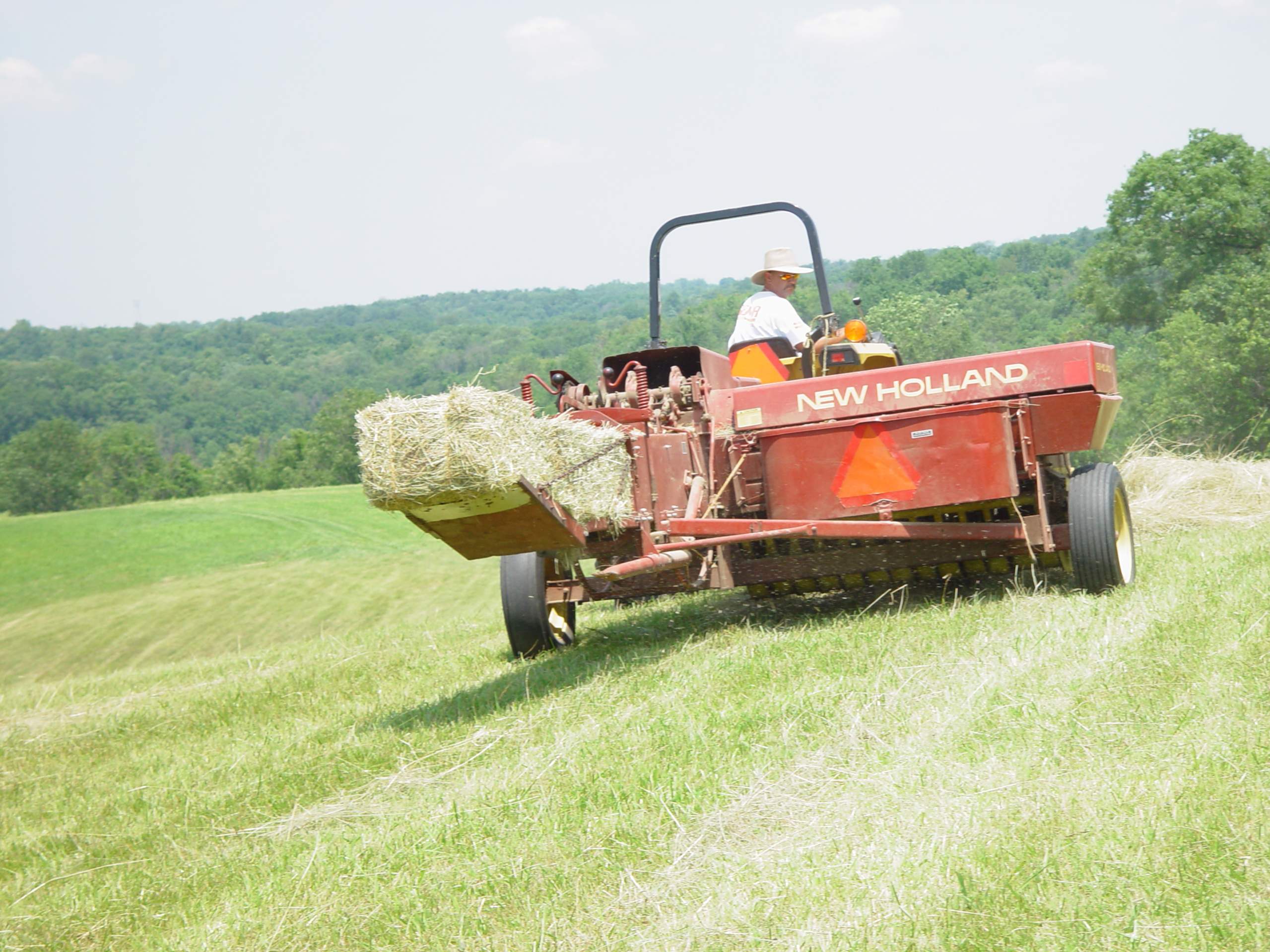

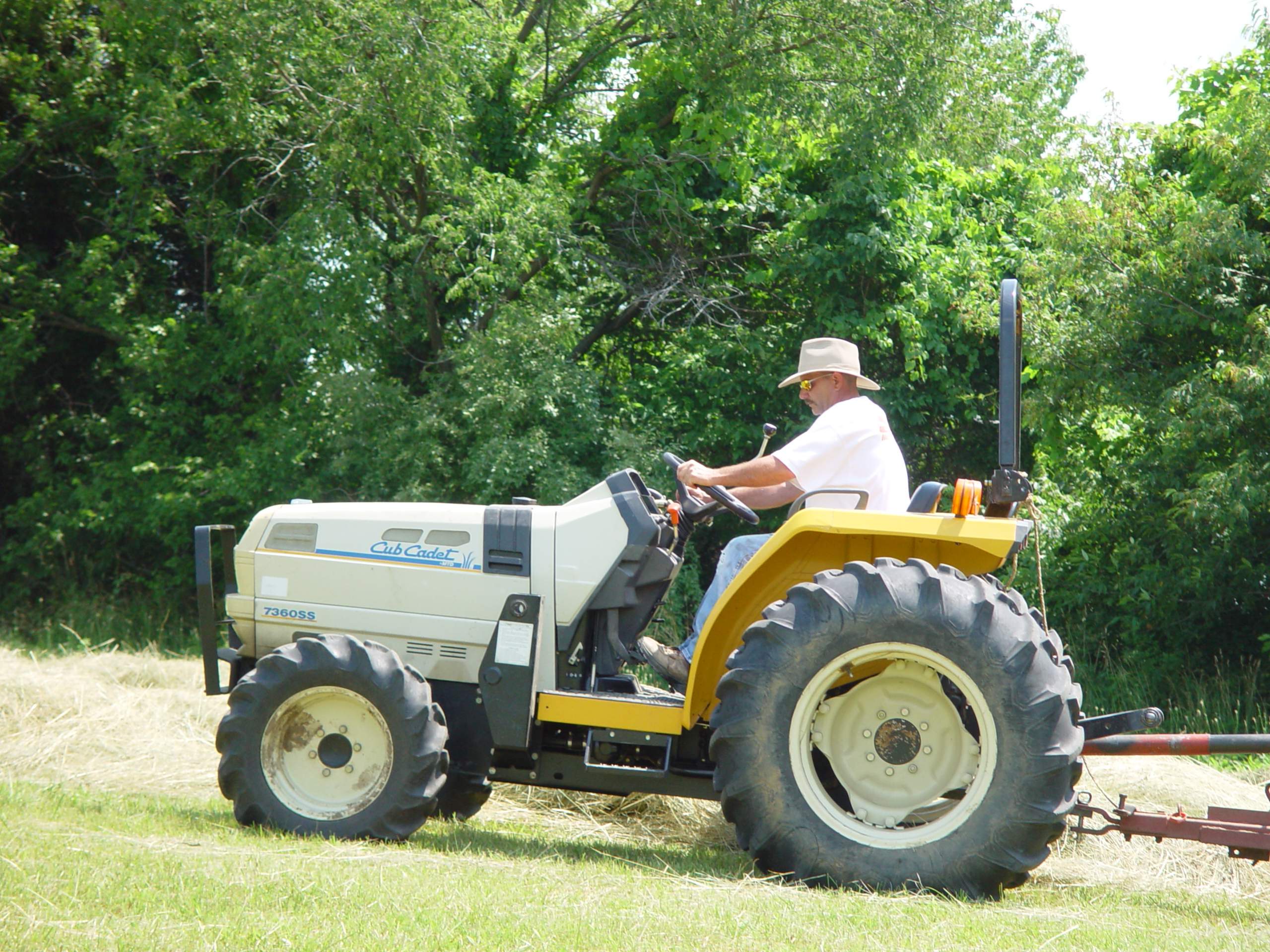

Hello folks I am on the hunt for a smaller size hay baler to pull behind my 25hp tractor. I anyone has one and could send some pics or some info on it that would be great. Im not sure if the even make a baler for a tractor of that size .
I ran a NH 310 behind my 36 hp cub cadet 7360ss baling about 25 acres grass hay last year. Planning on about 40+ acres this year. My tractor weighs about 3900 lbs w/out the FEL on it, but I have an additional 600 lbs liquid in the rear tires.
The 310 specs says it needs 19 PTO hp. That may be so, but up and down hills become a little tricky. The drive line on these little tractors I feel are not made to take the plunger pounding year after year.
I plan on trying to upgrade the tractor to a massey 50+ hp or something built more like a farm tractor next year if I can see clear to do so.
I would say if you want to get by a year to 2 most, you can probably do it if the hills are not too bad.
Dw
