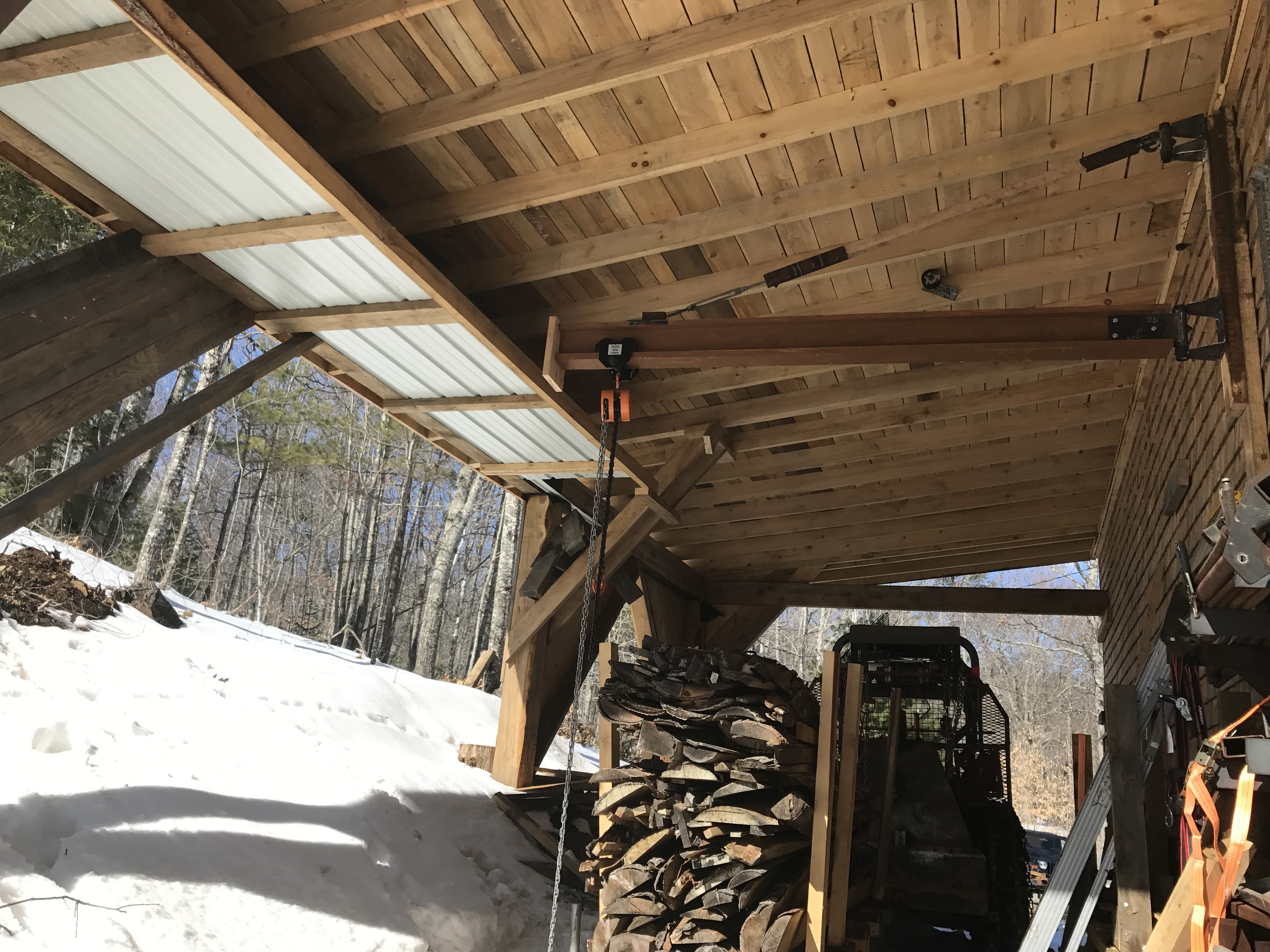

Close sort of, it's Jonsered 2171 with new 24" bar, had 18" but quite couldn't reach through the bundles, always nice to have a tool to remember somebody by, I have some myself.
Shute wouldn't really work for what I want to do, I have a 8' shelf next to the saw crib that I hope to stack atleast 3>>2'x2'x8' bundles, cut up in 20'' smaller bundles. This shelf is 4' above inside garage floor, there's a window right there to reach through, get a arm full of wood, take it over to the stove. The worst idea was my son kept saying, never mind making a crane, just use a wheelbarrow, I said if you say wheelbarrow one more time, your fired. I'm over qualified to operate a wheelbarrow and I dont have a wheelbarrow operating licence, not getting one either...

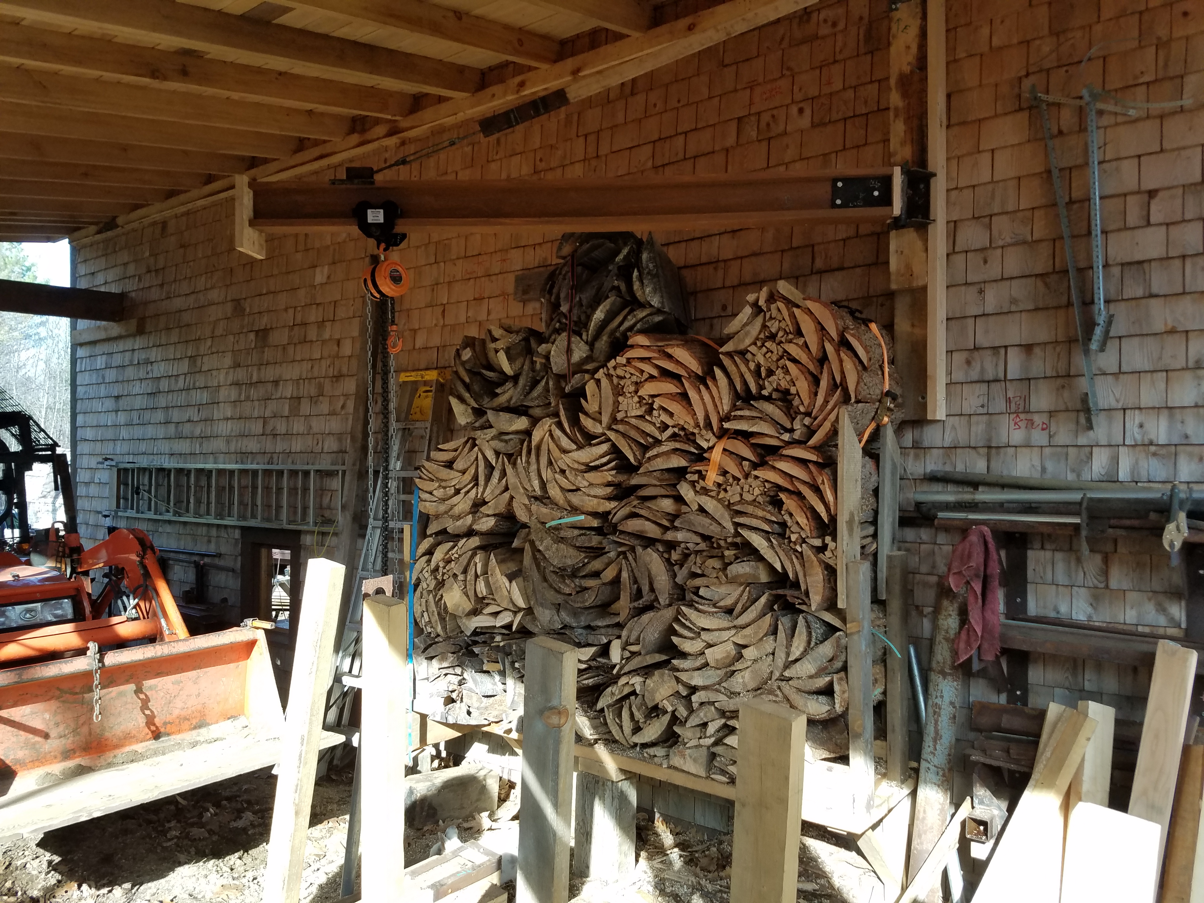

I really like the concept - love lifting things with equipment instead of my back :)
This is just my opinion, but I'm pretty concerned about the screws pulling out.
Screws do good with sheer loads, not so good with holding a pulling load like your lever has created.
When they go, they likely will fail quickly.
Still, kudos for making cool stuff.
"love lifting things with equipment instead of my bach"
<<<< you and me both
The top crane hinge has 2> 3/8''x12'' bolts going through the wall and through 2 doubled up 2"x6"x22" nailed together, they are nailed and screwed to in between the 2x6 wall studs<<are 2'ft on center, these are inside laying flat ways, then there's 3 more double up 2x6s inside down the wall laying flat ways, the outside plank is lag screwed into them also, not quite OSHA approved but think it's secure, more test needed.
Where I wanted the crane to fit didn't quite line up with inside wall studs, so I double up some 2"x6"x22" to fit in between them, if your not kunfused yet, I'll get my son to take a few more pics. this weekend, I have some more bundle to cut.

Your construction of the beam sounds solid enough to me. The glue joint itself between the lower flange and the web should be enough to hold the weight you need to support. I've just seen too many places where people have thrown things together without thinking about how strong the connections are, and what kind of loads it will actually receive.

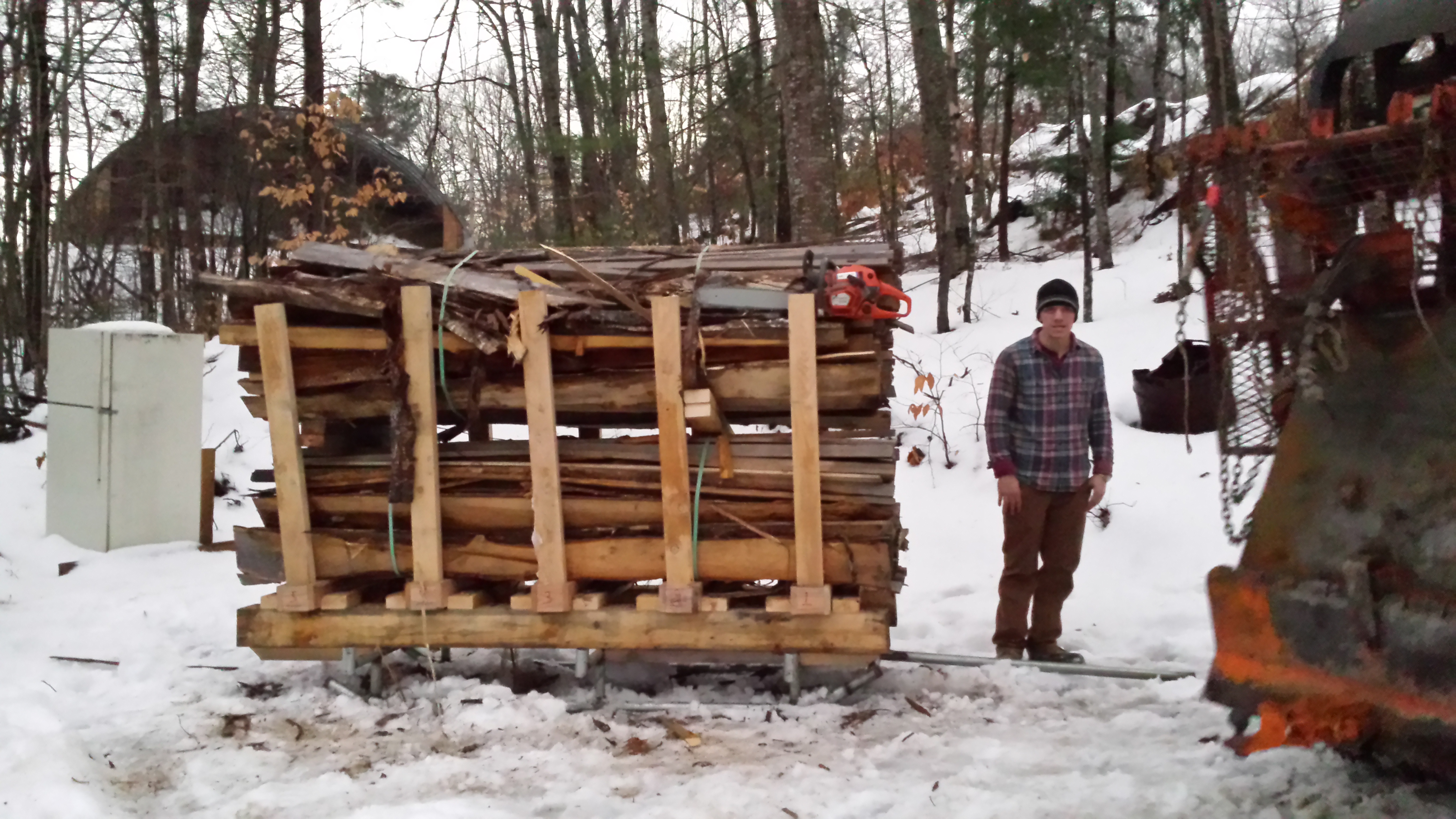

Before this thread gets rusty, some final pictures, I finally emptied my firewood crib this past weekend that was sitting for over a month. Had two> 2'x2'x8'-ish sawmill slabs in the saw crib, marked out 20"-ish long, got the bathroom scales, check 2 sawed up bundles, weighed in at 125lbs ea. I got 8 bundles from the two bigger bundles, had 3 already on my firewood self, the last bundle had to be put up with tractor FEL. So during the course of an average winter, this will have to be done 3-ish times. I'm ok with that, right now I have 35> 2x2x8 ft. sawmill slab bundles stacked up outside, some are 2 years old.
When making this slab wood shelf, I first figured in my mind there'd be around 500 lbs on it, while jibbing the bundles over to the shelf, my son started doing some weight calculations on smartphone, 8+3=11>bundles = a bit more 500 lbs he said. So halfway through unloading the saw crib, did some post and beaming under the shelf just incase there was some building shortcuts in making this firewood shelf.
All this construction and production was supposed to be done 5 months ago, needless to say I'm slightly behind schedule, but I'm still under budget.
