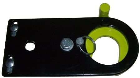

I got this Small Wagon given to me. Maybe eight feet long, four feet wide. It's got a clevis. But often my machines have a ball. The Gator has no receiver, just a 2" ball.
Should I just put a 2" coupler on the wagon? I have little interest in messing around with safety chains around the farm.
Is a coupler, less safe than a clevis? It is easier to hookup, that's for sure.

Hadn't though of safety-chains for OR towing, only use them for roading with ball hitch. Then again, how fast or far do you plan on going?
Could you use one of these? (~ $25 US.) Amazon.com: Yard Tuff YTF-1PH Lawn and Garden Pintle Hitch: Home Improvement

I pulled that ball hitch off my road dump trailer a little while ago, moving it around with the loader, so I realize how easy this can happen That's what makes me ask. Makes me a little leary about standardizing all off road stuff with a ball hitch.
I kind of like that pintle hitch thing, although i wouldn't give you five cents for the powder coat. Should caontact them and see if I can get one in bare metal so I can put some good enamel on it. lol

I guess it depends mostly on , anticipated loads, speed and terrain. I guess I TRUST a clevis, but not a ball, without using safety chains, and I don't want that hassle on the farm. I do like that the ball has no backlash. Trailer ball couplers are just so junky and mass produced. Hard to trust them.
AND, with a wagon, there is NO tongue weight!
