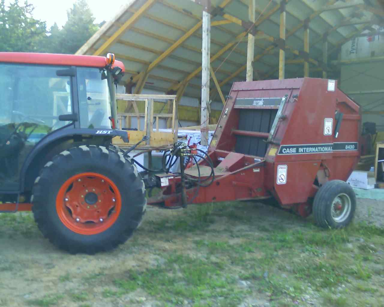

What size bale does that baler make
   / Small round baler? #8
   / Small round baler? #9
