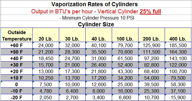

I found this chart:
So smaller tanks give more capacity per pound of propane, especially at lower temperatures. Three 20 lb tanks roughly equal a 100 lb tank.
