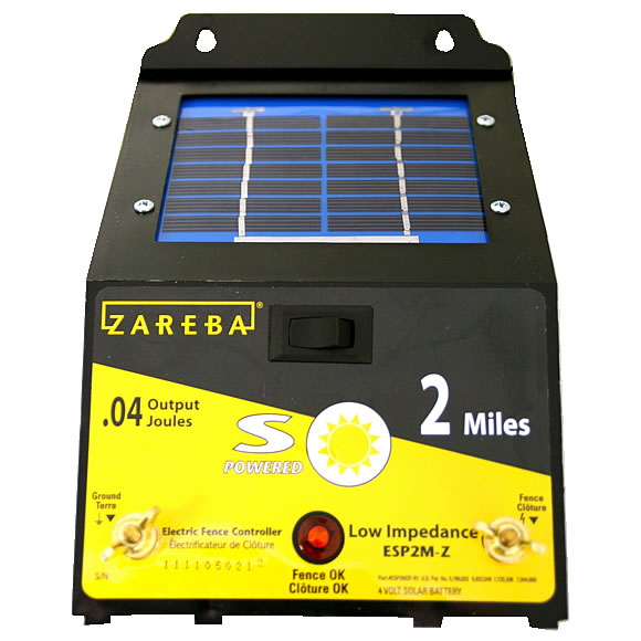

I have a remote horse barn that has no electricity. I am thinking about installing a small solar electric system to supply me with a bit of power. My goal is to run a 120VAC fence charger, and about 10 CFL lights as needed (not often, but occasional for up to 30 minutes). I have a 1000W inverter that I can use. I am thinking of a small solar array and at least one deep cycle battery. Anyone have any input on what solar charger I need to keep up with demand?
How much fence do you need to electrify?
I vote for the solar power fence charger and a separate solar system for lights.

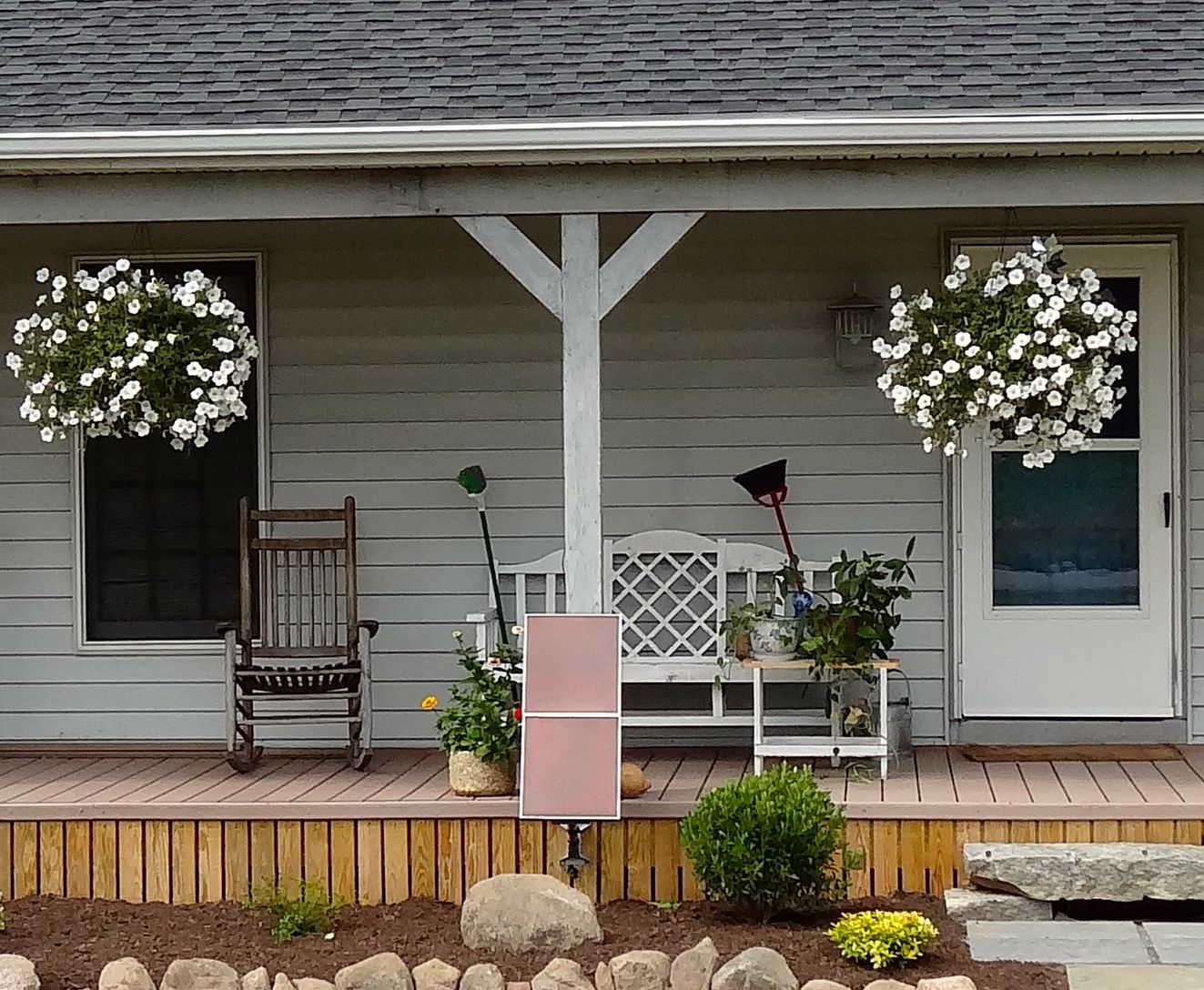

I have 2 small panels that came with a fountain pump that I have repurposed for lighting my front porch. I bought a larger 12 volt battery (deep cycle about the size of motorcycle battery) and wired 4 LED's under my porch. I could have bought better lights for more light but they do light up my deck enough to see in the dark and run all night for free. I have had this installed for about a year with no issues. I have another one setup for trickle charging my welder/generator battery.
I agree I would stay with 12 volt. Inverters uses too much of your power.
