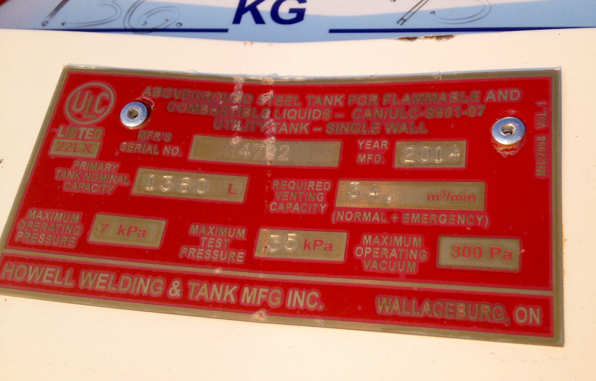

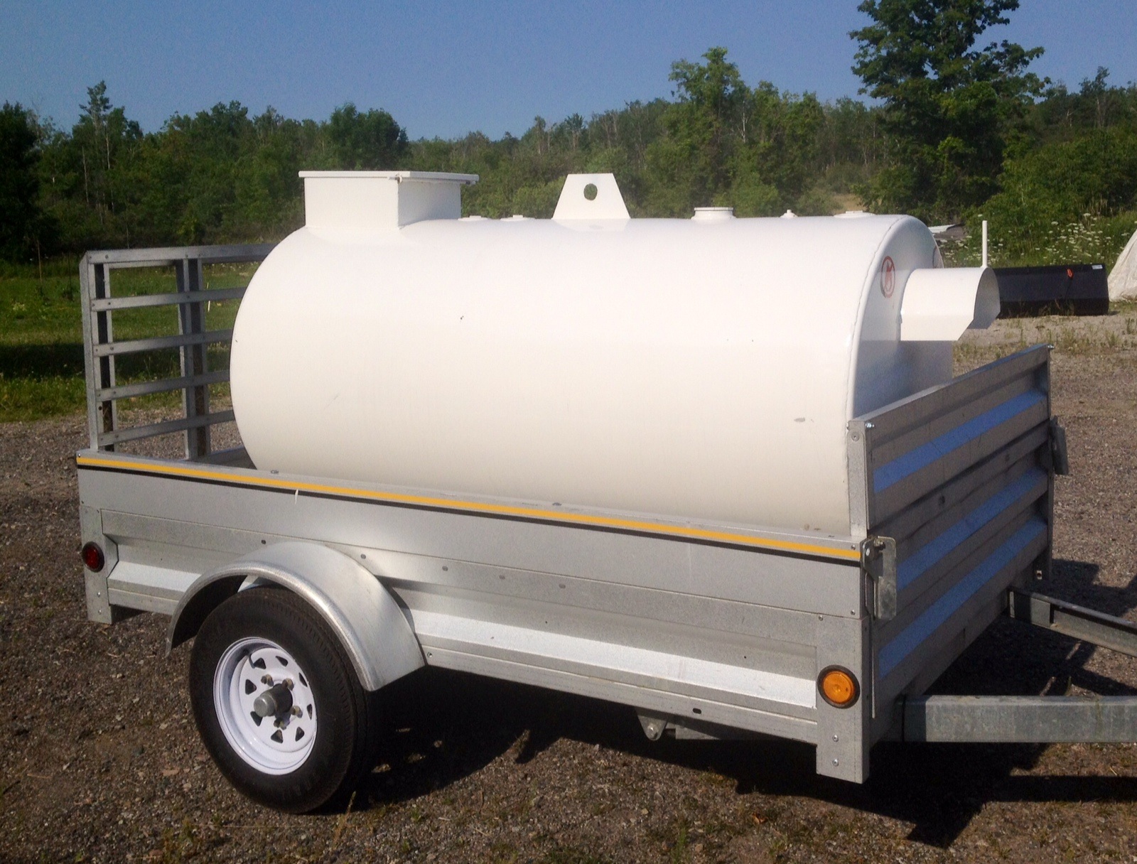

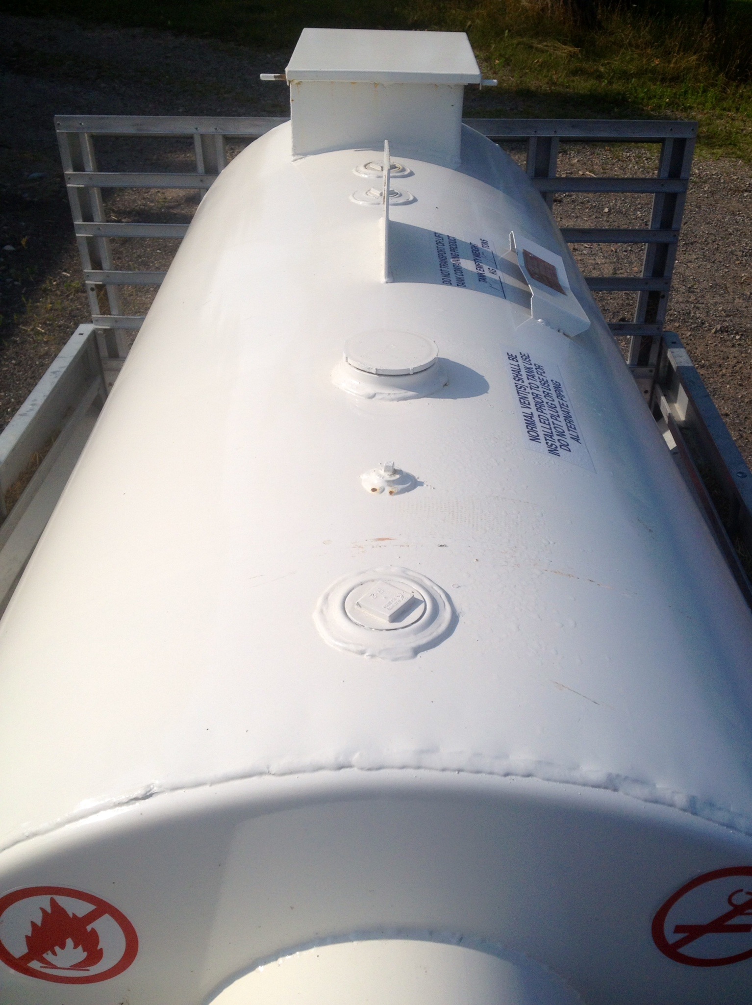

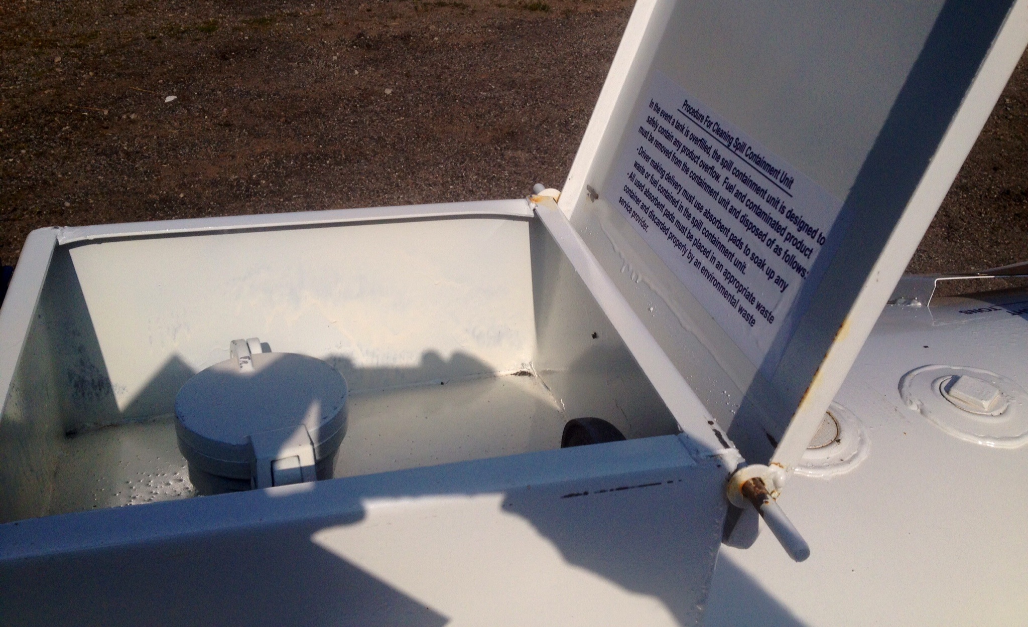

Hi guys,
This forum proved to be the most helpful for any related questions so far :)
I bought yesterday a small (1360L or ~ 360Gal) diesel fuel tank for my farm. Surprisingly there is a very little information about how to properly install it and what to do or what not.
There are an obvious variations on local regulations for this and Canada perhaps is slightly different than US but there is always common sense and good tips :)
It's going to be exposed to the real winter and I'm planing to use a hand lever pump (can't convince myself for $500 for electrical).
Pictures are attached and I would appreciate your advises.
Thanks,
Nikolai

So does the fuel flow by gravity, or just by the hand pump? If the fuel is pumped out and the tank can be mounted fairly low to the ground, I would make a pair of concrete cradles for the tank to rest on.
   / Small tank for farm diesel installation #3
Here's an example of what I mean, just on a larger scale.

The large (4") plastic safety plug on top of my 550 gal tank leaked and let over 20 gallons of rainwater in over a 10 year period. They didn't even put thread sealer on it at the factory. Even after I gooped the threads up with permatex sealer it leaked because the threads weren't round. If you can't put a roof over the tank I would lay something waterproof on top like rubber car floor mats over the openings.

That's a good size tank. +1 on the concrete cradle. We poured a footing and laid block. Set the tank skids on the block between two 4x4's. Not sure if your tank has a drain cock or where it is, but if it's on the back side, set your tank with a slight tilt so that water forms at the back drain cock. Set your pickup tube 2-3" from the bottom. We had a hand pump on the old tank. Would recommend electrical if you're going to be using it often enough. You'll tank yourself later...sorry, couldn't resist :laughing: Here's some more pictures if you're bored. https://www.flickr.com/photos/121757047@N03/sets/72157645592226671/
