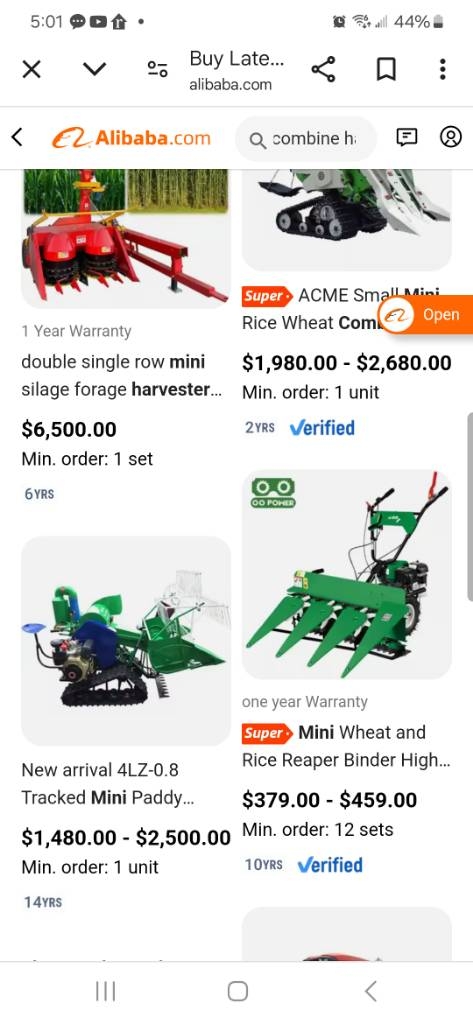

There are some questionable machines on alibaba, as well as some Truely micro things, that look like a battery powered sander, mixed with a vacuum cleaner, for stuff in the 5 gal bucket to maybe the 55 gal barrel worth of grain;

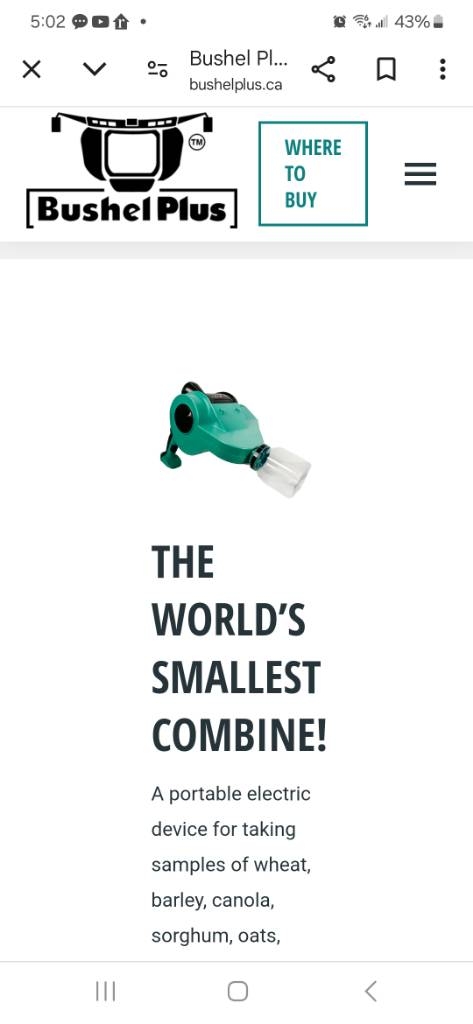

Here is article, with mixed review, of a BOAZ miniature wheat harvester.

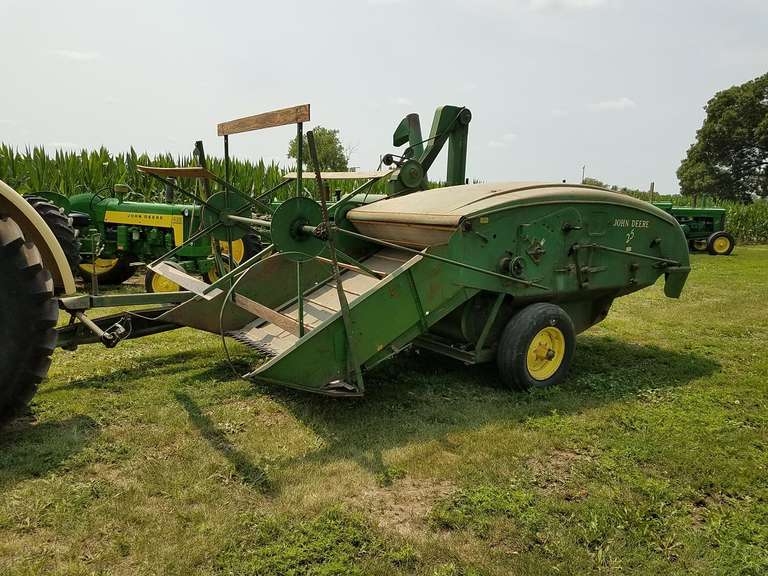

We had a John Deere 25 or 30 pull type combine. it wasn't very big and did a good job. All I remember doing for maintenance was greasing and replacing the occasional mower section. I don't think there would be much for maintenance other than (standard) belts or bearings.
/ Small (tiny) combine - pull type - for grains? #16
hardly larger than a dedicated swather!
Versitile self propelled swathers used to go mighty cheap!
