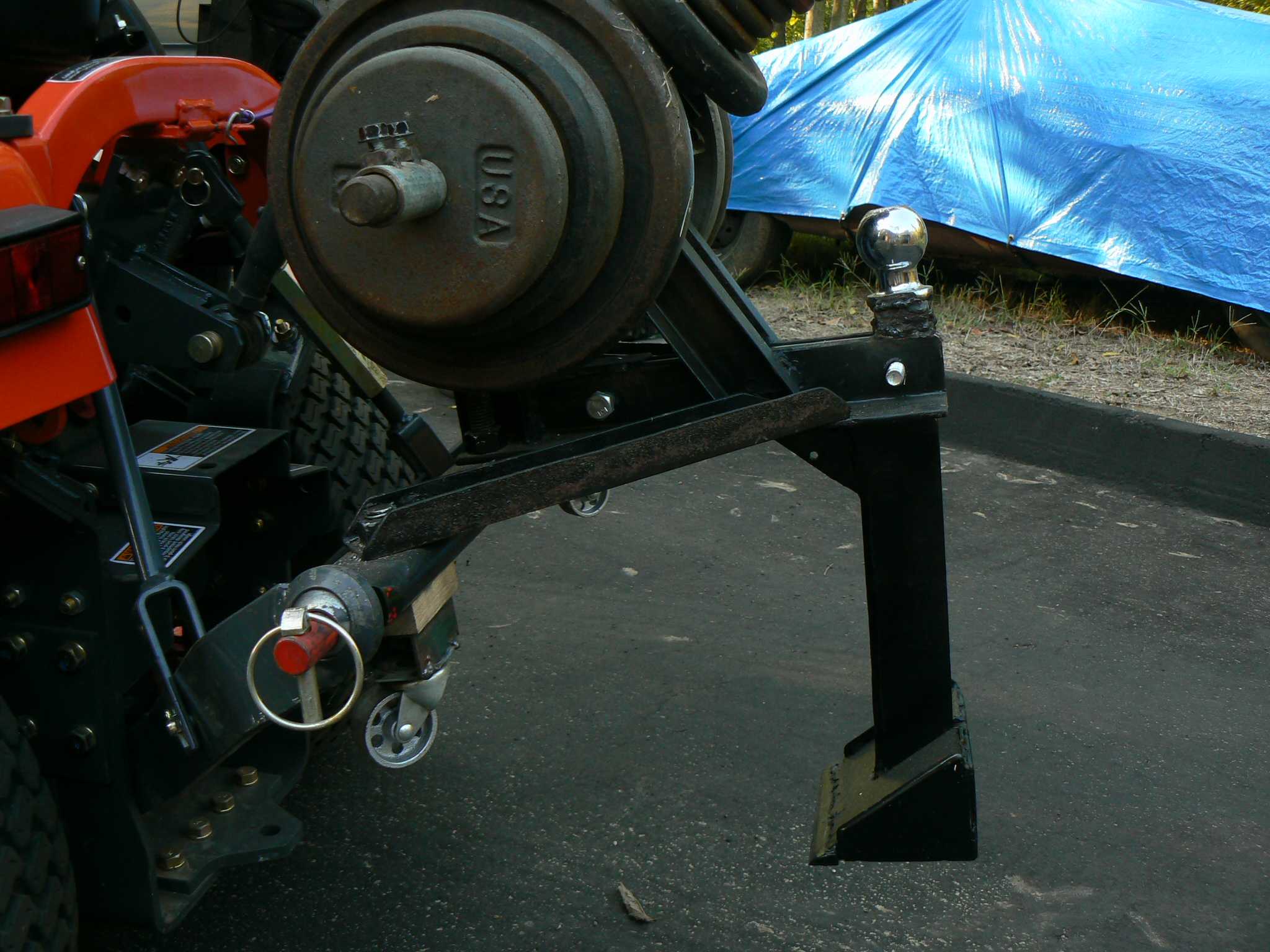

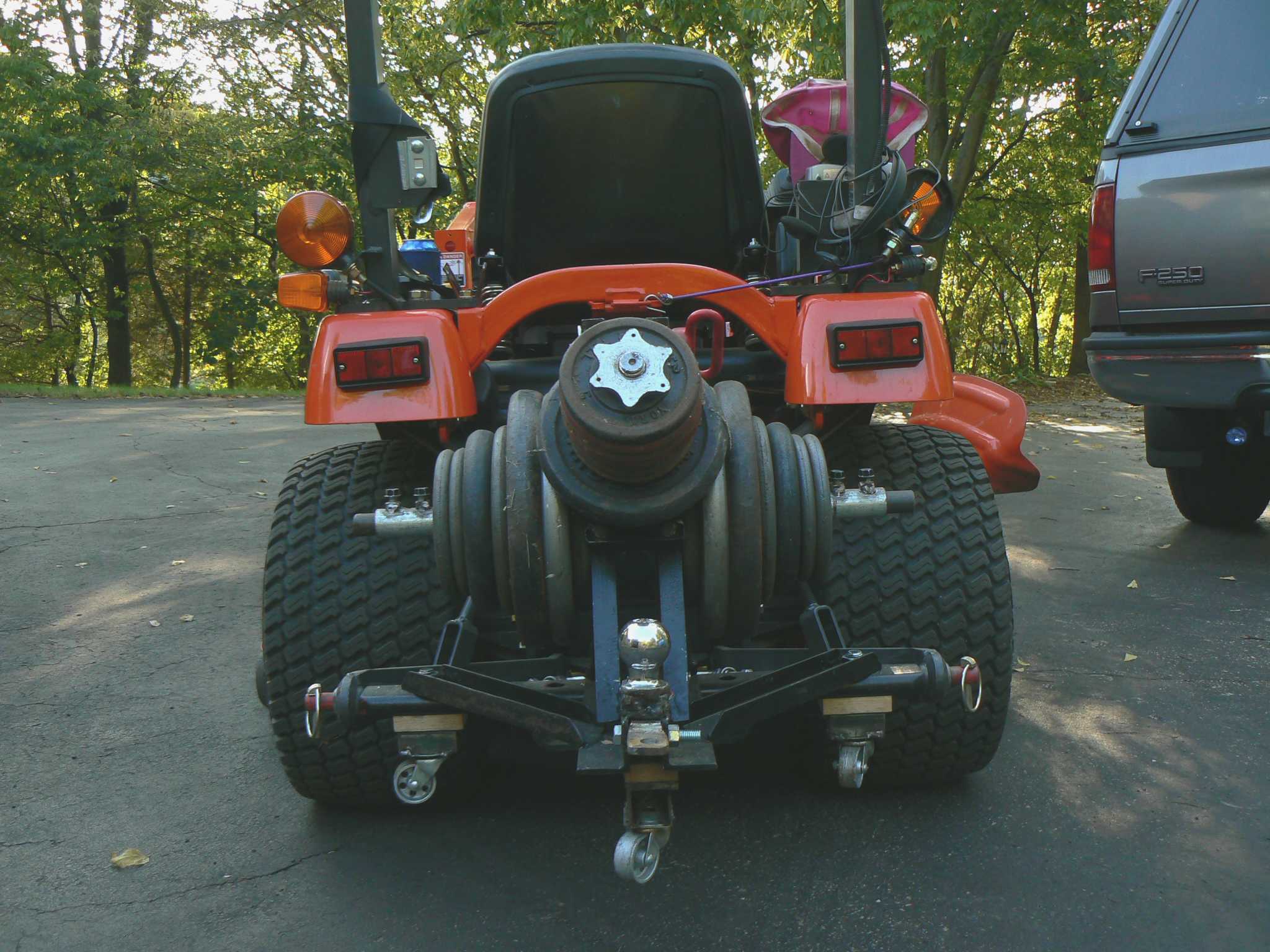

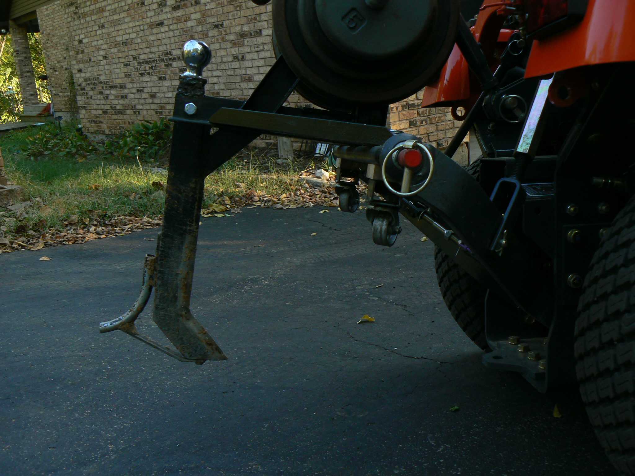

I made a couple of attachments that bolt to my weight box. One is for a narrow trench for wire, and the other is wide enough for the 4" black corrugated drain pipe.

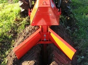

This is an option as well, I am personally looking into one of these but want to get some feedback first which I havnt gotten yet.
Quick Spade
