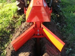

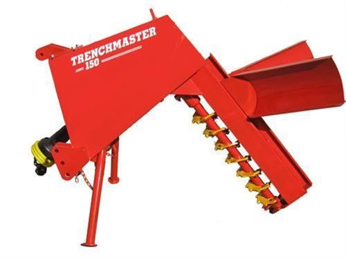

Here is just one more option. Something new in cutting trenches.

   / Small trenching with a CUT? #16
Re: Shallow trenching with a CUT?
Pretty cool. Something tells me it will cost more than a subsoiler/middlebuster though. And, the implement doesn't seem to have a mechanism to put the dirt back in the trench once you are done.
As I recall PowerTrac has a nice set of implements to dig a trench and then fill it back up efficiently.
