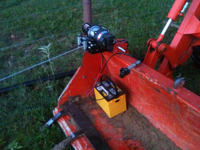

I pull my pump with this winch., that goes in a receiver on the bucket. The cable goes thru a pulley at the top of the tower. Because windmills have a sucker rod the pump is connected to 1-1/4" steel pipe, with the sucker rod inside.
A pipe elevator is a tool that clips onto the top of each pipe section to quickly grab the pipe.
In thin photo I needed to precisely tug some 2" high pressure poly pipe, so used the winch for good control.
The winch also works great to yank our shrubs around the house.

Thats pretty much what im thinking of except I want to make the reel bigger and no cable so I can run the nylon rope on it and have a ''full pull'
Just thought of maybe having an aditional two wheels together and one would have the winch wire would around it and the second wheel would have the nylon and then when the winch retrieved the cable it would turn on wheel and cause the nylon hooked one to also reel in.

Remember the reel diameter has a large effect on how much you can lift.
GOOD point..I think if i match the reel diamter to the winch size then I will be ok. not sure. I would have to see how much 140 foot of the rope takes up.

The winch allows close monitoring of rope tension. If the pump should snag on a joint the rope could break.
There are wireless remote controls available for the winches. With a remote you might be able to have the winch further away, with the cable strung out. Along the ground.
The PVC roller idea listed above is very good. Another option is a snatch block used normally to double a winches capacity, available from TSC or other places.
Remember if you use one that the loading on the pulley or roller support is the vector of the up force and the sideways force from the winch.
A winch is pretty useful. If you make one special purpose for the well it limits its use for other purposes.
