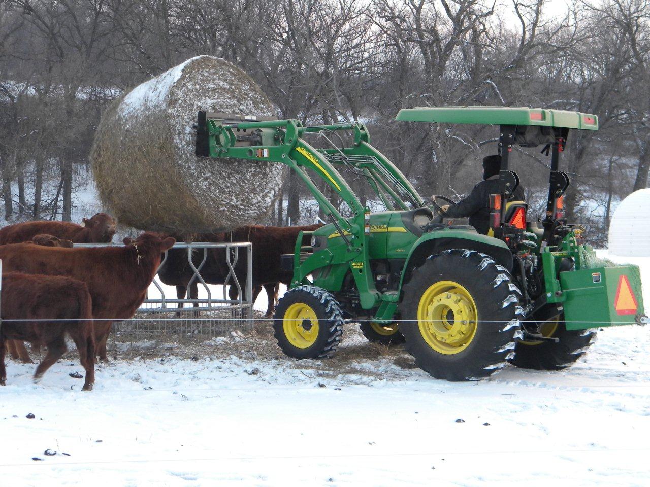

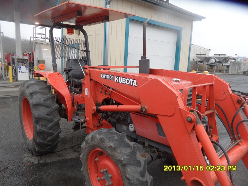

Sounds like you can actually HANDLE round bales as opposed to just LIFT them. my jd4720 does a good job of lifting them, and carrying them around...a little. I handle maybe 100 bales a year with it is all, but I like something a little bigger for safely carrying them around on uneven ground and winter conditions. How bout a picture of your Kubota?
