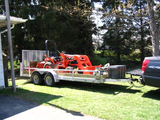

Yeah I pretty much think it is perfect now also. I made due with my 6x10, but this new one is the best. It trailers great and I must admit having the brakes gives me the piece of mind I was lacking.
I have told before of the trip I took on I95 with a trailer without brakes and am still amazed I survived without any real damage to myself, my equipment or anyone else. It was a ride I never want to repeat and with the new trailer and brakes I don't expect to.
Here is a picture of my setup now that I have my tool box on front and side boards added. This was the maiden voyage in May to my Lake property so it's loaded up with some other junk also.

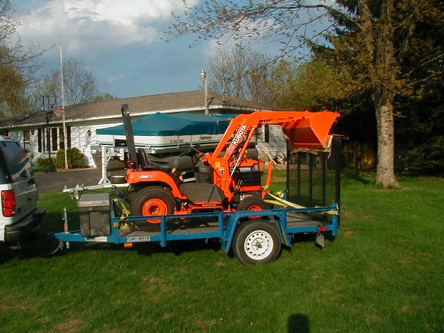

   / Smallest trailer for hauling a BX1500??? #7
Just for reference here is an older photo of my 6x10. You will notice I had to rest the loader on the gate to make it fit as well as get the load at the right proportion to trailer properly.
The BX without the loader trailered pretty well, but still doesn't give you a lot of room for movement to adjust for adding other things to your load.
