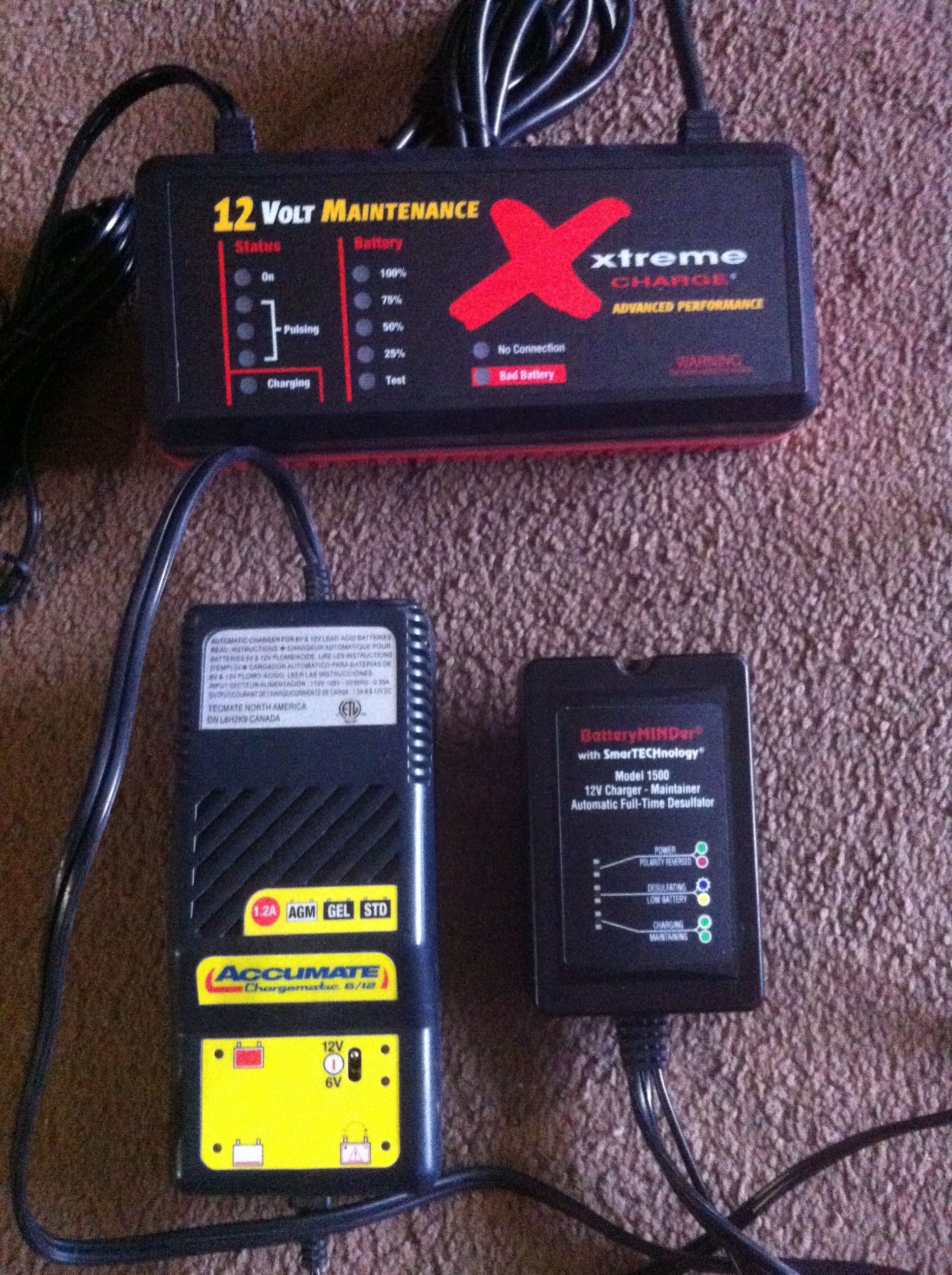

I do have another to recommend besides my B-M 1500s (3 ;)). I didn't believer these were still available, as they're the older iron core powered type and strangely don't mention reconditioning structure/system, but they seem to have recovered batteries (5 YO in ZTR) that were thought hopeless. There may be a healthy pulse to one stage that isn't touted because after a few years use I wouldn't be surprised. Accumate 6v/12v is the first of many I bought and stays the busiest of five.
https://www.amazon.com/AccuMate-TM-08-ChargeMatic-Battery-charger-maintainer/dp/B0001V0A94
https://www.amazon.com/s?k=accumate...x=accumate,automotive,159&ref=nb_sb_ss_fb_1_8
Said to be fragile, far from water resistant but, with daily restarts, we've brought back some real dogs within a week's time. I was searching for 'the best' years ago and stumbled onto this (still 6v, too :thumbsup:) on tips from more than one Gold Wing club and a handful of other British riders. I like the fuse and cap on the eyeleted pigtail. Buy Shumacher for either in pairs on ebay or Amazon, very econo to buy, same quality/polarity as all but one brand of charger (reviews complain loudly about that one).
One of the reviewers uses if on a Model A with 6 volts...
   / Smart battery chargers with reconditioning modes #232
Lucas...... Prince of Darkness........ Lucas..... Turning Ordinary Men into Electricians........ If the Brits like 'em :thumbsup: ...
Lucas ... I drove Triumphs while at Fort Devens in '70, parked a '64 TR4 in NH and left there in a sun-faded '62 TR3 (with a fresh valve grind and a new timing set) that just purred like a new car. I might to this day trade my ('pickled') '80 L82 Vette w/32k MI for a decent TR6 in similar shape with < 80k mi on it. (I know what risks I'd take at the Prince's beckon.) btw, for each its own reason, I push started both TRs for all but a week or so of either's term of operation. (Y'learn to park. ;))
This link (for now) should be to Tecmate's other, newer line that didn't turn up in my hasty search earlier. 'Optimate' ($$:eek:) vs my earlier 'Accumate' ( ~$50 and 5 star, IMO) Robot Check
"Pulsetec Xtreme XC100-P" is another one I like after using for a few years, 3a+ and I've learned that after topping up and an 'overnight soak' I can somewhat gauge a battery's o'all condition by what % it shows at next day's hookup, and how long it takes to work up to "100%" showing by which LED/time. Old pic here, these vetted for years, no regrets.
