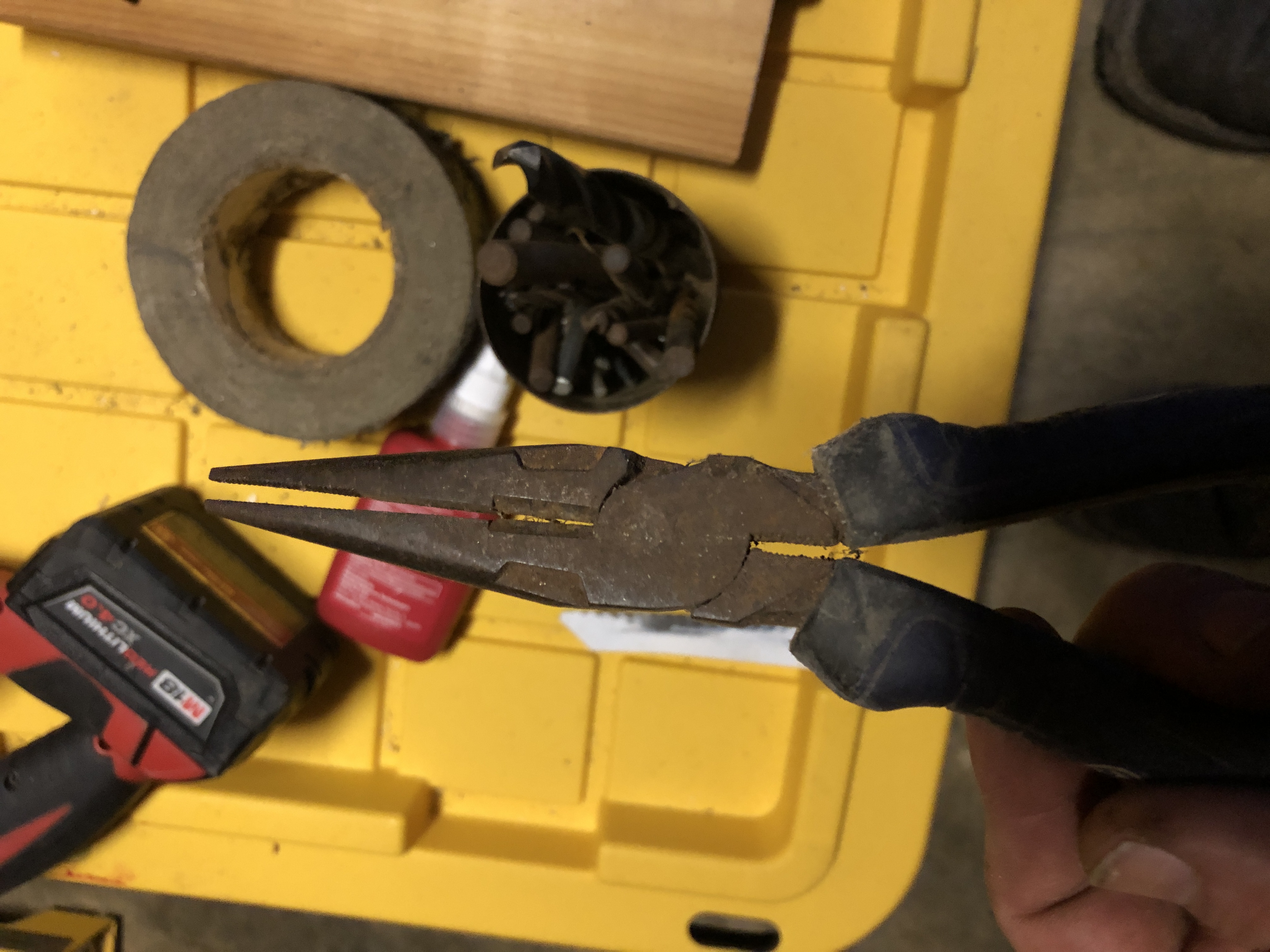

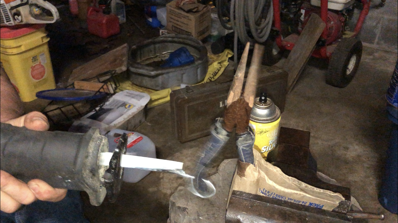

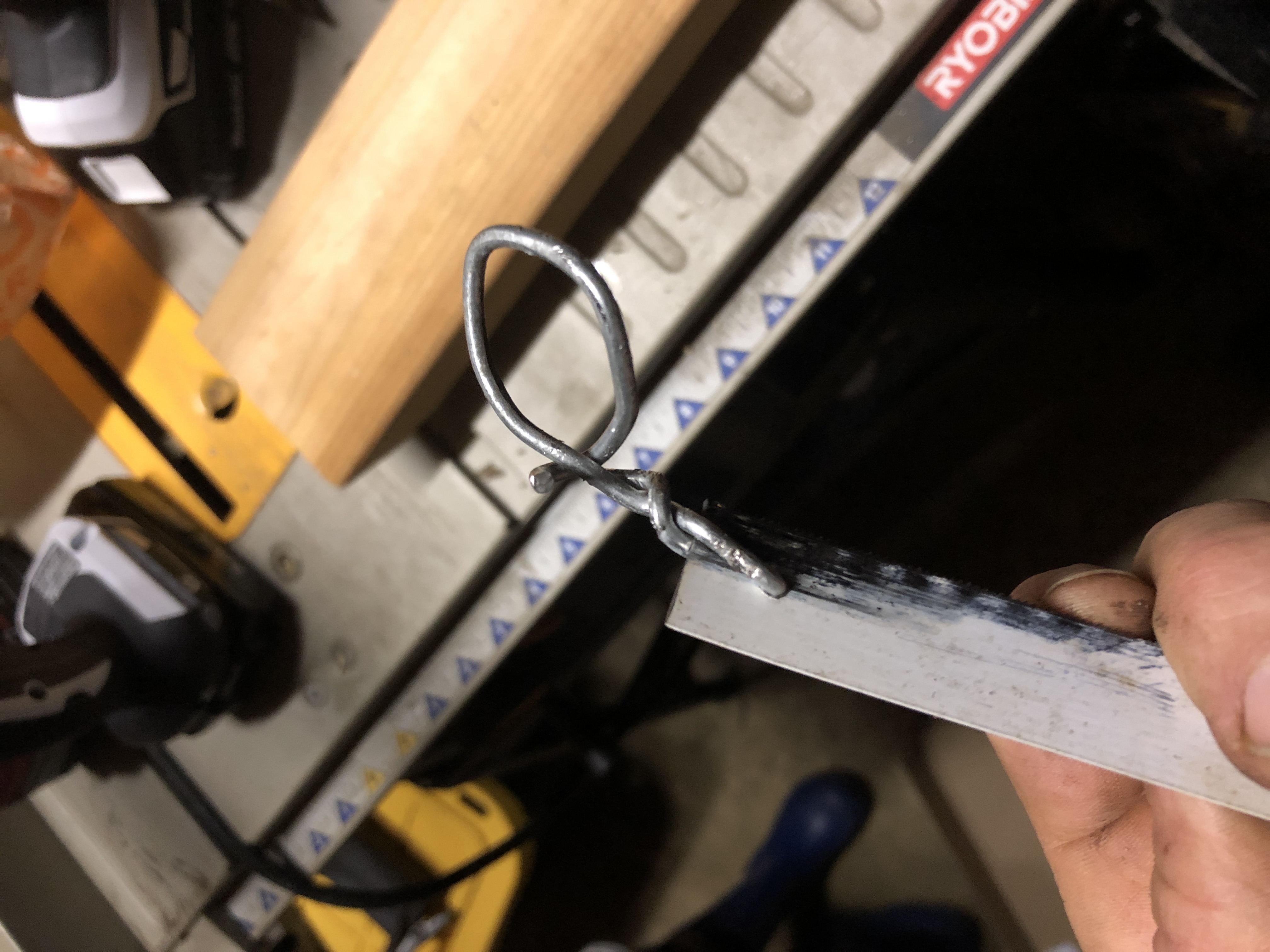

When you’ve got those pliers/side cutters/fence tools/etc that won’t fall open or open as easily as you want find an old sawzall blade, cut it off at about 3” long, drill a hole and make a solid loop of wire. Chuck up one handle of the tool in a vice, apply a generous amount of lube, loop the loop of wire around the other handle (tape or otherwise protect the handle), attach sawzall, run for about five minutes. Works like a champ.

Pretty clever. I like it.
