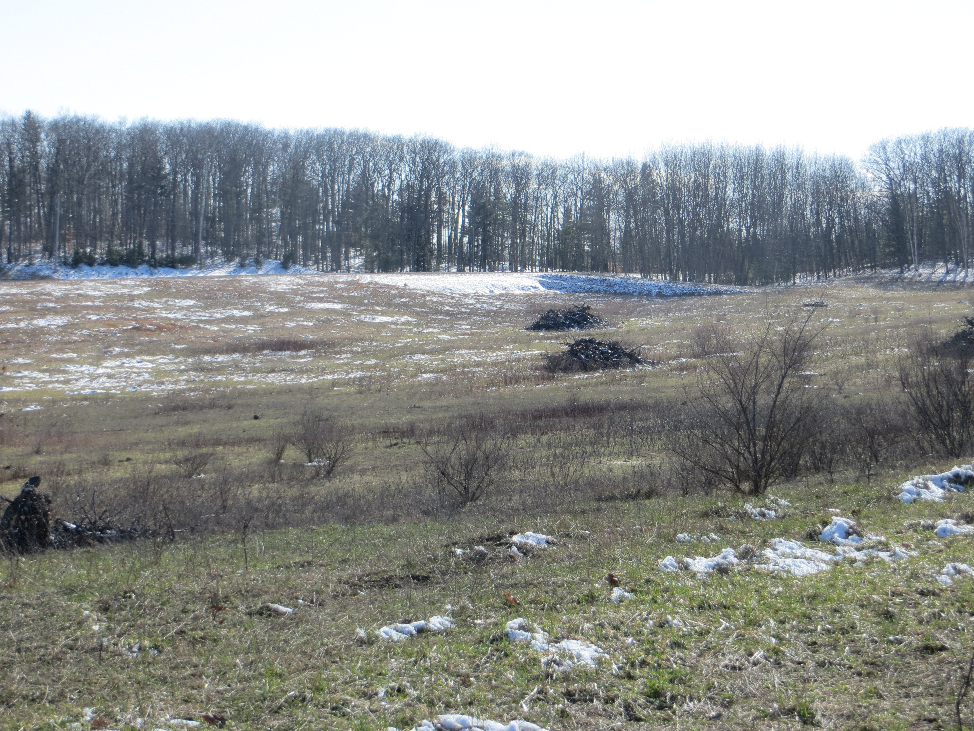

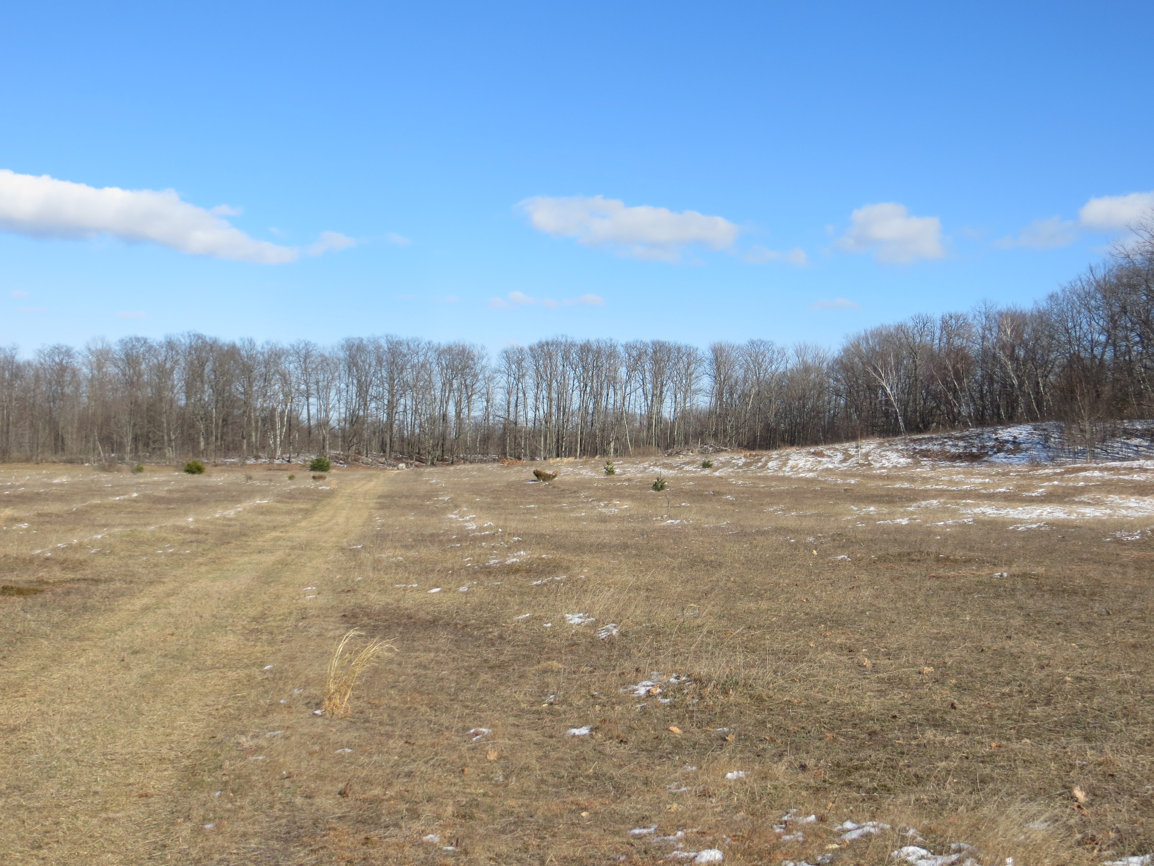

I recently acquired 50 acres of abandoned cherry and apple orchard that has had the trees removed. The south field is part flat, but has some rolling hills on it. The north field is much flatter overall but also has some hills.
Years of driving the tractor\discing between the rows by the previous owner and the subsequent removal of the trees has created ridges (and some root ball craters) where the trees were; and flat travel paths between. The elevation change is as much as 2'+ in spots between the ridge and the flat. I am trying to figure out the best way to flatten the fields in keeping with the natural contours. In other words, smooth out the ridges.

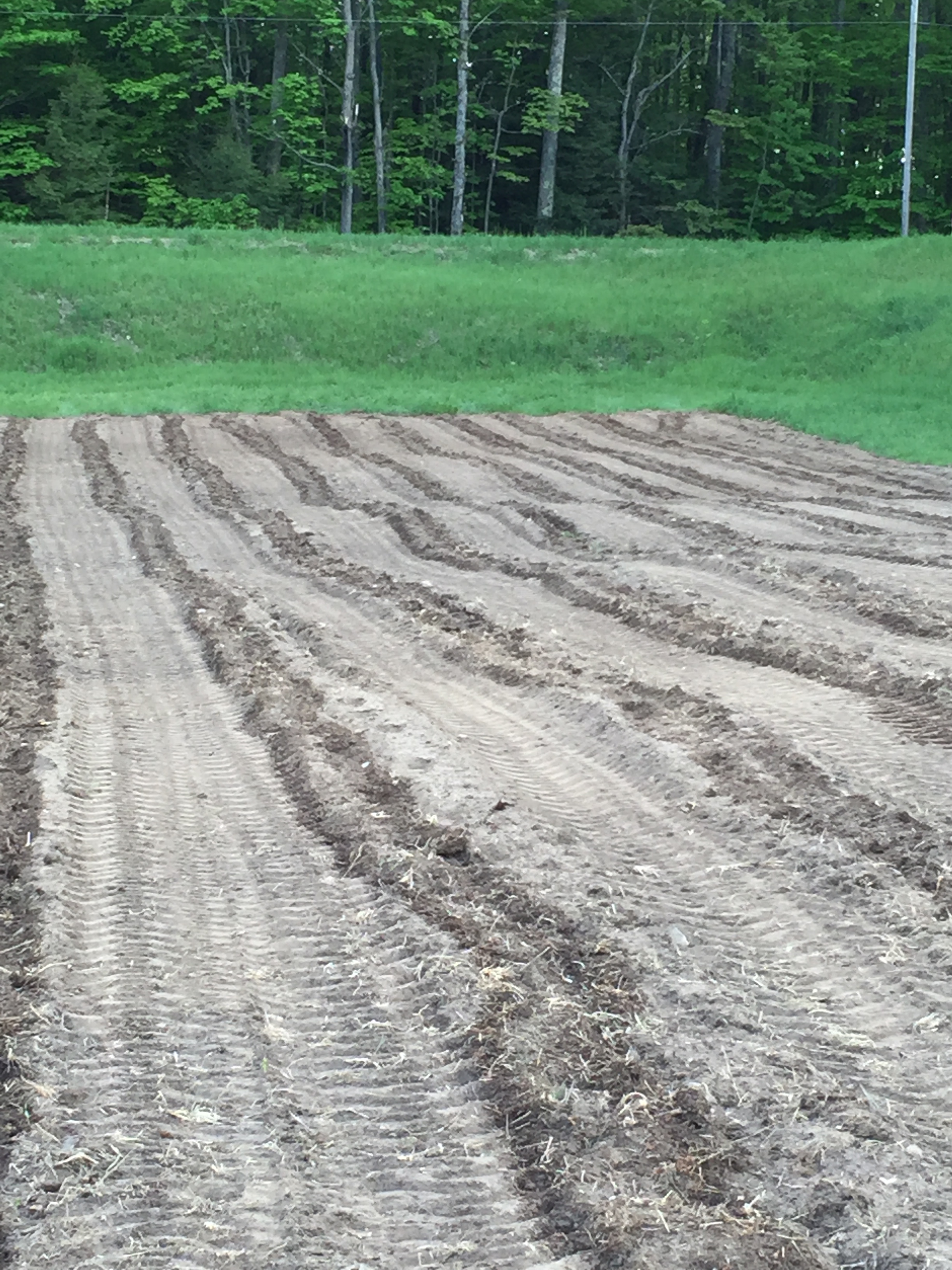

I have attached photos of a 1 acre test area that I was trying to level. Not much success. I rototilled it several times in different directions. It filled in the holes but didn't help the ridges much. It isn't level but I went ahead and planted it because the sweet corn needed to go in.
My next test area (still in progress) is to aggressively disc it several in several directions and then lightly rototill.
I am afraid that I simply don't have the right equipment (or big enough equipment); and \or the right approach to do the job.
Suggestions?

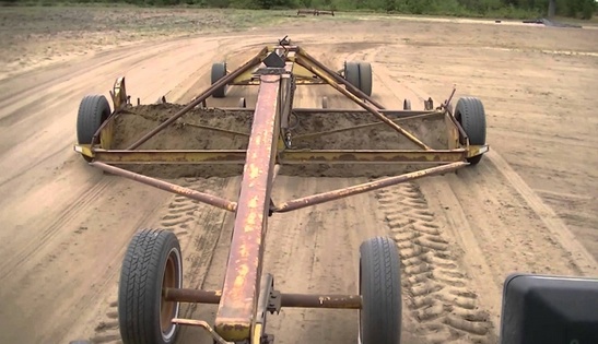

I would never even consider a conventional box blade for 50 acres of ridges. I've spent many years working on flood-irrigated land that needed flattening for each crop change.

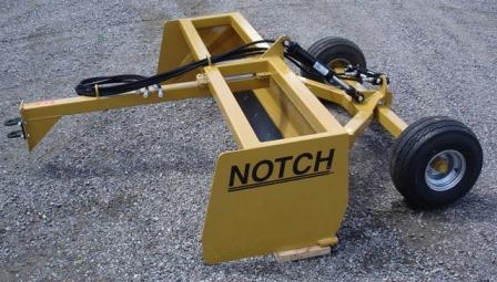

A common choice now is the laser-guided wheeled box blade. But the laser guide isn't needed if you aren't flood irrigating and just want to smooth the land.
Disc it first so you don't have to cut solid packed ground.
First choice would be something long, with a center blade.
Second choice would be a tongue-pulled wheeled scraper or box blade.

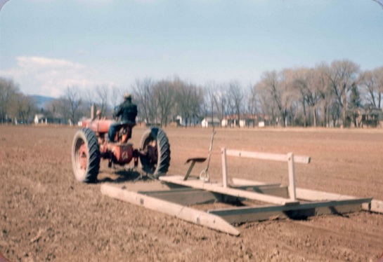

If I couldn't get those, I'd build a wooden or steel float like this.
