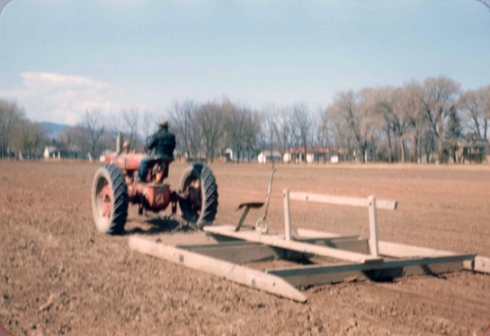

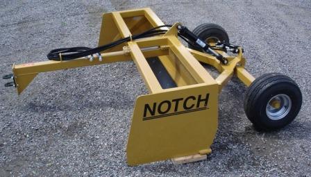

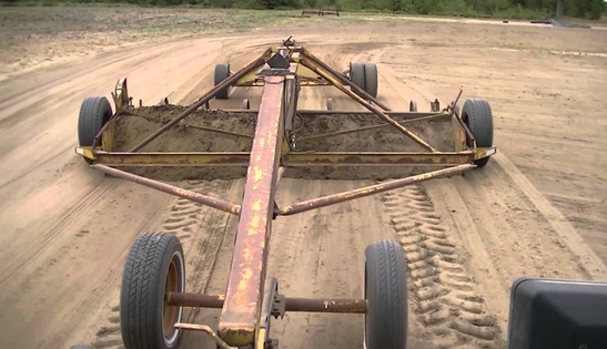

I would never even consider a conventional box blade for 50 acres of ridges. I've spent many years working on flood-irrigated land that needed flattening for each crop change.
A common choice now is the laser-guided wheeled box blade. But the laser guide isn't needed if you aren't flood irrigating and just want to smooth the land.
First choice would be something long, with a center blade.
Second choice would be a tongue-pulled wheeled scraper or box blade.
If I couldn't get those, I'd build a wooden or steel float like this.
Bruce
Disc it first so you don't have to cut solid packed ground.
Bruce
Thar last one looks like something I could build. Kind of a jury-rigged land plane. Hmmm.

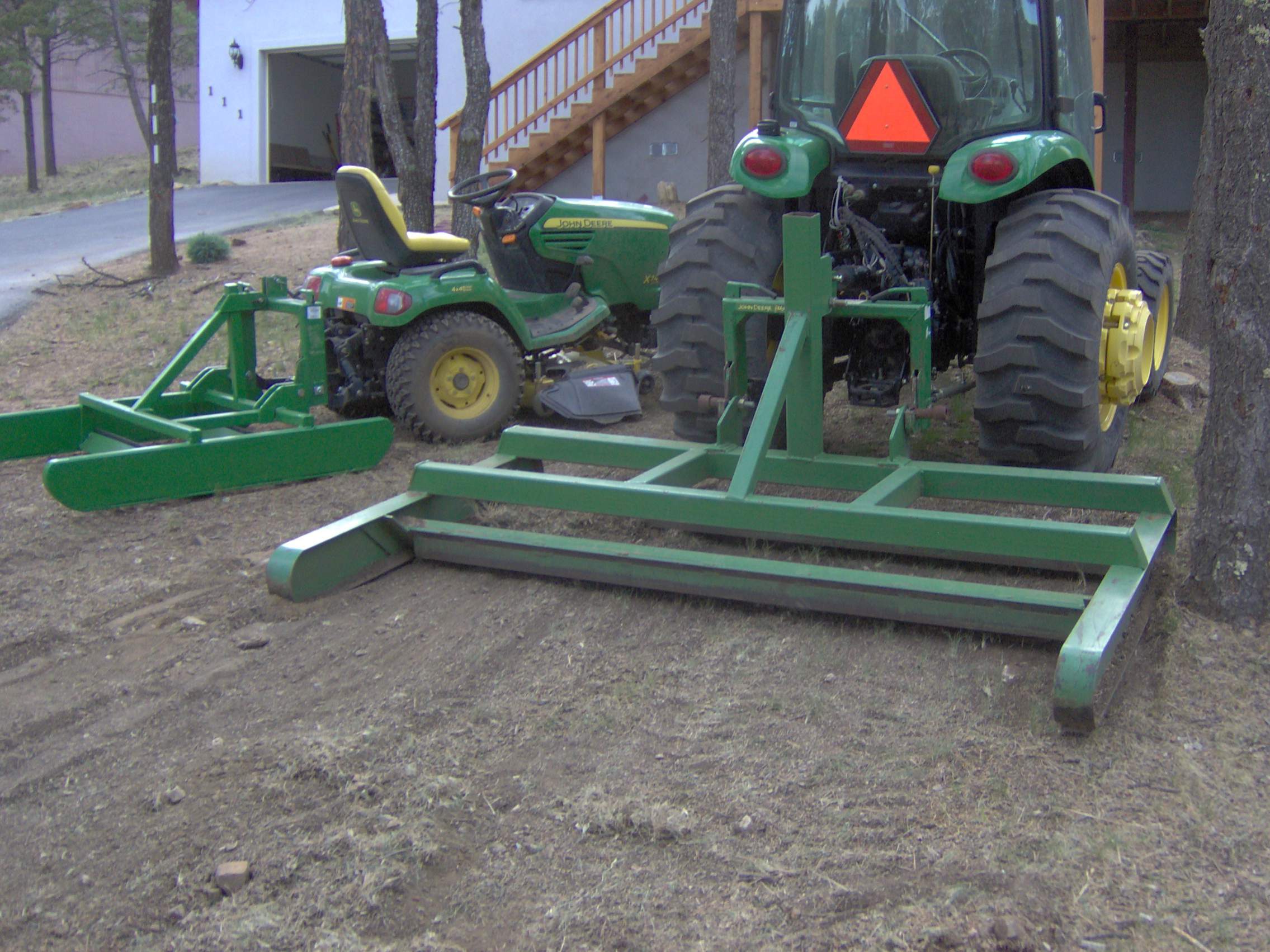

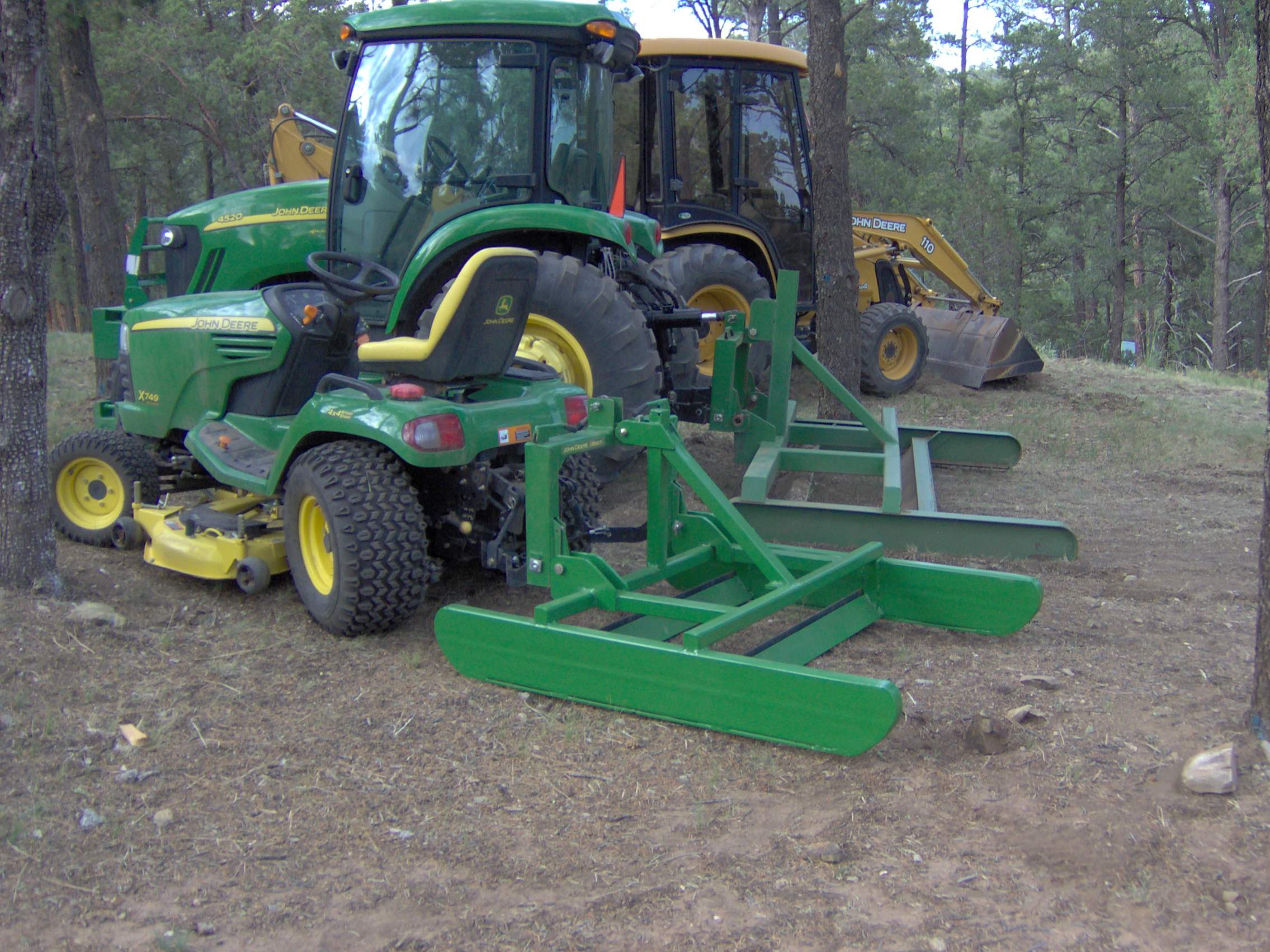

lpgs is land plane grader scraper

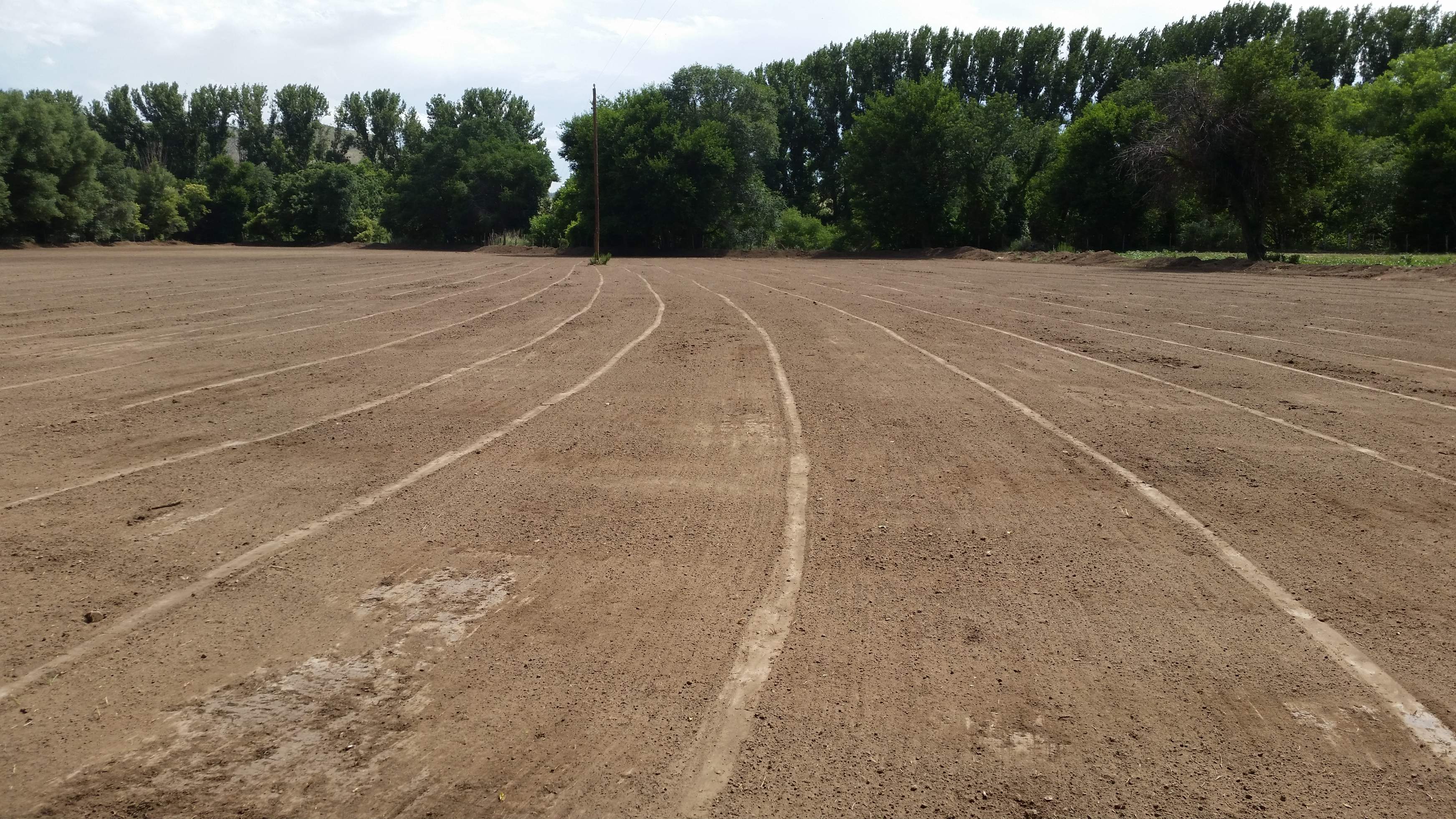

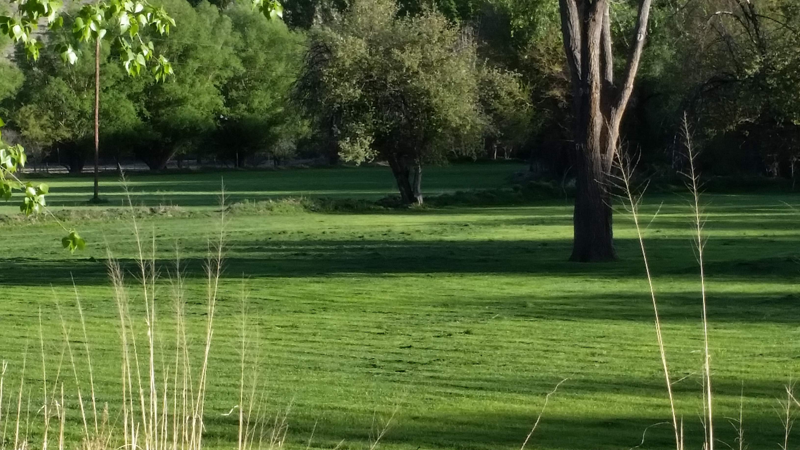

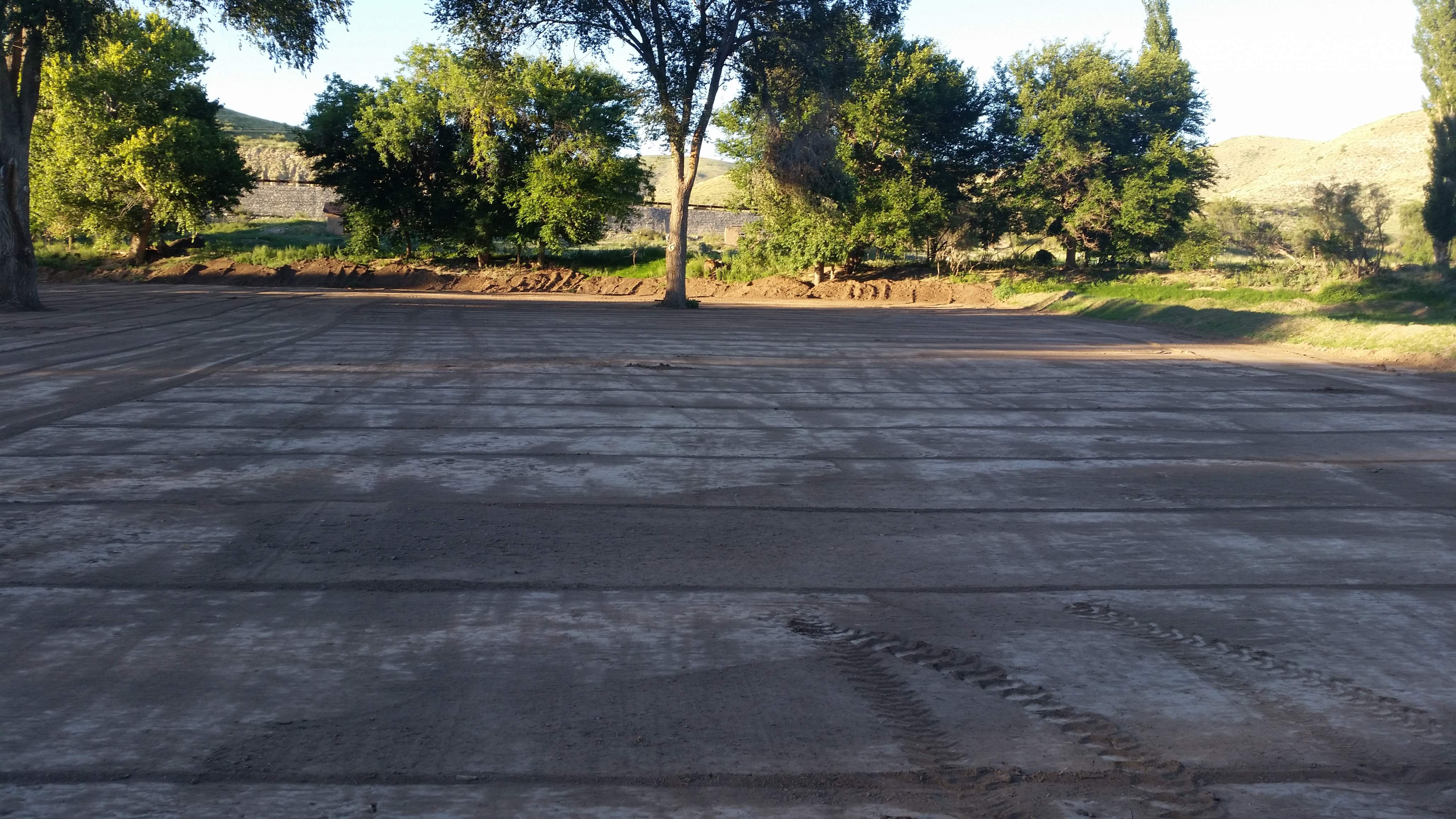

pictures of two I made and a picture of a field after using the larger one.
   / Smoothing a an Old Orchard Site #20
I should add that the above picture and this one were old apple orchards when I started working them over. The field pictured below is after box blading to grade for flood irrigation. One side of the field was cut down about 2 feet to achieve this.
