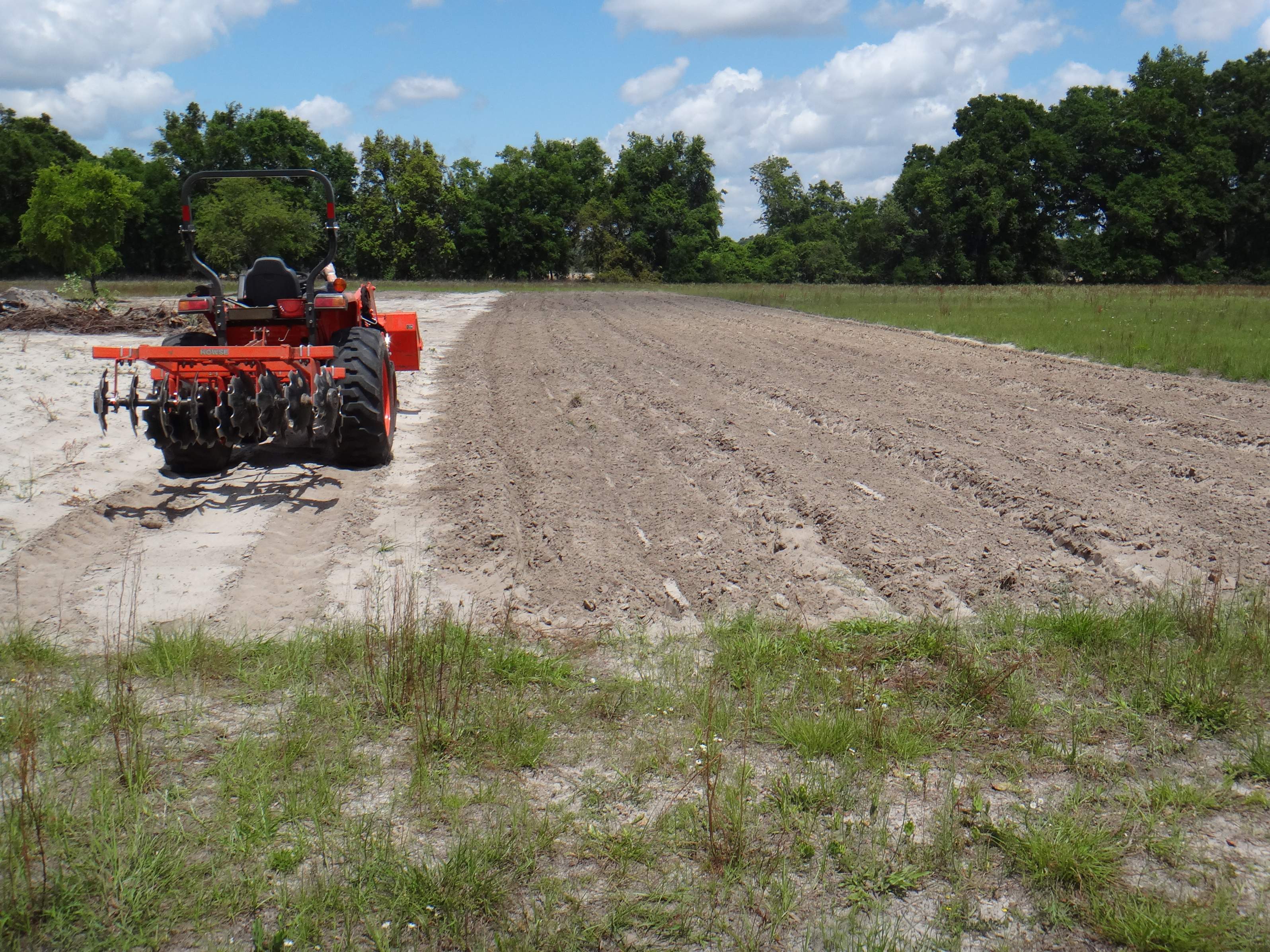

More weight on front disc gangs throws dirt OUT. Use on ridges. PHOTO
