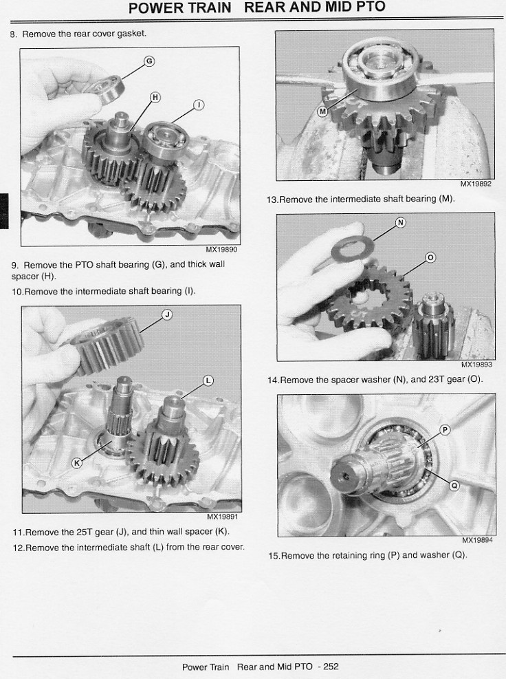

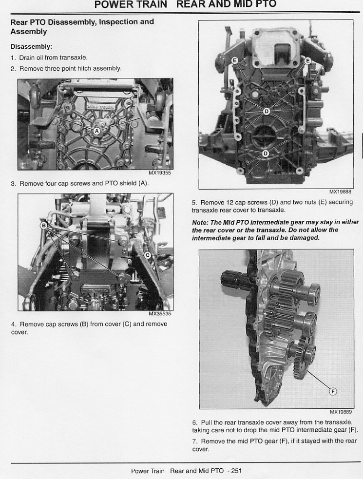

I was tilling my garden and after the loud bang I got off my tractor looked at the rear PTO only to see the fluid pouring out where the shaft had snapped off. I am a little nauseous. Can one replace the shaft by yourself and how much will a new shaft cost?
   / snapped the rear pto on my JD 2305 #2
HI, where you live?
You are likely going to need to tear down the majority of the rear end to get to where the shaft is keyed, clipped or pinned in.
Likely a good amount of work.
Did your slip clutch fail?
Hopefully nothing else got munched up.
I'd not operate the machine until you sort it out.

Hope this helps.
