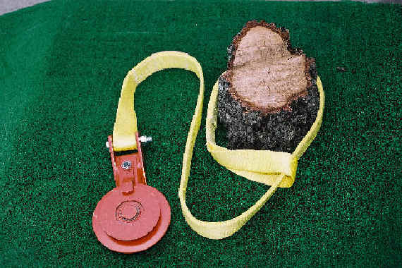

I use a Farmi (Valby) snatch block and love it. It is ver eavy duty, set up with a nylon loop to go around a tree and it is self releasing, meaning that when the tree you are pulling hits the snatch block it releases the cable and you continue pulling the tree in directly. Light weight snatch blocks are a good way to get hurt. Farmi Snatch Block

I have used a fairly cheap JET block similar to this snatch block for occasional use for ten years in the woods. I have had to rebuild it several times because the frame has been torqued...it is no twelve ton unit! but it has certainly saved the day numerous times /forums/images/graemlins/grin.gif
While the self-releasing feature isn't what you need for your scenario you might consider something like this: self releasing . My brother has one similar to this and it is very nice. Because it is built to be supported only on one side it is fairly rugged.
