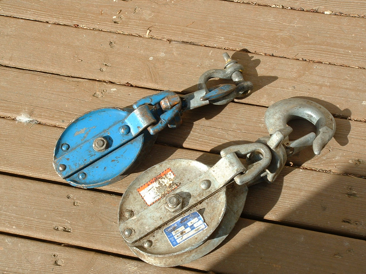

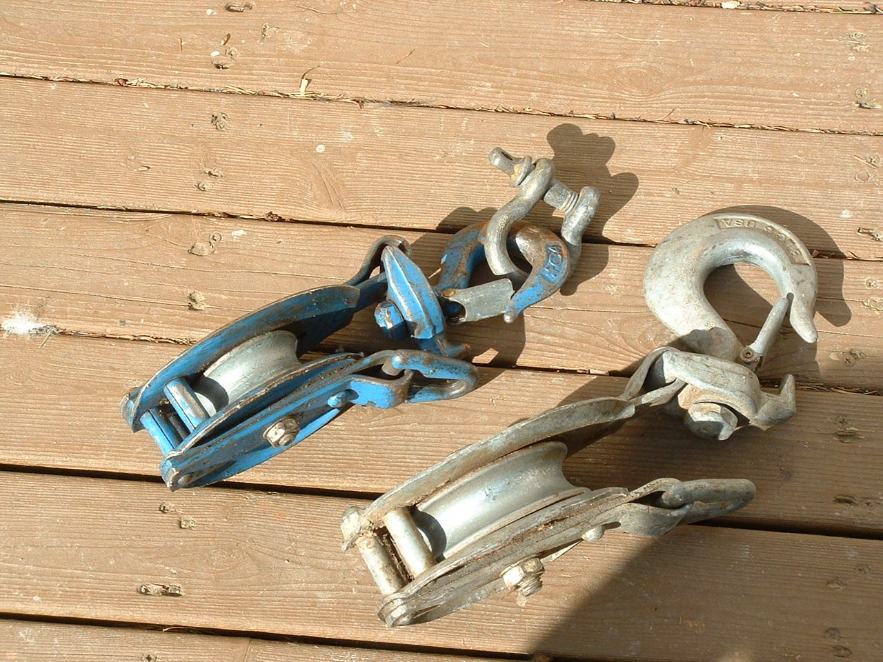

Yeah those tongs and rope choker would be sweet to have. I haven't used that rope choker. Usually I use nylon towing straps if I need or regular chains. Depends on if I were skidding logs across pavement or not. The guys on here have me thinking that a cut down car hood or a wooden piece of plywood to help skid stuff. Another good thing to own is a log arch. That way you can lift the front end up and have less digging in and friction.
The CMI pulleys on there are rated at about 11,000lbs. You might try Wespurs Arborist Rigging Blocks and Pulleys at WesSpur Tree Equipment
The big snatch blocks that I have now I picked up at garage sales for $20 each. The blue one is rated at 24,000 or 2400 lb working load and the grey one is rated at 48,000 lbs or 4800 working load.
