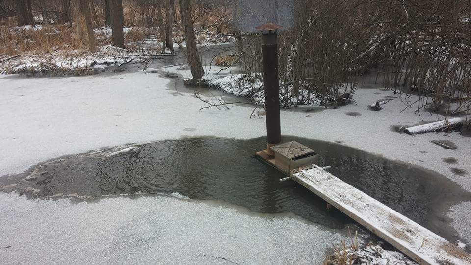

We used to keep the pond open all winter when we had ducks and geese. Just an air line from the shop regulated to about 10 lbs or less and an air stone in the bottom of the pond and there was open water all winter. I like your idea but I would get tired of keeping the wood stove fired up.

I tried the compressed air, using a pipe with holes drilled in it, a few years ago. It kept a hole open but not large enough for the ducks. I thought about getting an air stone but didn't want to spend money, if it wasn't going to work. I tried running the heater all winter a few years ago but it wore me out and ate up too much wood. Now I just use it to open the pond early. Without it, the pond takes a long time to thaw out once the weather starts warming up. I have a pump circulating water by it and once the air temperature is above freezing during the day it seems to keep the ice from forming, once the heater has done it's job.

Ok I see what your doing. Makes sense.
