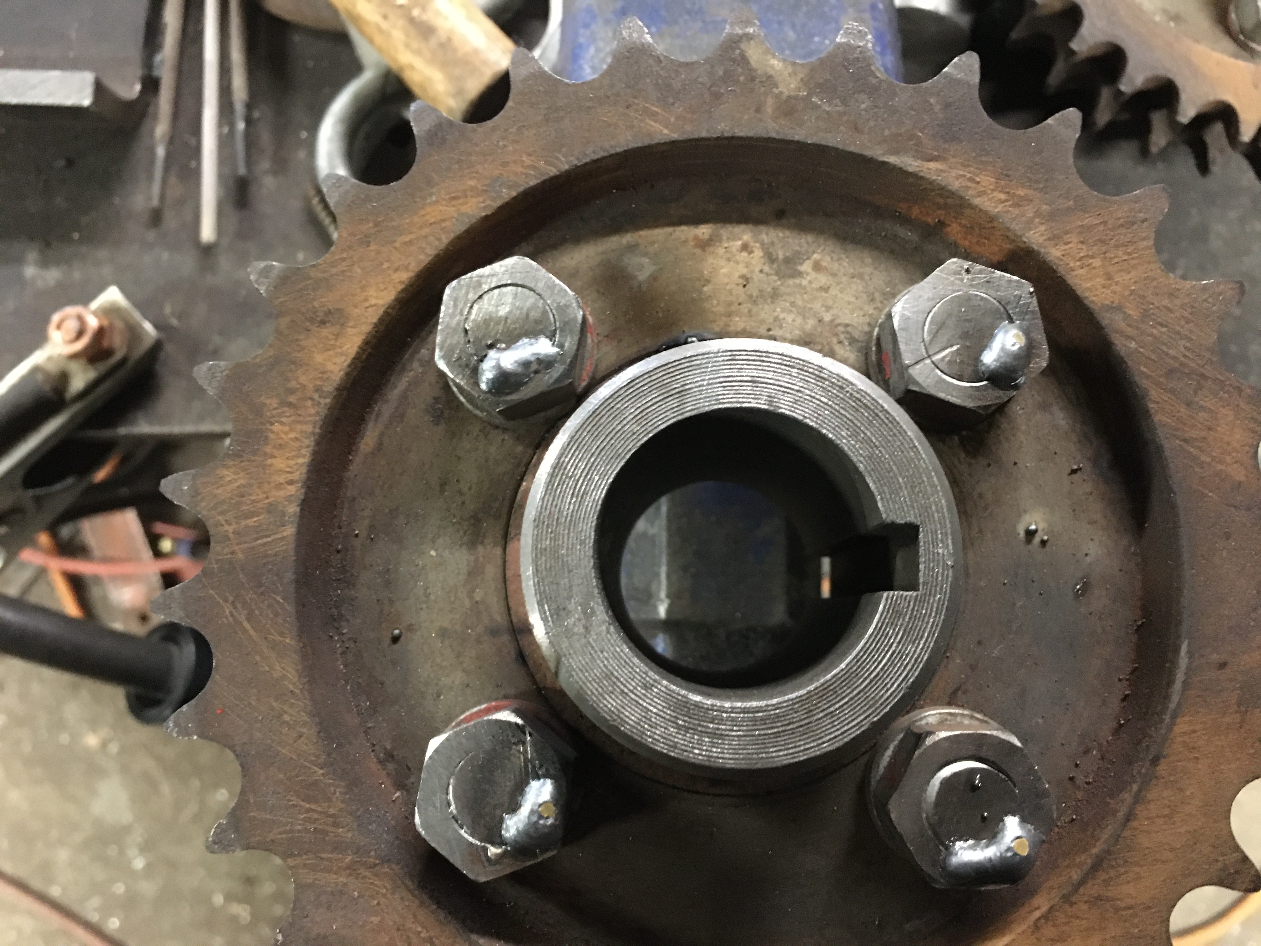

According to my handy pocket ref book, weight is just over 4 lbs per ft. The shaft is 9 ft long. Spins with finger pressure with six bearings installed.

Crunch time, starting final assembly. A little dab of Lincoln Hot-loque on the critical sprocket bolts. 1E1288FD-2DC8-44D1-A47F-CFD4CA2F63D0.jpeg

Crunch time, starting final assembly. A little dab of Lincoln Hot-loque on the critical sprocket bolts. View attachment 674931
Oh Boy, Oh Boy, can't wait.
Wasn't sure what this "Lincoln Hot-loque" stuff was until I looked closer at the pic. Thinking it was some sort of new lock tite brand but this looks to be next level stuff, lol.
   / Snow痴 coming
#55
Resists vibration better than any other. Does require a bit extra effort to remove though.
