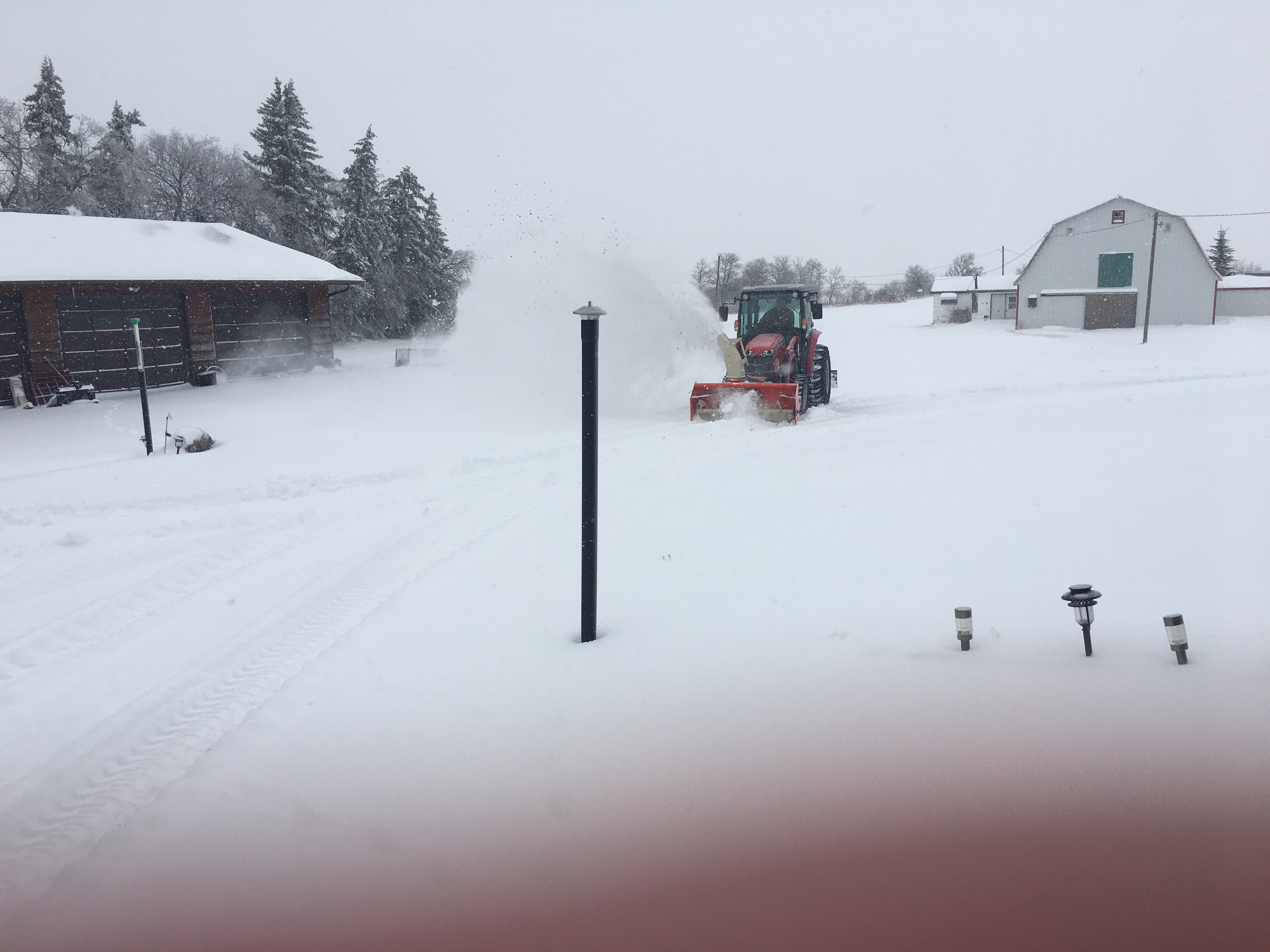

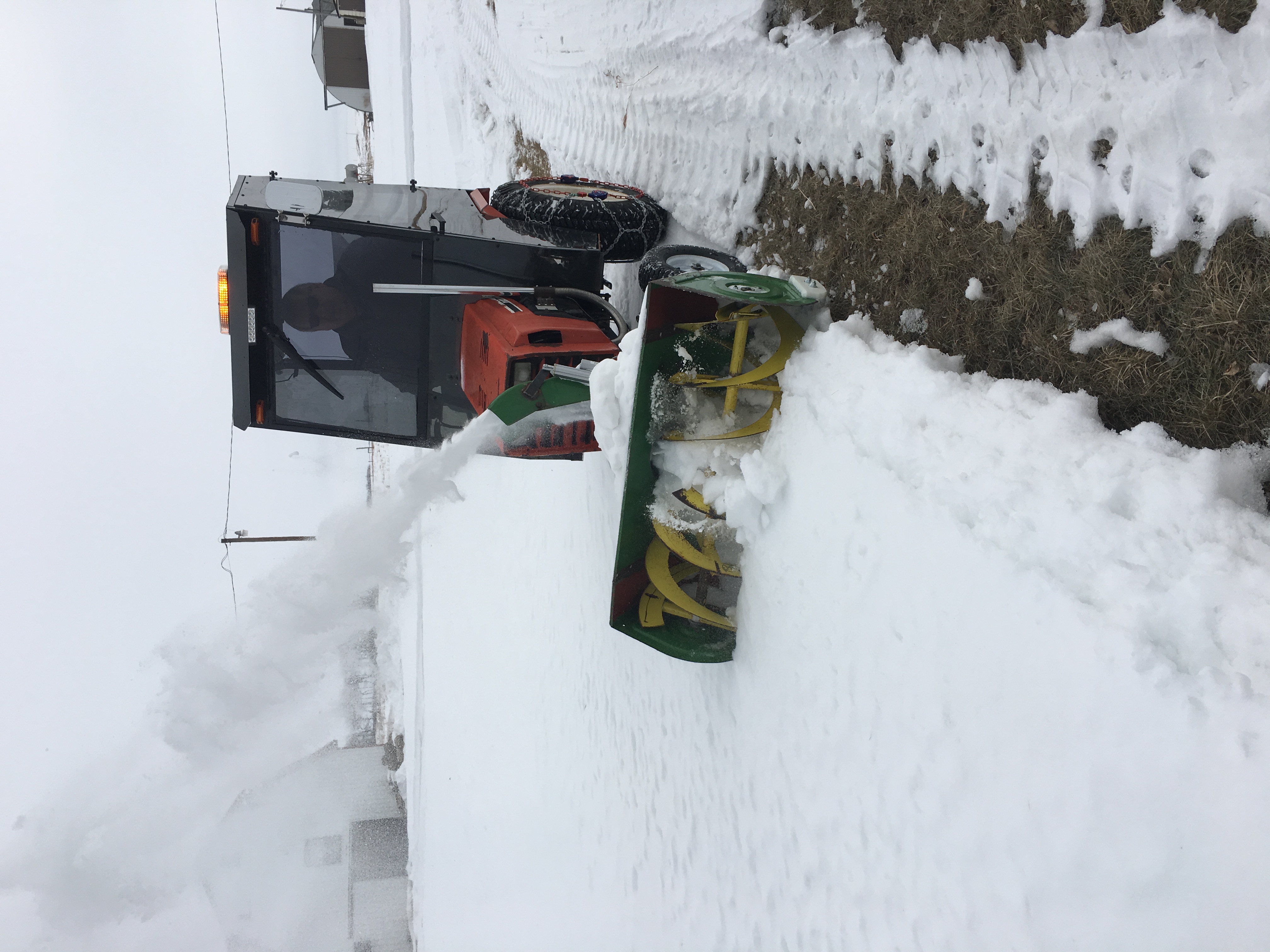

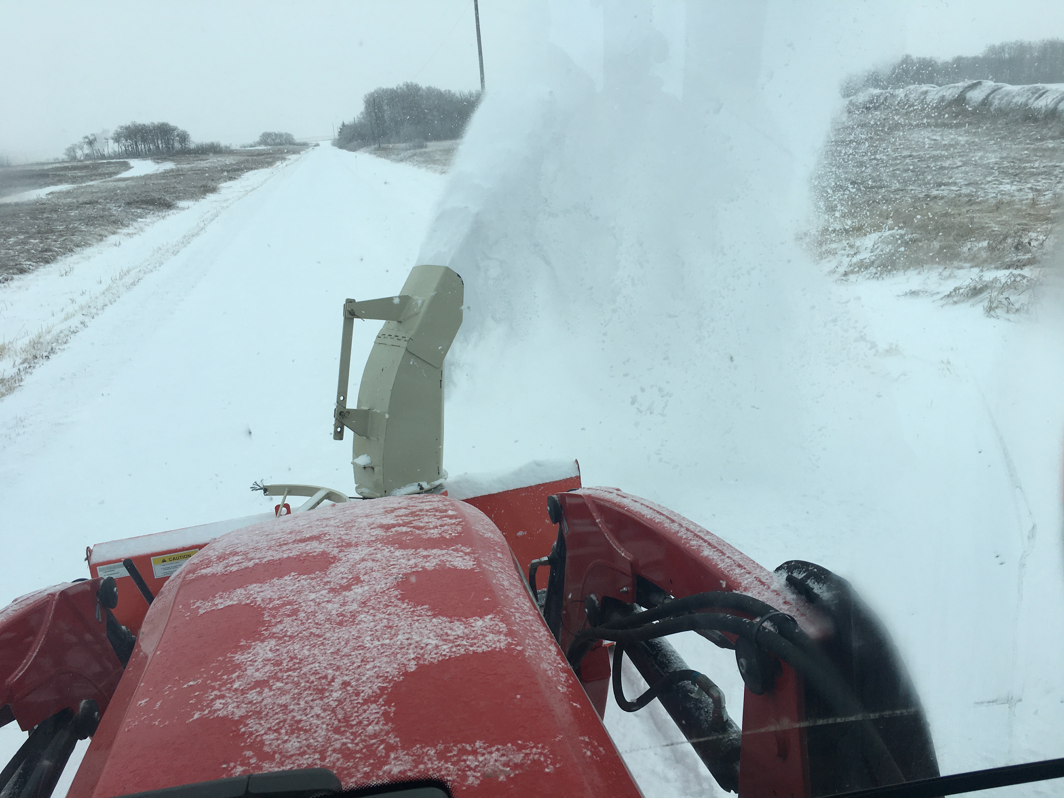

Well the snow fell and lots was blown away. Just enough to give the blower a little test. All went well till the pto shaft came off the tractor end. The grooves for the balls were a tad shallow so it didn稚 click solid. My fault for not paying attention. A little angle grinding and we are happy. Lady took a couple pics, I took a few from the cab. 7DA89108-8E2C-4A8F-9E6F-841062EDA19A.jpegA200FF3E-4B99-4A72-86E6-99345AEA2716.jpeg
   / Snow痴 coming #87
I would say that you have created a WINNER. The very best of all worlds. It works, you are in a heated cab, you are driving forward. I'd be listening to my happy song on the radio. Congratulations ...........
   / Snow痴 coming #88
Congratulations on a very successful build. :thumbsup: Very impressive!!
I bet you like driving forwards way better than going backwards.
Have you discovered anything that you think you might change to make it better or is it doing everything you hoped for and don't see any need for changes?
   / Snow痴 coming
#89
Thanks, pretty satisfied with the results. Even though this blower is only 66 inches as compared the my other one at 84, it moves a lot of snow. An electric actuator on the chute will make for better directional control in the wind. The rear blade for back dragging is not near as handy as the seven ft hydraulic that I used on the front. May have to look at extending the right end and adding a control cyl. Saw an inverted on the tube that had a drop down blade for back drag close to buildings. Sittin and thinkin time.
