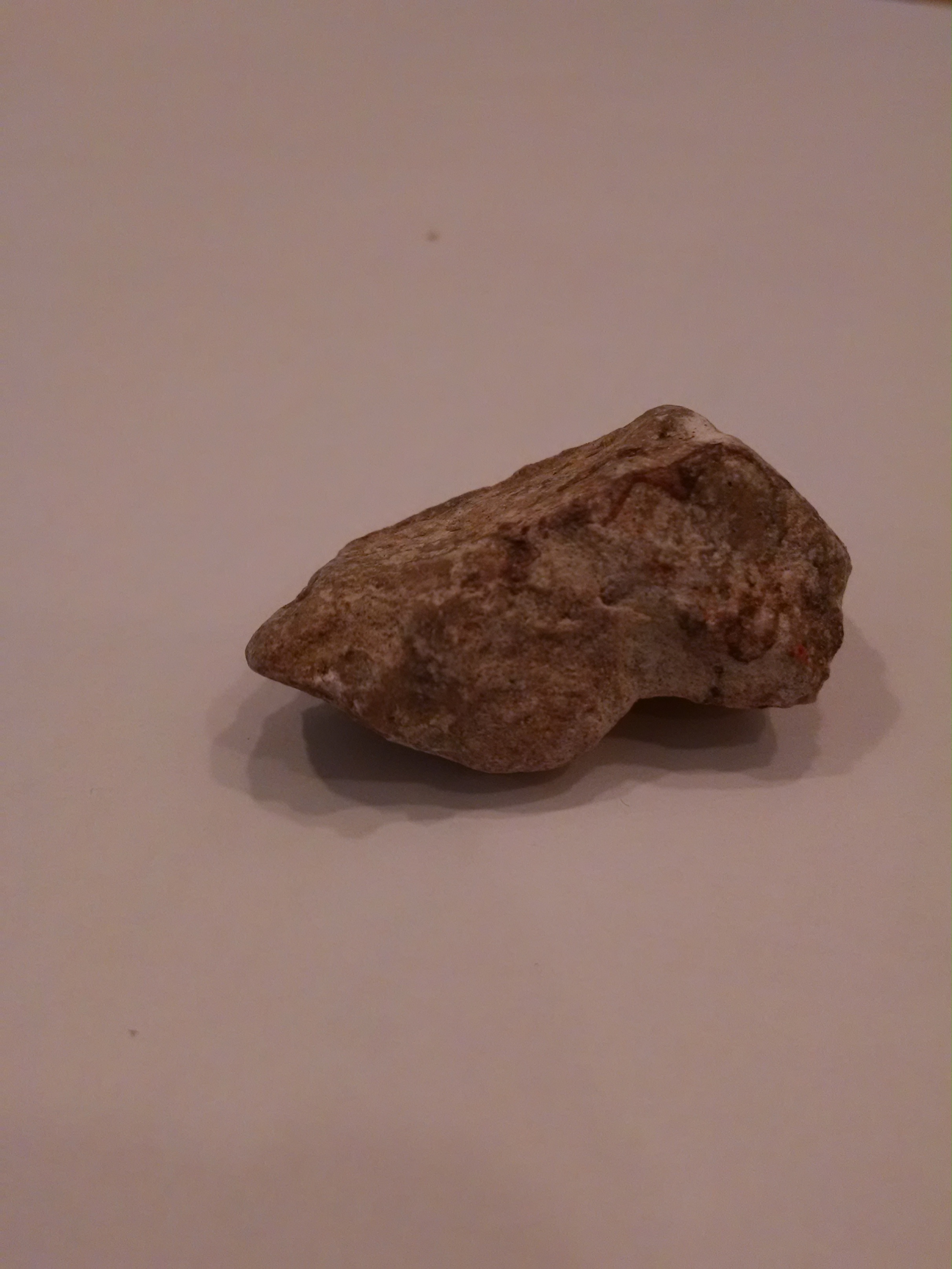

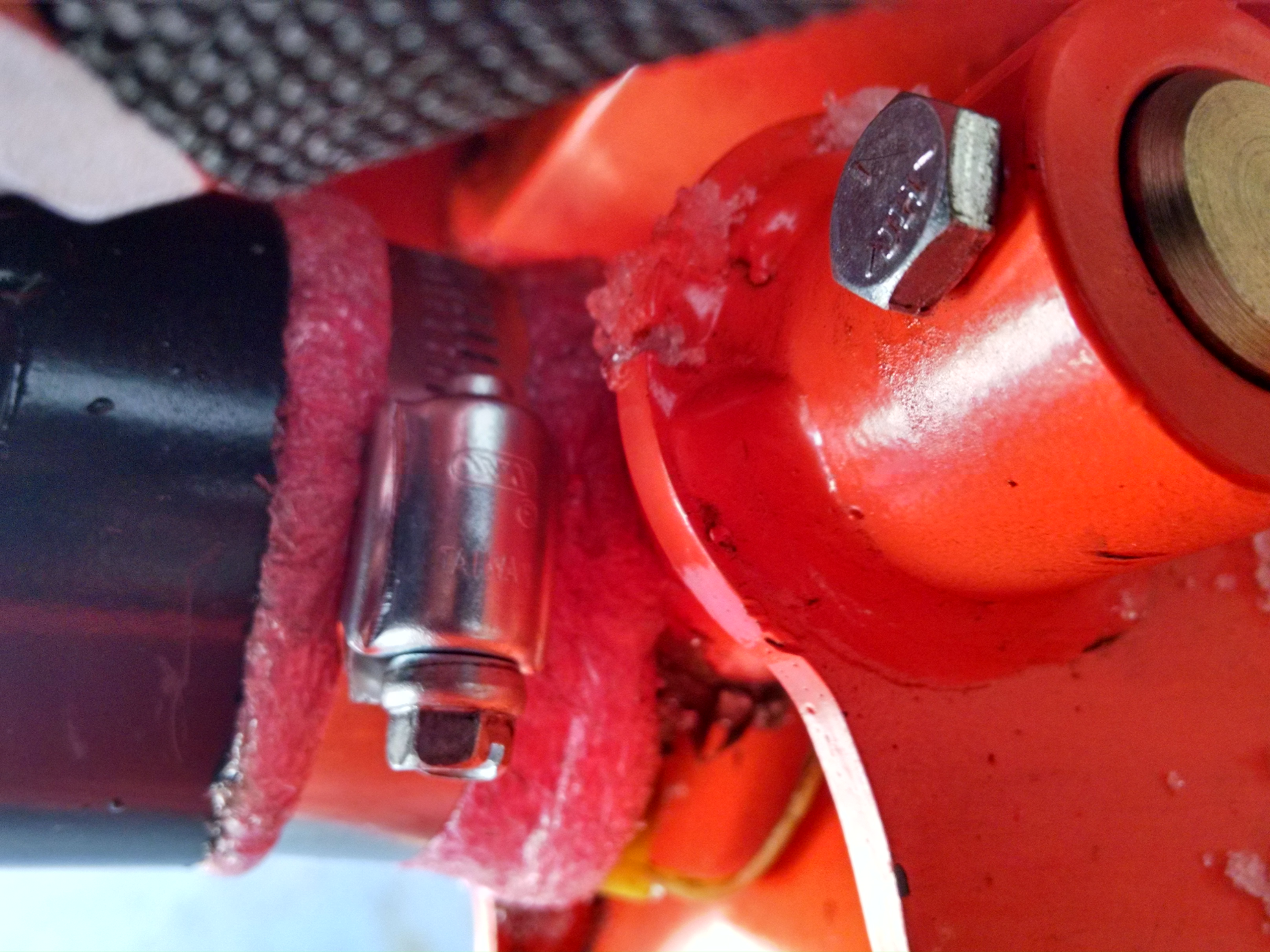

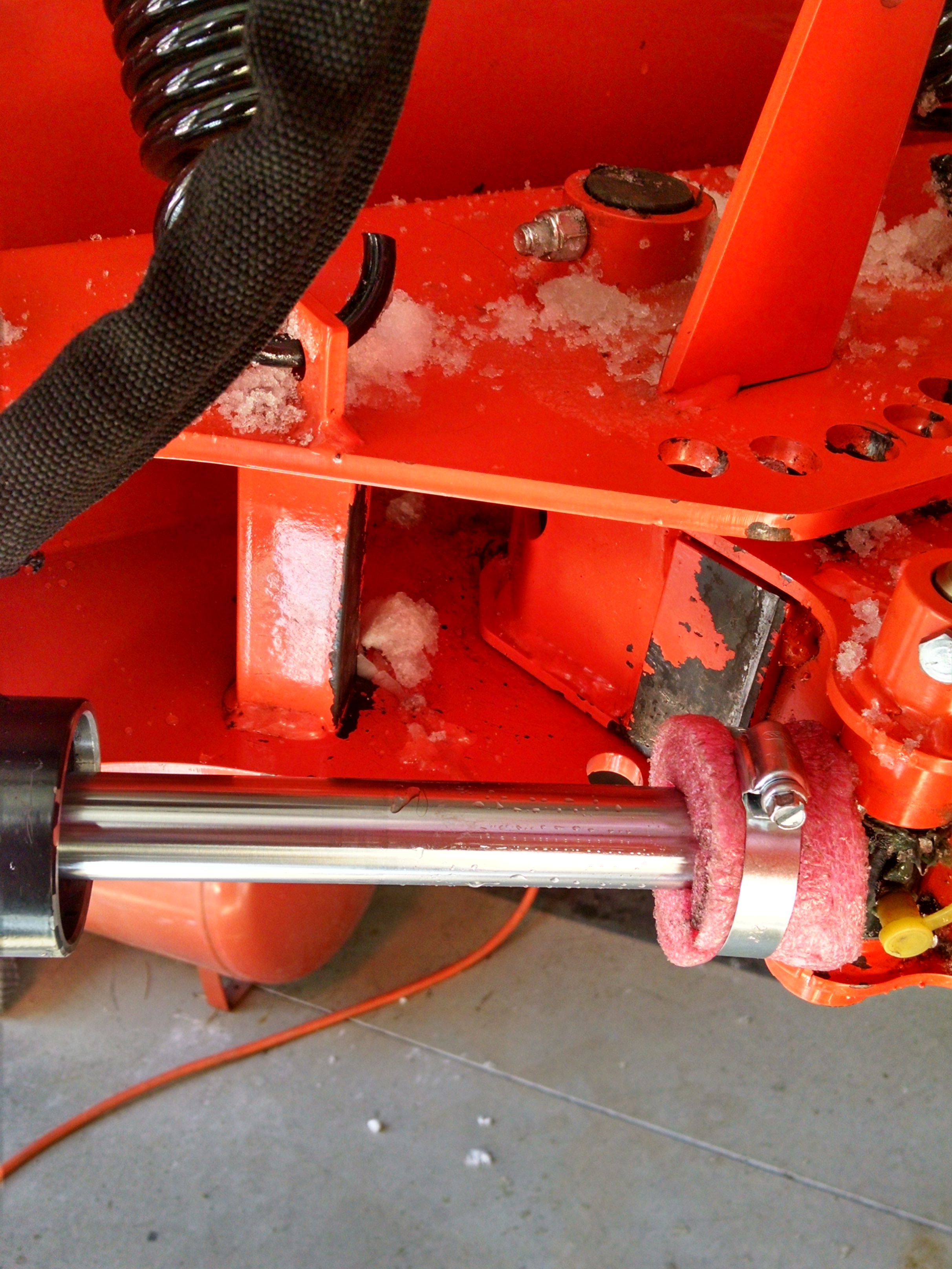

I chucked it up in the vise, fired up the die grinder, and cleaned up the burrs that protruded into the bore diameter space. I felt it was safe enough now to pull the shaft out all the way without mangling the original seals and o-rings. These showed no damage at all! Now that I had better access, I finished up cleaning up the small amount of damage inside the snap-ring groove to the point I felt confident the replacement snap ring would hold. With lots of hydro-fluid and patience, the shaft assembly slid back into place. Today, I got the cylinder re-mounted onto the blade, and the hoses reconnected. After adding some Super UDT to the pump reservoir, I fired her up, cycled the steering wheel lock-to-lock a few times to get any air out of the system, then tried the blade pivot action. Full motion! No leaks! Yippee! As an ounce of prevention, I cut a piece of pipe insulation to fit the cylinder shaft and hose-clamped it to the pin end of the shaft - all in an effort to keep gravel out of the snap ring / end cap area. We'll see...
Oh, yeah. After the snow under the blade melted, I found the guilty $#@%&* rock that did the damage. How the **** it managed to get in there... Seems I need to be a bit more careful back-dragging snow where there's a chance there might be gravel lurking.

grey goose, check where the cylinders contact (stop) on the plow frame. You may have to add a piece of flat material for the cylinder to contact (stop) instead of over extending and knocking the snap ring out.

Based on the damage to the snap ring and it's groove, I believe a stone became lodged in the open end of the cylinder and it's pin mount (see pictures in previous post). I've carved up a chunk of 'pool noodle' to fit over the shaft to block this open area. Just need to get it to stick inside the open end somehow.
There are massive stop structures built into the frame of the plow. Are you suggestion I add material to these stops?

greygoose, yes. On mine (BMX184H) I had a very similar problem. I tend to roll snow to the right most of the time, extending the left cylinder, more than the right. The stop was wore enough to let the cylinder OVER extend and pop out the snap ring. To check this, extend which ever rod gave the problem, measure its length. Then undo that cylinder from the frame and check length. If it extends more, its probably not over extending, and your theory is correct. If in doubt add some material, those worn stops won't heal. If you would like to see some pictures, I will see if I can find them. Larry
