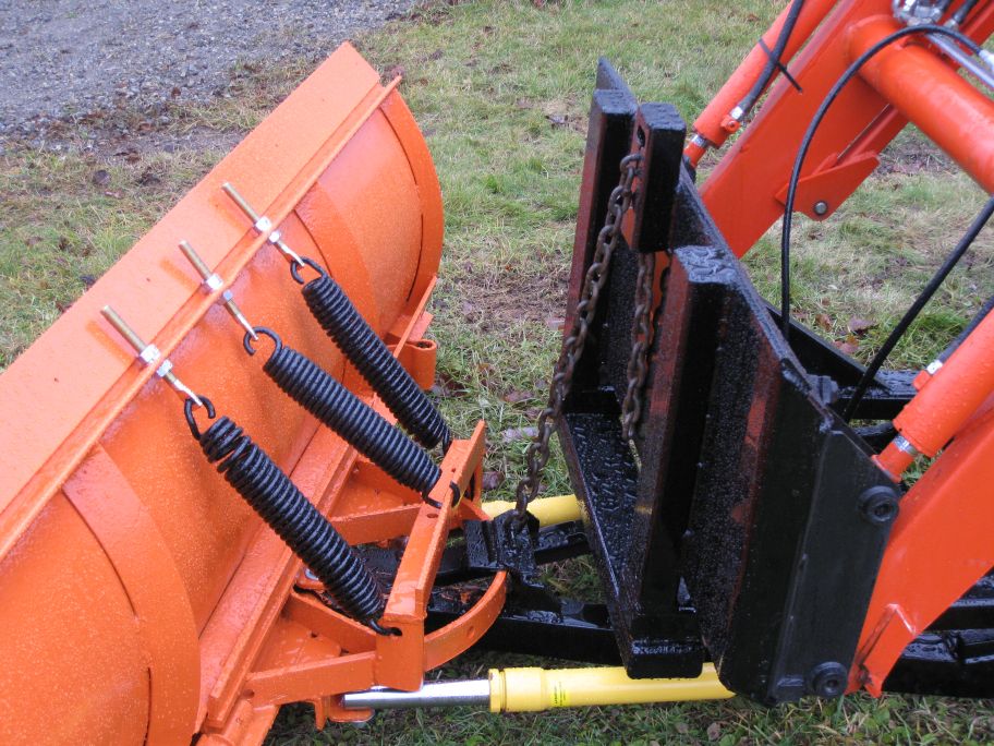

4shorts, mine is a hanging chain model and i can put down pressure on it, as much as i want or let it hang, float from the chain and let the weight of the plow do the work.
   / snow blade tilt? #23

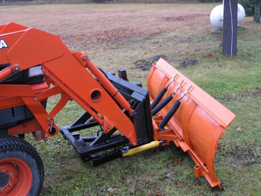

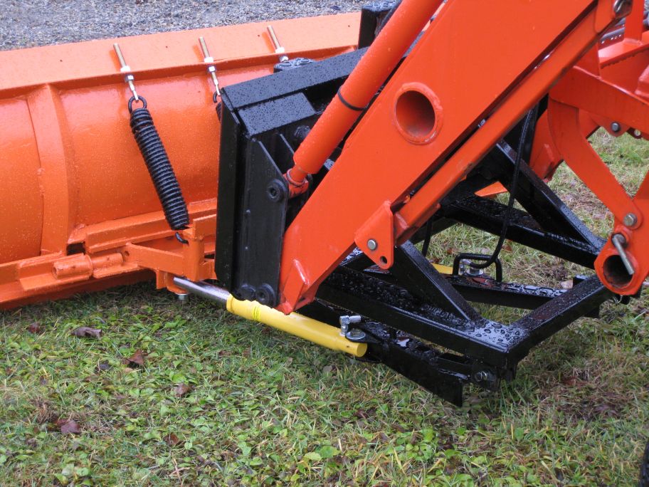

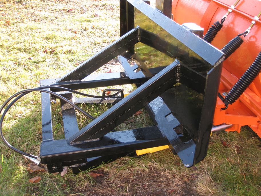

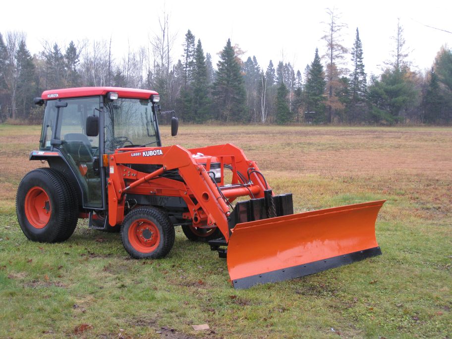

Cool. So without moving the chain and installing a solid rod in it's place you can apply down pressure? Most put a chain on for the float. All the ones I've seen are that way. Lets see a few pics :)
   / snow blade tilt? #24
Here are some pics of my setup. ray

The chain is adjustable, it is just in that position because that where it ended up at that moment. I can have about 20 inches of chain float if i need it. My property that i plow is all flat. ray

So you have it that way because there's no float on your FEL :confused:
   / snow blade tilt? #30
yes i have float on my loader also , but by using the chain as a float that keeps the full weight of the loader on the front tires. That makes for easing steering and better control.
