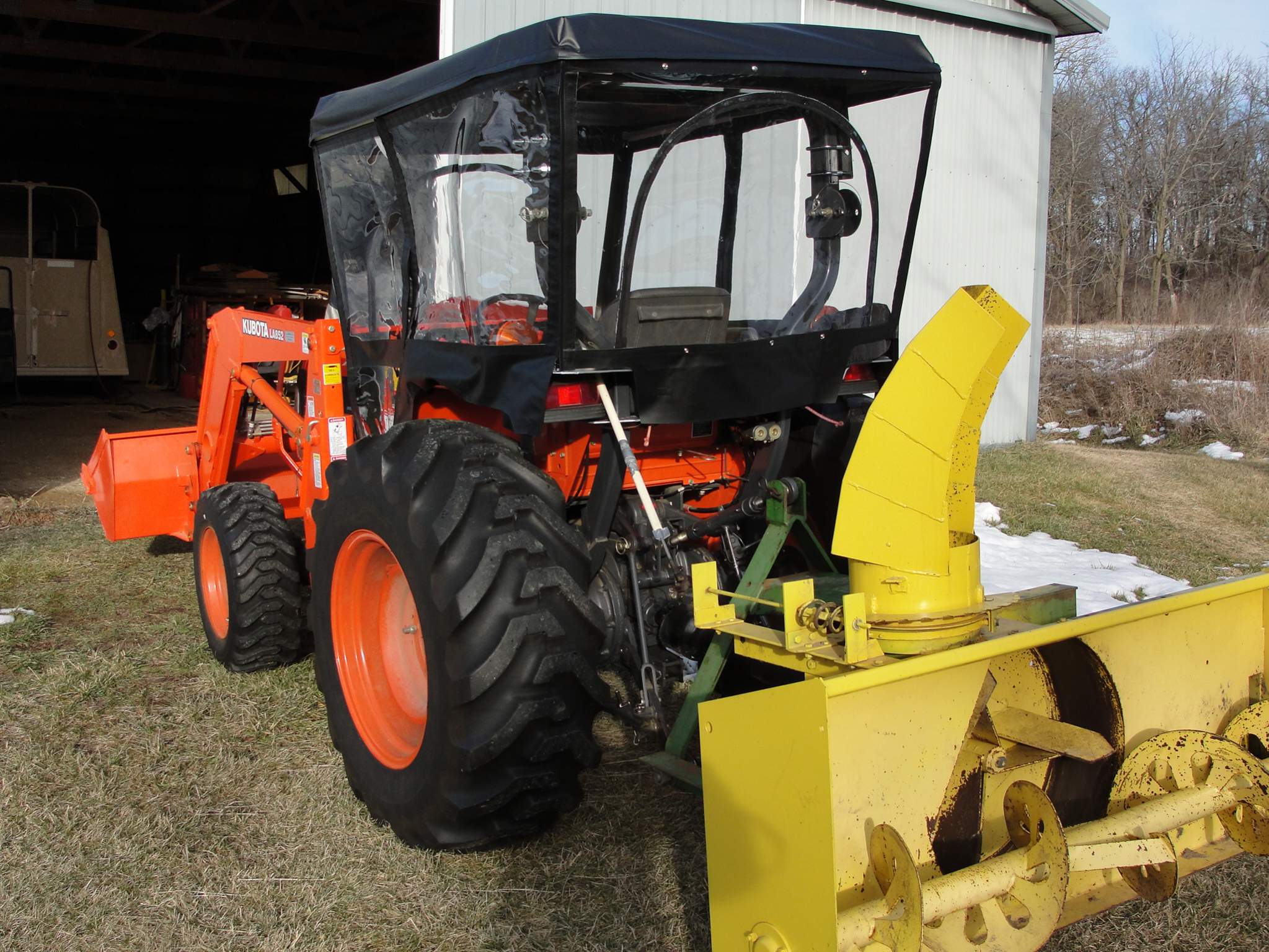

Here is my L4610 (11 yrs old) with the 17" tires and a 66" 2 stage rear mount blower. The blower is 35 years old and clears a 1000' crush stone drive way plus out buildings (part of drive is now asphalt. Decades ago I kinda worried about the nicks but after all these years it gets a little F&F spray paint and soldiers on. It was first powered by my Int'l 444. Next I front mounted the blower to my skidloader using a 30 hp. pony engine and now the L4610.
Crushed limestone is more abrasive than gravel but even with that the chute and primary impeller shroud nicks/ paint loss .... are nothing and easily repaired with paint.

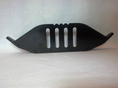

I have added a set of these to my blower asc0310_back[1].jpg http://snowblowerskids.com/ they seem to work very good after getting them adjusted.

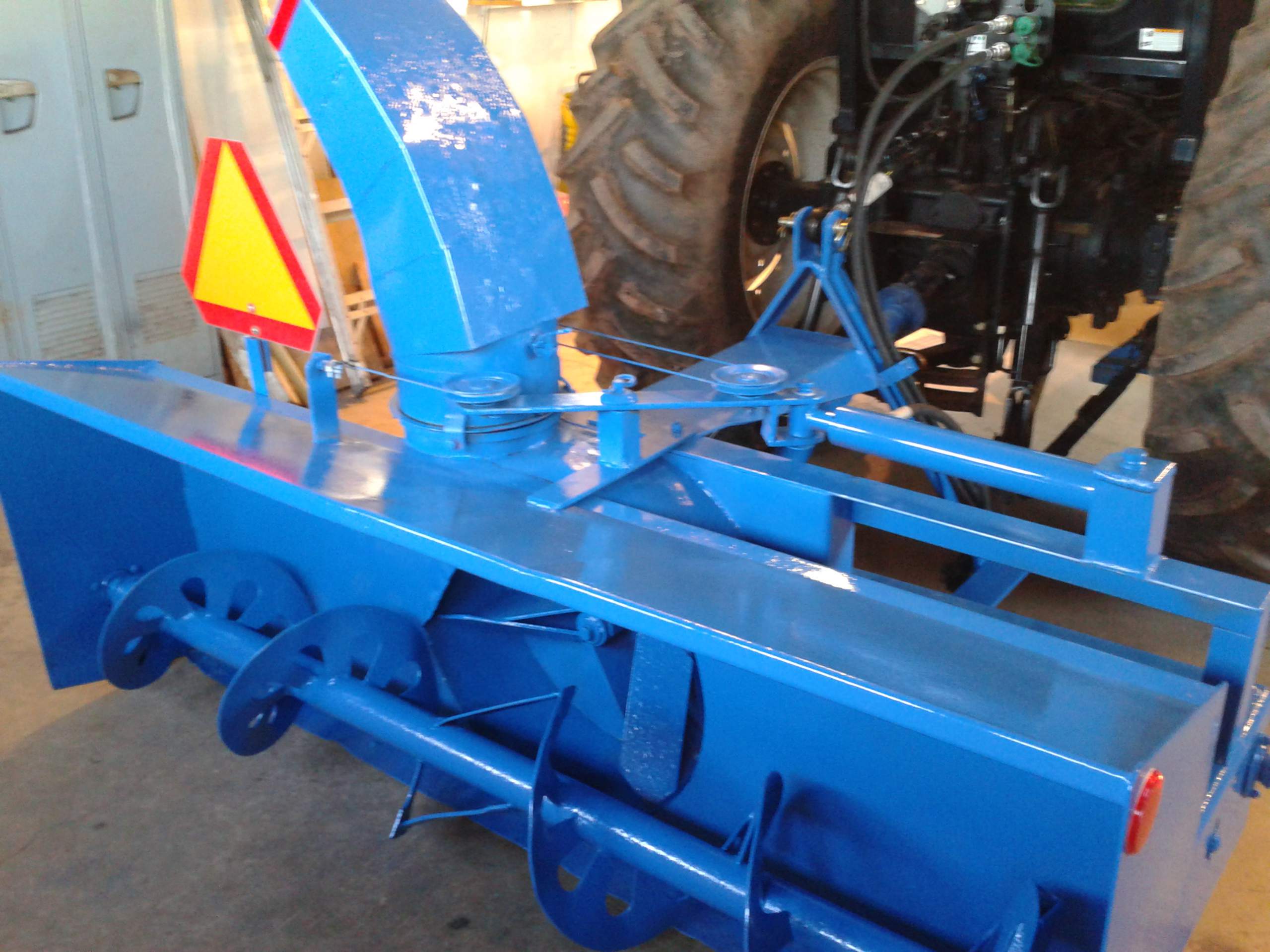

I am a little late for this MacTractor, but this works good for me.
I set my 3 point stop to keep the blower about an inch off the drive. I do this on a level spot when setting up my blower. This way i am not dragging my blowers feet in the gravel if I do not have packed snow and if the drive gets a little slushy, I am still able to get rid of most of the snow this way. I still blow a little bit of stones at times but it saves my wife from blowing the whole drive away when she is running it.
