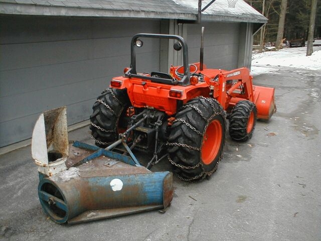

Then came a rear mount backup

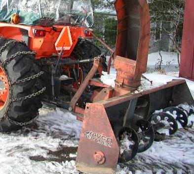

But I still got a stiff neck - so a front-mount beckoned....

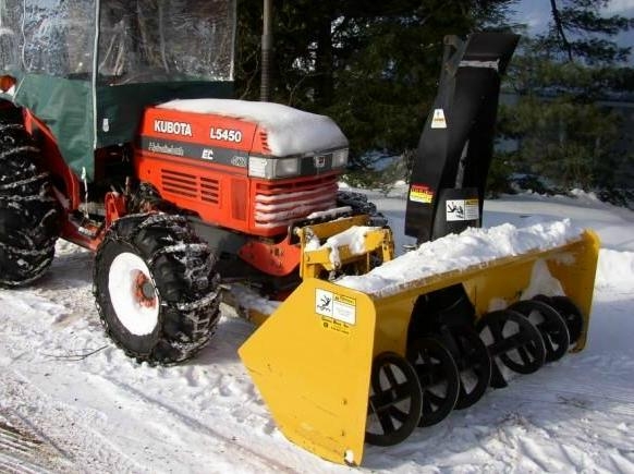

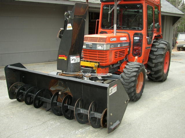

My first ERSKINE was almost perfect, but not wide enough so we stretched one 16"
This rig does it all. It can even side-swipe center piles left at obstacles (with practice)

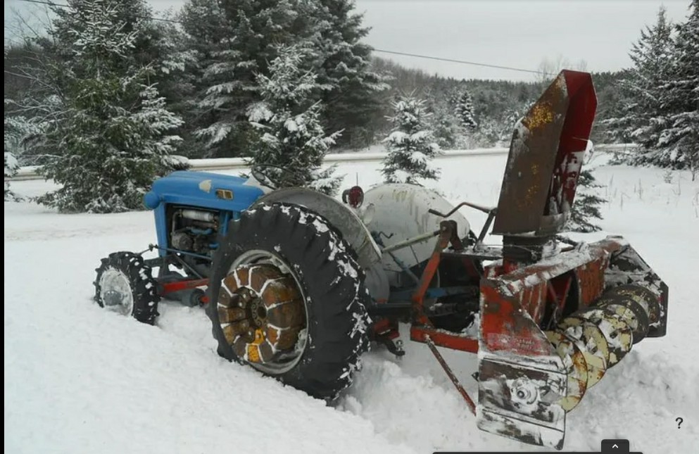

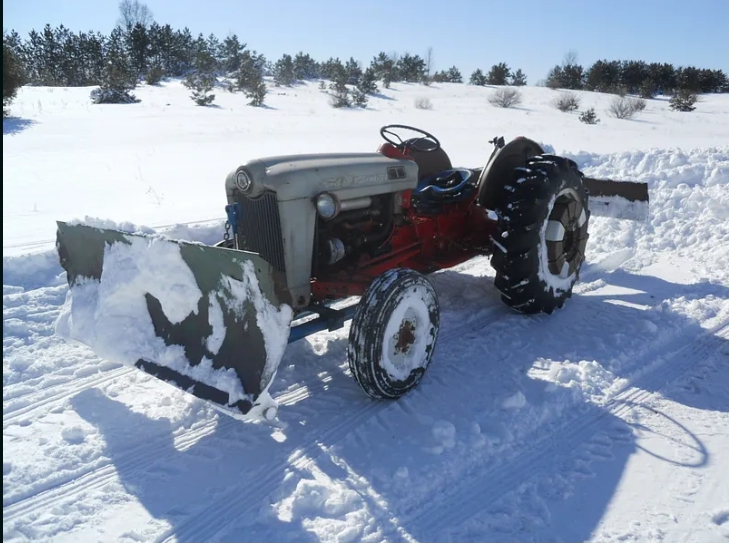

I first plowed and back bladed before switching to snowblowing.
Front and rear blades.
Next came a rear blower.
Currently using a front blower which is by far my favorite way to deal with snow. Rear box blade very helpful as well.

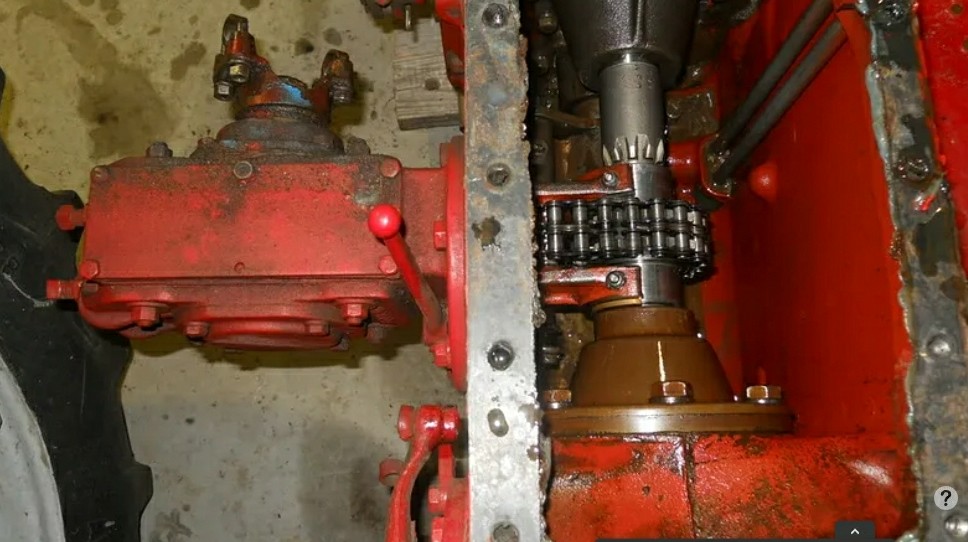

WOW! Is that a driven front axle on a Jubilee ? That's the coolest thing I've seen in a while - very impressive (not to mention understated) - where does it get power? That's just great!
My first tractor was an 8n (2wd) but I never knew about 4WD conversions. For pulling an orchard sprayer thru wet spots it would have been great to have. Maybe would have side-stepped the whole Kubota hobby....
I just looked at your great thread about your Ford 860 with Sherman-Napco 4WD . Not a simple bolt-on. Take care, Dick B

The front axle is chain driven from a sprocket between the trans and rear end. A transfer case is mounted where the original pto shift lever went. Actually was pretty easy to install. Only required a rear split between trans and rear axle housing, and remove original front spindles and install driven front axle. The 860 is like a bull in the China shop snowblowing lol. The Kubota is so much easier to use up close to buildings and vehicles.Screenshot_20201123-232706.jpg
