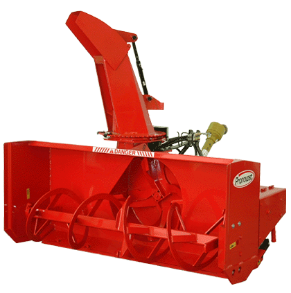

gr1p.gifThey do need to be check. I usually put then back with blue Loktite. There are a lot of vibrations... Even the plunger that holds the bearing in place will come loose (first stage)... They are real nice at first, but they do need our attention... Ah! I wish I had one of those commercial one's sometime... http://www.pronovost.qc.ca/pdf/Pronovost - Snowblowers.pdf
