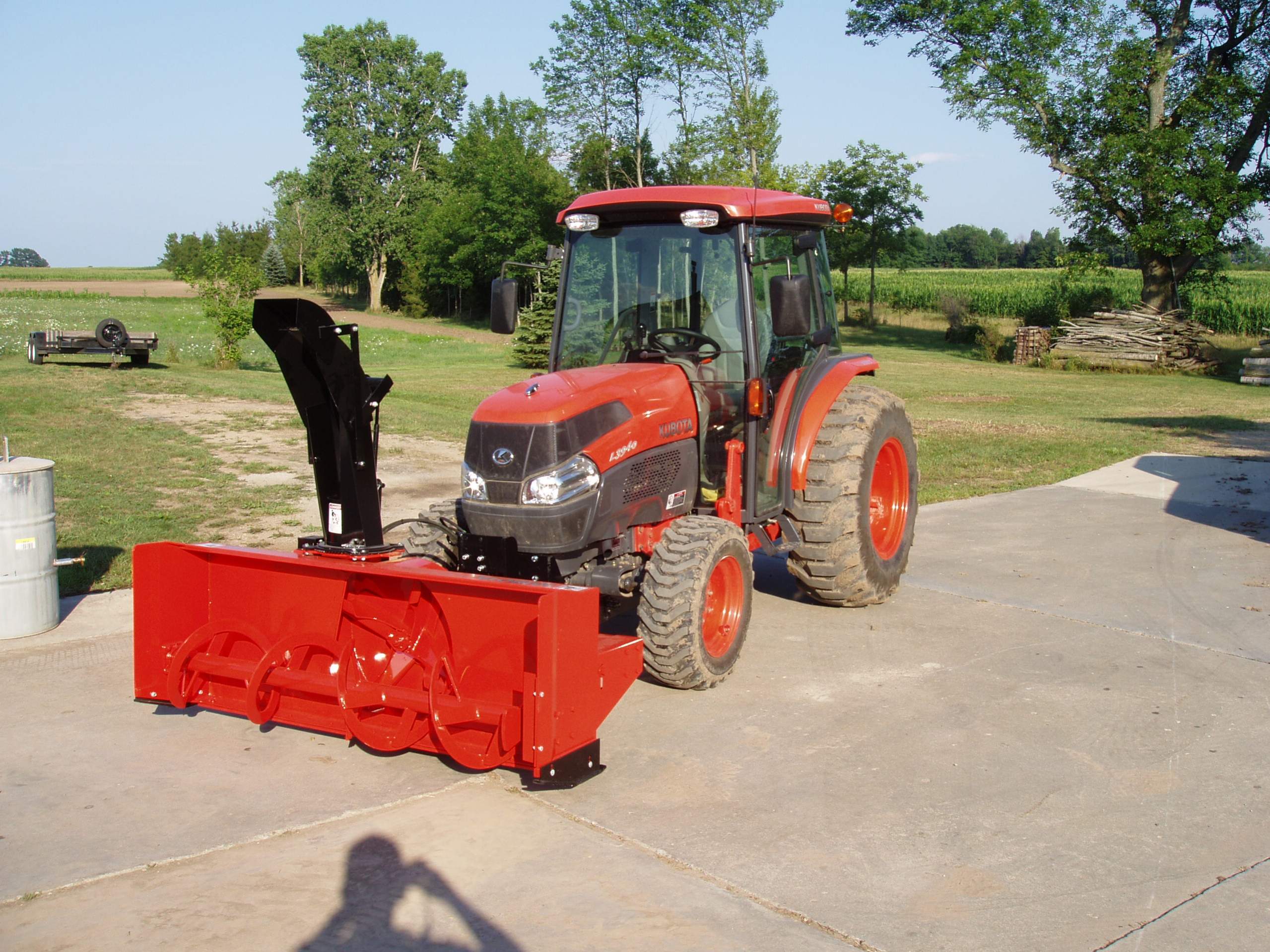

First off I'd say it is out of balance as far as snow delivery to the fan. Is one auger flight is off by 180 degrees? The collection action ought to be chuting the snow into the fan. That's not going to happen the way the picture seems to show in your machine. Give us a picture of the entire front of the unit.
I have 2 Kubota blowers and the augers are SUPPOSED to be 180° out.

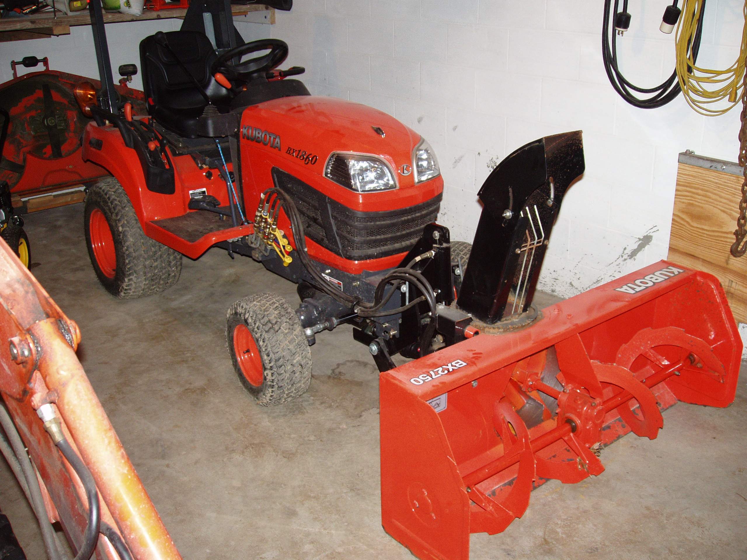

I have 2 Kubota blowers and the augers are SUPPOSED to be 180ー out.
I agree, my BX2750 manual says one end "up" and one end "down"

I'm not talking about the 'ends', I'm describing the middle where the snow collects on its delivery to the fan. The 2 pictures are from 2 different random snow blowers that I found pictures of. Here are some more. All I've ever seen in the field is the collector section at the center of the auger frame is in phase. The 'ends' are out of phase generally because they are a different length. Check out the schematic, the augers meet in the center while the ends are 180 degrees out.
SeaRay's don't seen to be positioned that way. Snowblowers that are 180 degrees out at the CENTER usually have 2 rake straps joining them to shovel snow into the fan. These are the end drive type with a roller chain drive. Can't do that with a center drive gearbox.

You can preach all you want but Kubota is very clear that the augers at the center are 180 degrees off.
Only one auger to a time feeds the blower.
They even have a decal in the housing to show proper orientation.
They may have other designs that work like you show but my 2750 and my 74" unit work the same. The large one is a one piece unit but made like the smaller 2 piece.

Kevin, ZZ..
You folks got me wondering about my 2750. I had sheared a bolt a few snowblows ago, replaced it without too much thinking. But thought it was shaking a bit more that I remembered. Thanks Kevin for pointing out the decal in the blower housing that showed the out of phase orientation. I had mine both coming together near the center like ZZ was postulating. I have now changed it so the augers are out of phase. Guess I will have to wait for more snow to see the effect. In terms of snow throwing ability, I did not see any difference in the amount thrown or distance. It is more than enough. I did notice the shaking. Not that much, more like when one has wet snow sticking. Need to pay attention to decals. Staring right at me..... but at 14F one doesn't look too hard. Removing a sheared bolt is cold work with bare hands. Orientation.....least of my issues at the time.
