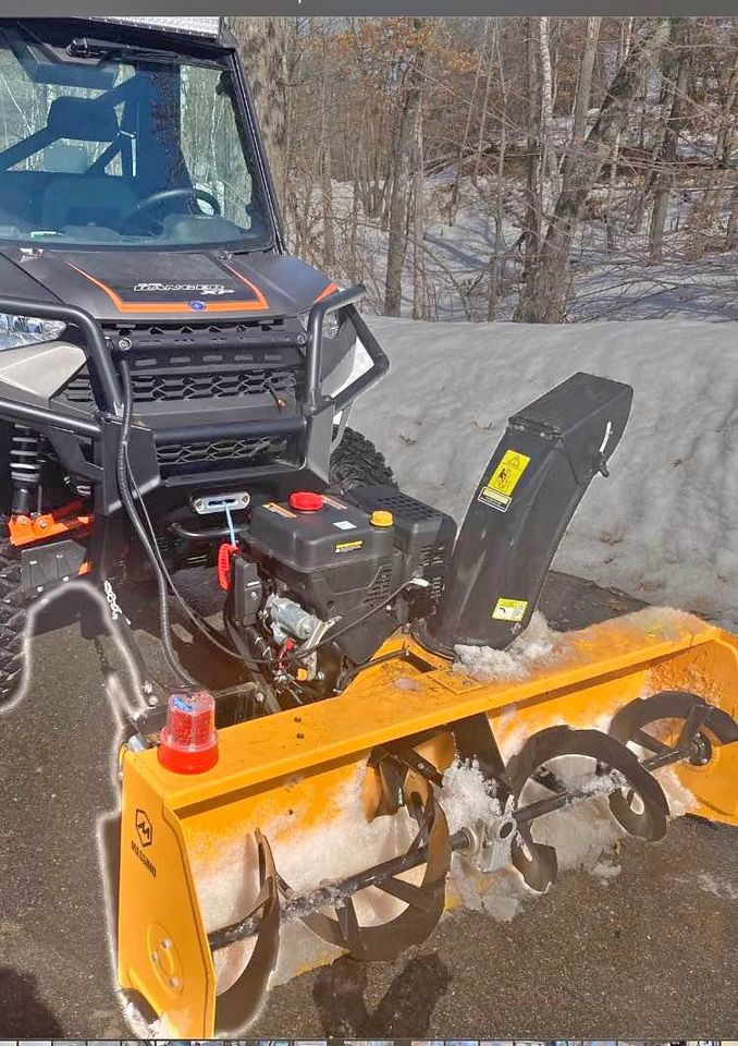

I know this isn't a tractor but I bet some here will have experience with one. If it's not allowed moderator, please delete. How well could a 28hp 4x4 utv handle a 60" snow blower? I've got lots of hills with a dirt driveway/road.
All the controls are in the cab. The blower has it's own gas motor. I plow mostly with a truck but there are a few places it would be nice to get the snow farther back. I know nothing about utv's or even 4 wheelers for that matter. Seems like I see them with plows fairly often but not blowers. I haven't bought anything yet, just thinking.
Thanks for any wisdom.
The only ATV/RTV/UTV snow thrower you should even consider buying
is the RAMMY 155 single stage snow thrower, it is a single stage machine
that has V belt drive.
The Rammy single stage snow thrower has many fewer parts than a
2 stage ATV/UTV/RTV snow blower.
The drive system is simple and operates at 600+ rpm.
It is much lighter than the 2 stage machines on the market
and has a Briggs and Stratton engine.
There are a bunch of youtube videos with the owners clearing deep snow,
they have a dealer network in the northeast and in Maine as well from
what I remember.
I have uploaded a lot of information about them here on the TBN forum previously.
www.rammy.fi/en/rammy-snowblower-155-utv-pro/

Rammy, never heard of them til now made in Finland so it's probably sisu lol they make lots of other ATV attachments like front mounted ATV rotary mowers and a flail.
Interesting but pricey.
