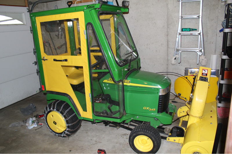

I have a single stage blower on my GX345 and it works great. I'm sure a two stage would be even better yet. I used it for a while without a cab and it really wasn't that bad. I recently came across a beautiful Curtis cab, and couldn't pass it up. Now all I need is a heater, and I will be all set for next winter.
As far as a plow goes, I don't know how much snow a 2wd tractor will be able to handle, before having traction problems. If you have a differential lock, I'm sure that would help, just not sure if it will be enough in deep wet snow.
