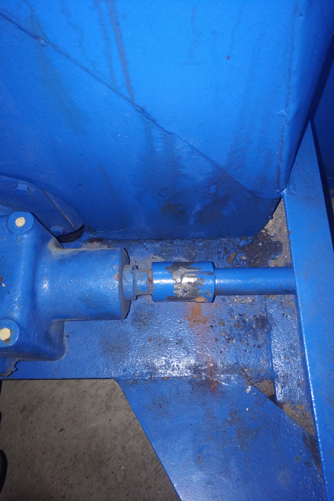

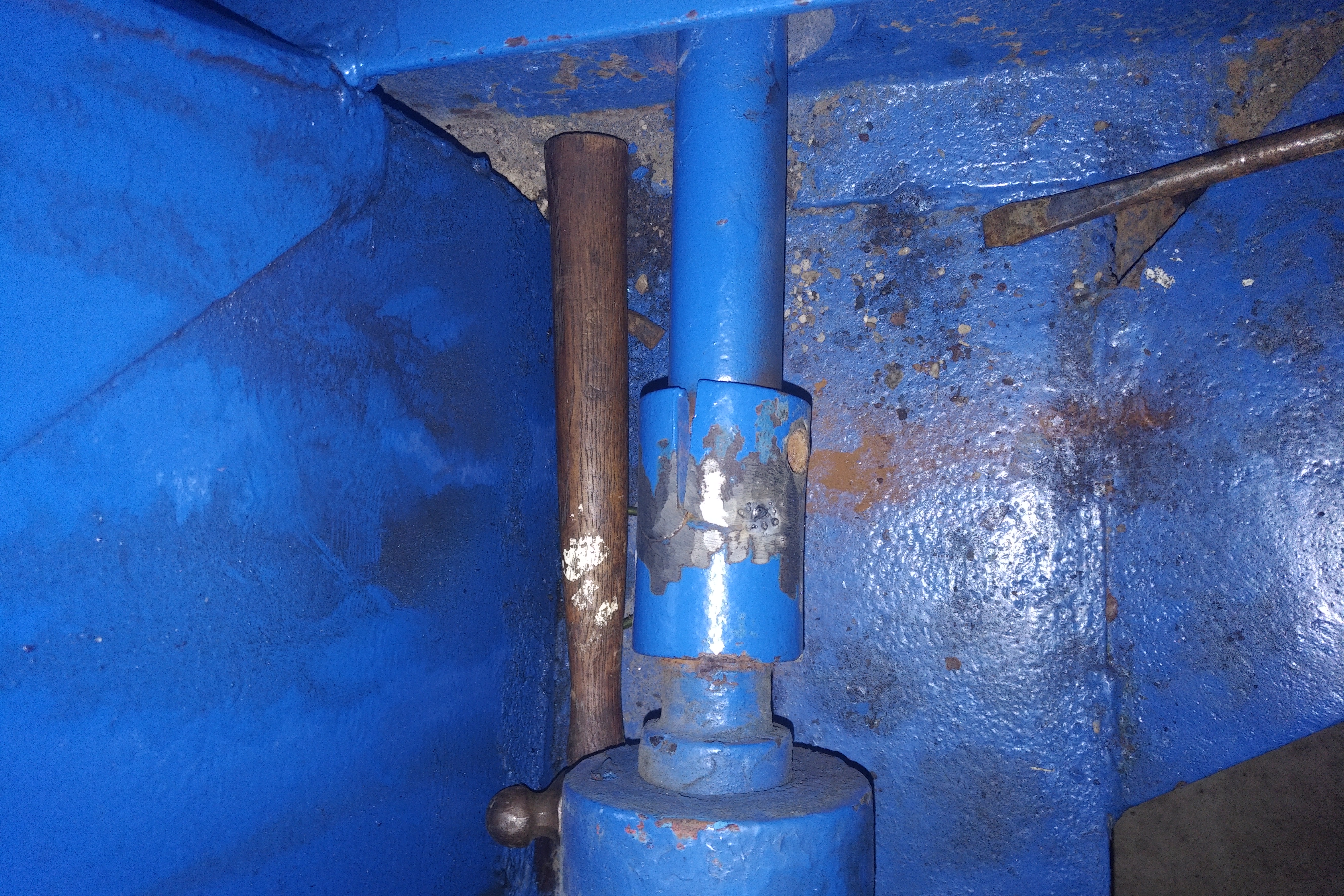

I recently bought a snowblower that needs work. It痴 an Astron 80 dual auger. (Old and heavy). The slide coupling connecting the gearbox to auger drive shaft is worn out and broken. It痴 a 19 spline on one end and round shaft with shear pin hole on the other.
I am having a hard time finding anything similar. Not even a 19 spline coupling that i can have bored out on one end. Does any one know of a source for this coupling?

What is the outside dia of the splined end....and the dia of machined out end?
/ Snow blower repair #3
I'd try cleaning it up and welding a short piece of Sch 40 black pipe over it and re-drilling for the shear pin. If there isn't a size of pipe that fits well. slice a piece out of a larger and collapse it to fit, or cut a relief in a smaller one.

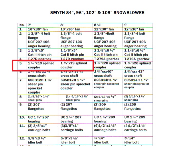

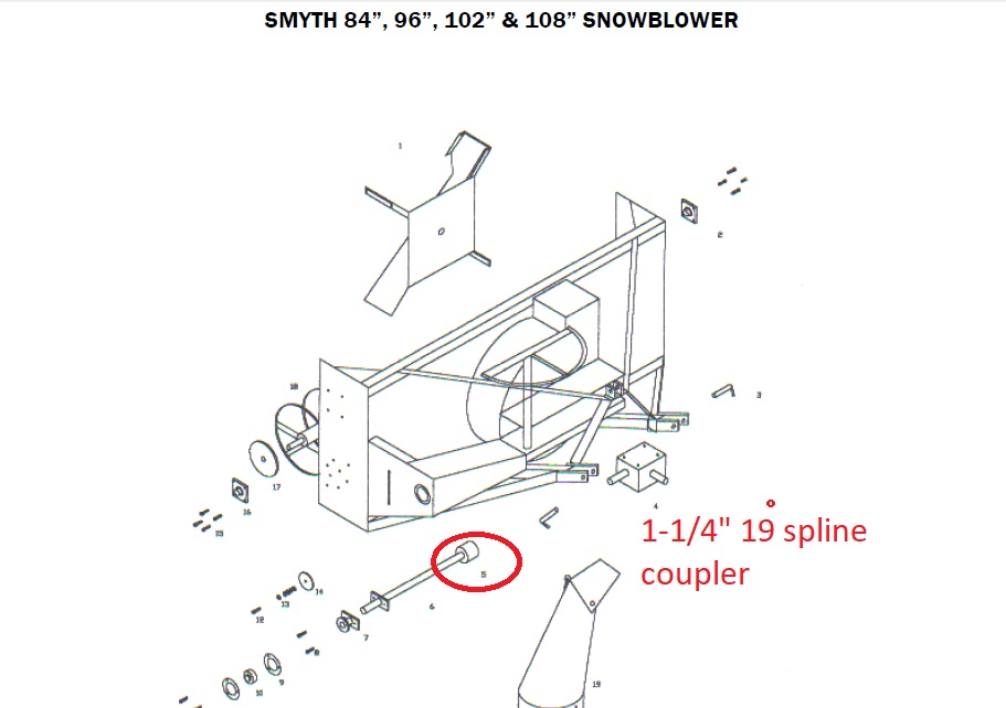

I had an inspiration and found out the Astron blower was made in Elmira Ontario.
There are a number of blower companies that have come and gone from that area.
Smyth Welding is one presently there and in their product line is a 1-1/4" 19 spline coupling.
They have dealers in the USA which you can find on this link
FIND A DEALER, SMYTH WELDING & MACHINE SHOP Aubrun, Ontario 519-529-7212
Dave M7040

I found a 1-1/4 inch 19 spline to 1-1/4 inch shaft/shear pin coupling. This blower is 1-1/4 spline to 1-3/8 shaft.
My solution at this point is to order the 1-1/4 inch coupling and have the round shaft end bored out to 1-3/8”

I found a 19 spline coupling and had it machined to fit. The old shear pin hole in the shaft was filled in and redrilled for a tight fit. I decided to replace it as it was designed, i can always weld it in place later if i feel the need. 3 small bolts were put in place as shear pins on the chain end of the shaft. I didn’t like two shear bolts held the sprocket in this setup, without three the sprocket wasn’t inline with the chain. This is a very heavy blower and i am sure they will break before anything else.
The old coupling was also cut lengthwise on the non splined end, as if to allow the bolt to draw it tight. We didn’t do that, just a nice tight machined fit.
Thanks for the advice.I am glad to have it working and will be making improvements to it shortly.
