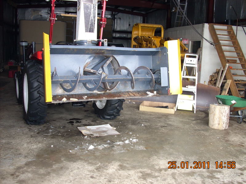

/ Snow blower wings #6
Here is what I did - the extra width is 4" each side. They seem to make a difference - I now have a couple of inches clearance on each side of the rear wheels.
Cheers
Jim
