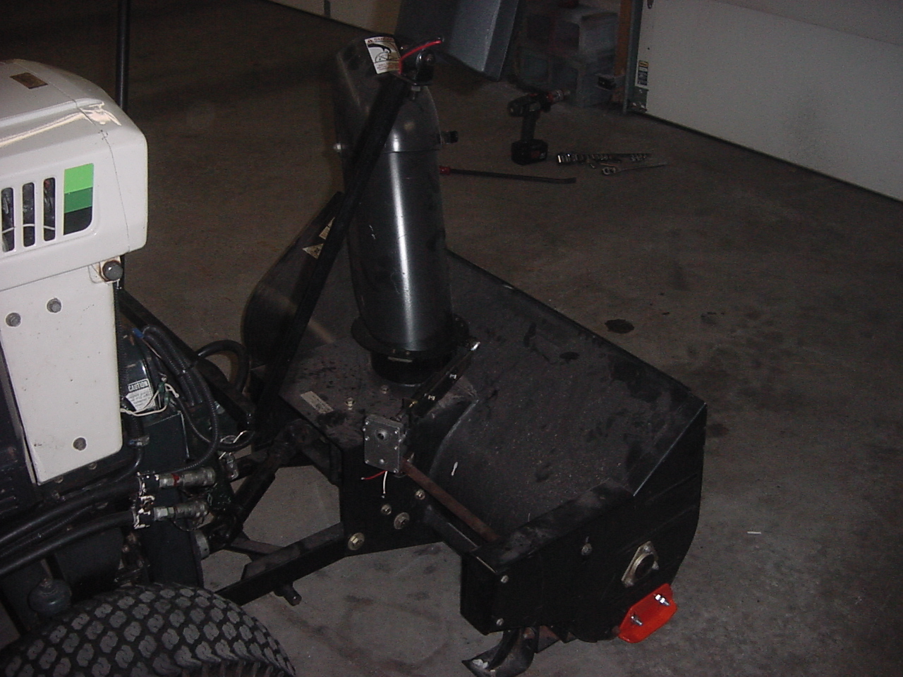

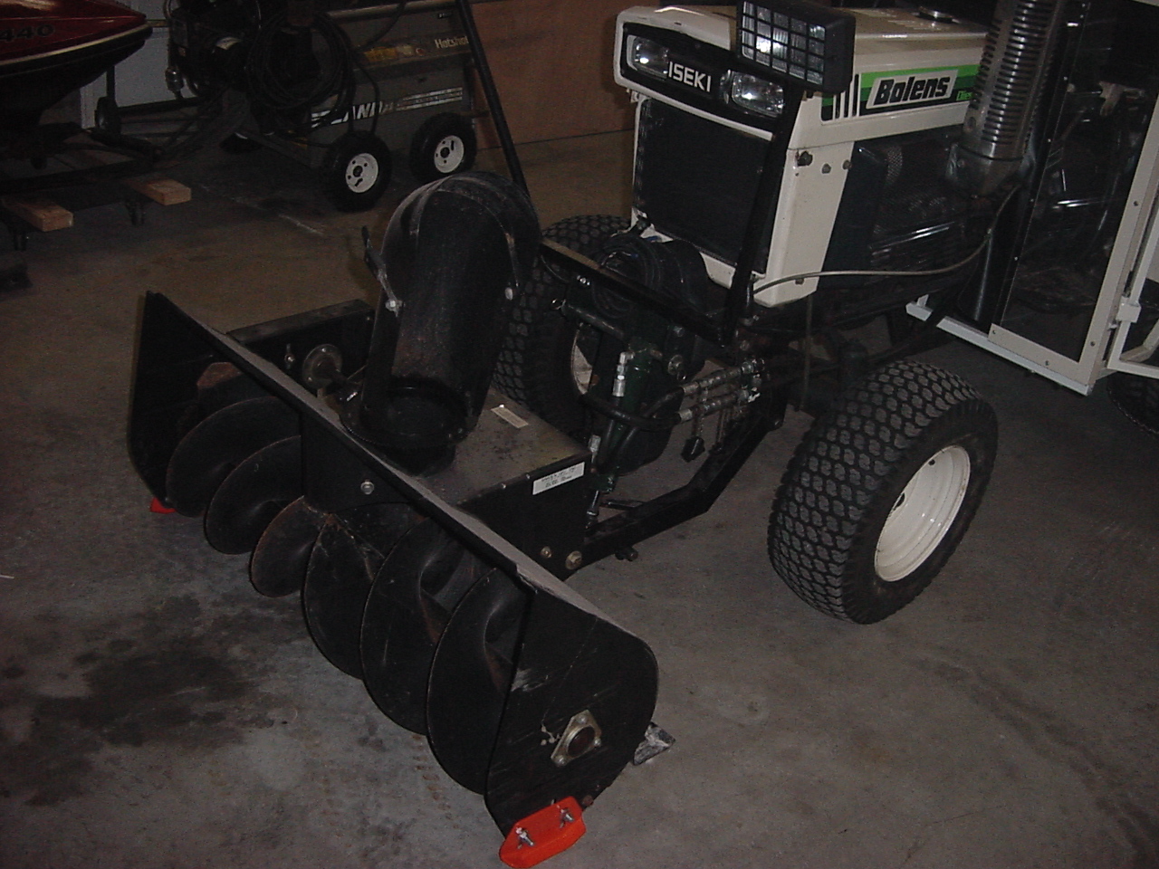

So a while back I bought this blower for my Iseki tractor, I finally got around to installing it and guess what, it spins the wrong direction. Anyone know of a fix for this, I cant see one. My PTO spins counterclockwise from the front of the tractor, but the blower spins as if to push the tractor backwards, not drive it forward as it should DANG!

The Iseki tractor front PTOs spin opposite of most other Bolens and garden tractors. It's an important issue that tends to get overlooked. Took me a while to get onboard with that problem too. I'm not sure if Bolens produced both clockwise and counter-clockwise versions of the single-stage blowers but there seem to be plenty out there. You shouldn't have trouble finding one. Now a 2-stage seems to be more difficult.
Can you post pictures of the chain drive? You might have some sort of option there to change the direction. Not sure about the gear box.

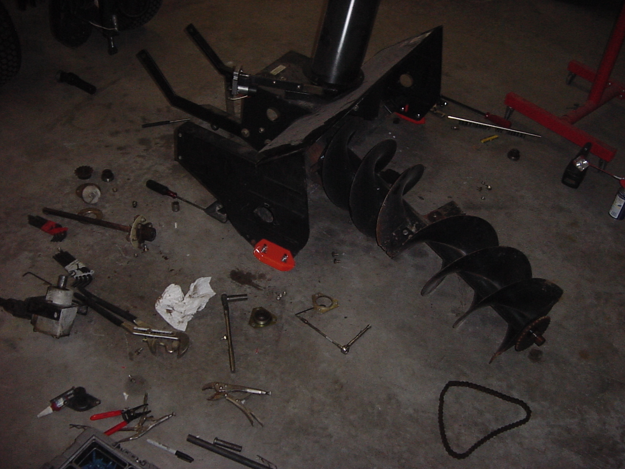

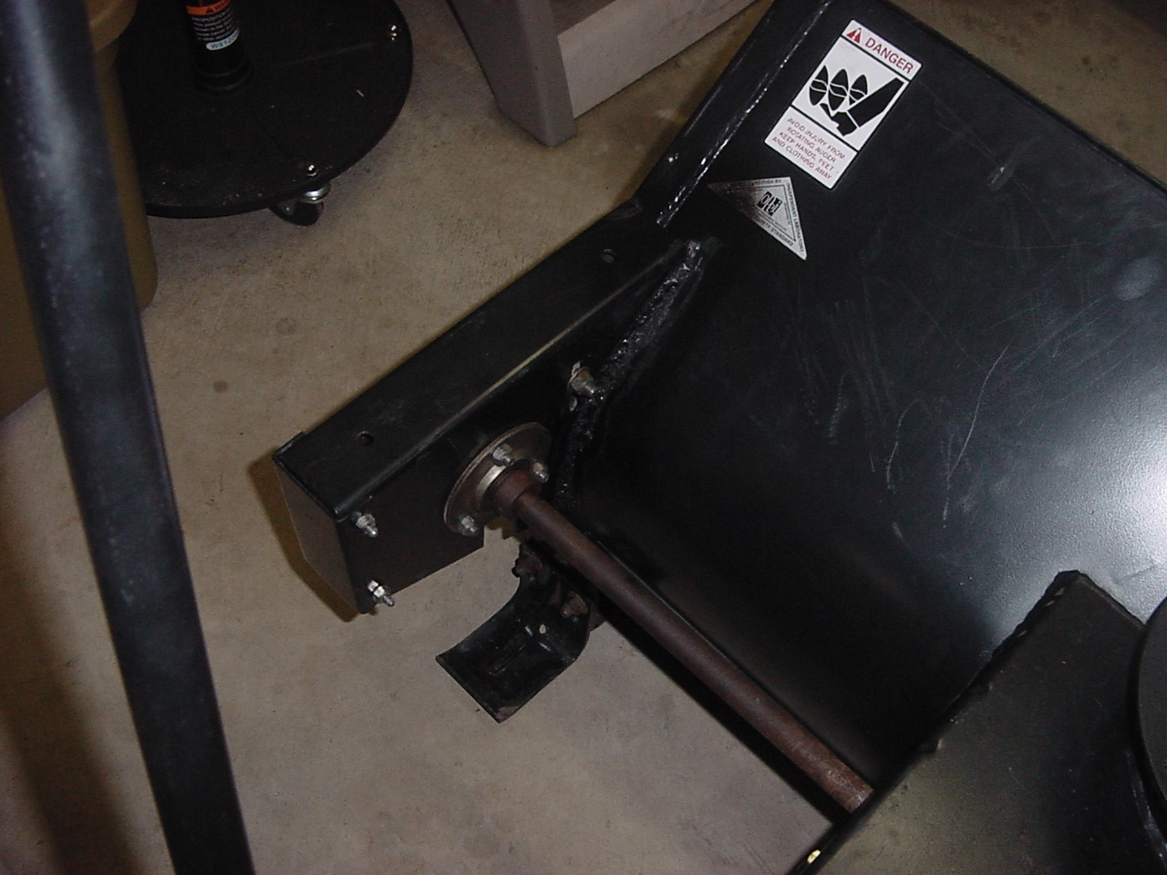

Well the switch from PTO direction isnt made into the unit, so I decided to pull it apart, spin the gearbox 180 degrees, move the chain unit to the left side and wallah, it will spin the correct way. Nothing a liittle cutting and welding cant solve. I wouldnt be so into this, but I have already mounted up a electric chute rotation motor to it, and wired it into my tractor prior to learning it spins the wrong way. I drove about 200 miles one way two years ago to buy this thing, and spent about $200 bucks on it, fabricated a mount to fit an Iseki tractor. I even have a linear actuator to make the tip tilt.
It would have been great to learn that this thing could be made to accept cw or ccw PTO built into the unit, I figured maybe it would of because it was made back when they made em like they used to LOL.

Sounds like a good plan. :thumbsup: Undoubtably others will run into the same issue and they can use the same fix. IIRC when I replaced the seals in my gearbox you could run the output shaft out the opposite side of the box and it would spin the opposite direction. That way the user wouldn't have to make new mounts for the gearbox housing since it wouldn't have to be flipped. Not sure what your configuration is but something to look at. I don't know if that was the intention on the Bolens units or not in this application. I think the gearbox was used possibly for the mower decks also. Hard to tell for sure. Your gearbox looks a little different than the Bolens one from what I can see in the picture.

Well, last night I discovered the ends of the impeller also need flipped, not sure if I want to continue, I like to do these projects, but I might be asking for problems balancing this rig once I get into that. Still pondering, but lost a little initiative since last night due to problem I didn't notice then. So do u think RPM would match with this blower?

Turns out I can do this. I got discouraged the other night due to finding that I cant just flip the auger over, the ends have to actually be cut off and switched to keep the paddle portion throwing snow into the chute the correct direction.
I first thought, how the heck am I gonna keep it true so it doesnt spin wobbly once I cut the ends off to swap them. Turns out after cutting the ends off, there is, or now was, a 1 inch rod going thru the center of the entire auger, but the internal auger outer tube is 1 3/4 inches with these steel spacers welded to the original center 1 inch rod to make up that 3/4 inch of space, those spacers make it so it has to be true. So today I got a new center shaft (1 inch solid steel rod cut down to fit the width of the blower thru the auger), then tonight I gently (as gently as possible with my grinder) removed the spacers from the original 1 inch center shaft by grinding out the welds holding them in place, then they fit precisely on my new center shaft so it cant be out of balance, same with the end chain gear, it fits so precise that it almost cant be out of round.

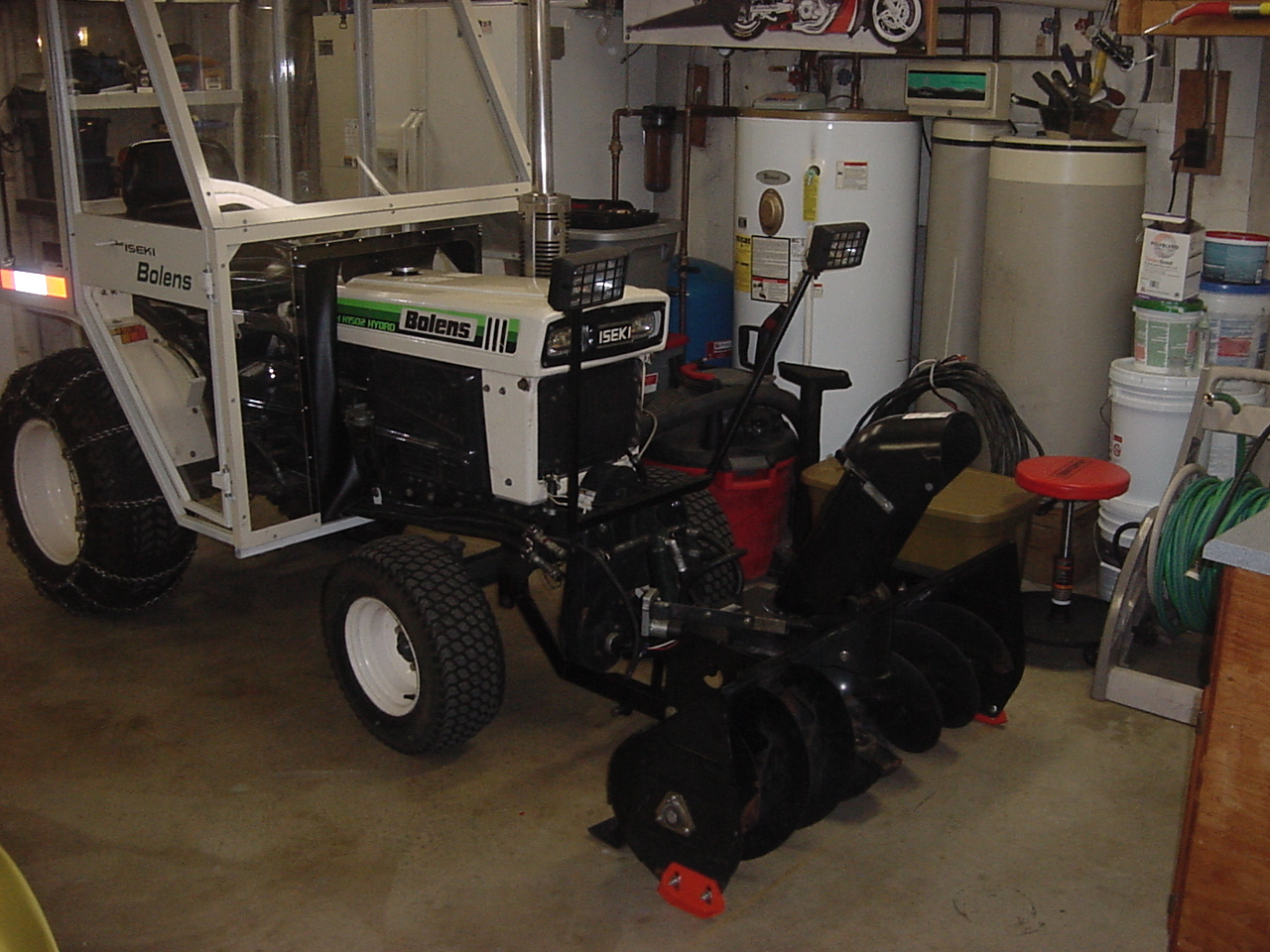

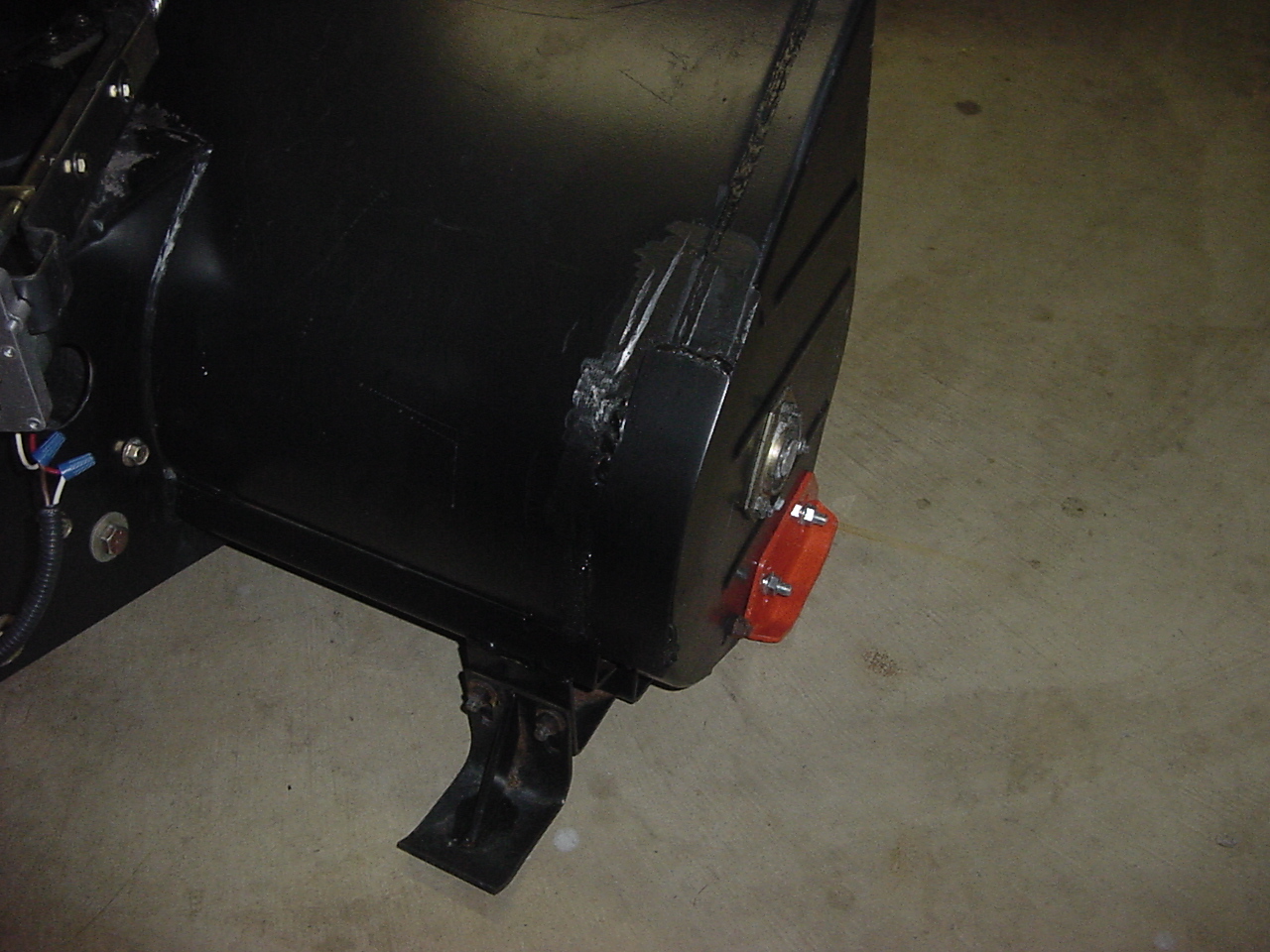

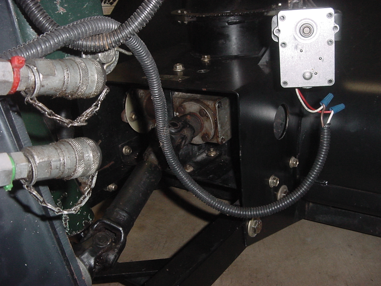

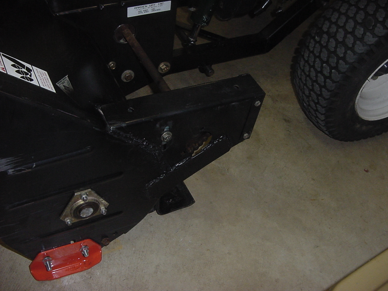

Finished up the blower today, cut off the sprocket box from the right and moved it to the left, flipped the gearbox 180, swap the side of the auger the sprocket was on. A little cutting, welding, drilling and some black paint and its finished. It appears to not wobble or shake much at all, I was pretty meticulous in attempting to keep the whole setup as true as possible, not certain how big of a concern that is with something like this. I will have to test it out the next time it snows. I dont mind fabricating and have quite the assortment of tools, however next time I will check the shaft rotation before buying, live and learn.

Looks good. Keep us posted on how it works. Did you get a chance to check the auger speed? Don't feel bad about the shaft rotation, that's an easy one to miss. I would have bought an incorrect one if the seller didn't bring it up during the sale.

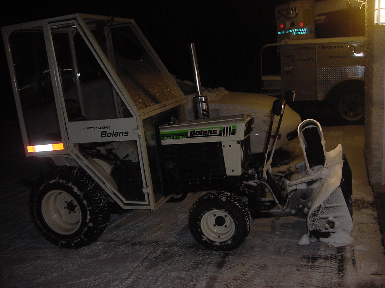

I never got a chance to actually check the RPM speeds at the auger, however we got about 6 inches of snow outside and I did my whole driveway with the blower (about 1/10 mile) and with the tractor rpms at 1800 and above the blower moves snow real well. If anything it seems to work better when I hit deeper snow. The blower is good for my drive that is about a large truck width wide, and throws it off to both sides easily, however the parking area at my house is about 100 feet by 75 feet (where I park my company vehicles), so I have to go straight into it and just blow it forward to keep it off the whole area while blowing as it cant throw it as far as either the length or width. Im also glad I installed an eletric motor to do the spin of the chute as I would of been in and out of the cab numerous times. I wanted to use this unit before putting a linear actuator on the tip of the chute to change the throw angle from the cab. I wanted to use it before putting anymore $$$ into it, but now im sold on it and its capabilities. :)

Congratulations. You sure did a nice job.
/ Snow blower woes #16
Glad it worked out for you. Others will run into similar problems and may be able to use your modifications for a solution. To be honest I never really liked single-stage throwers much but I have to admit they do work pretty well for the most part. I'm sure you'll continue to be happy with yours. I found having a snow thrower on the front and a rear blade work really well together. Especially the rear blade for sidewalk work. Have fun!
