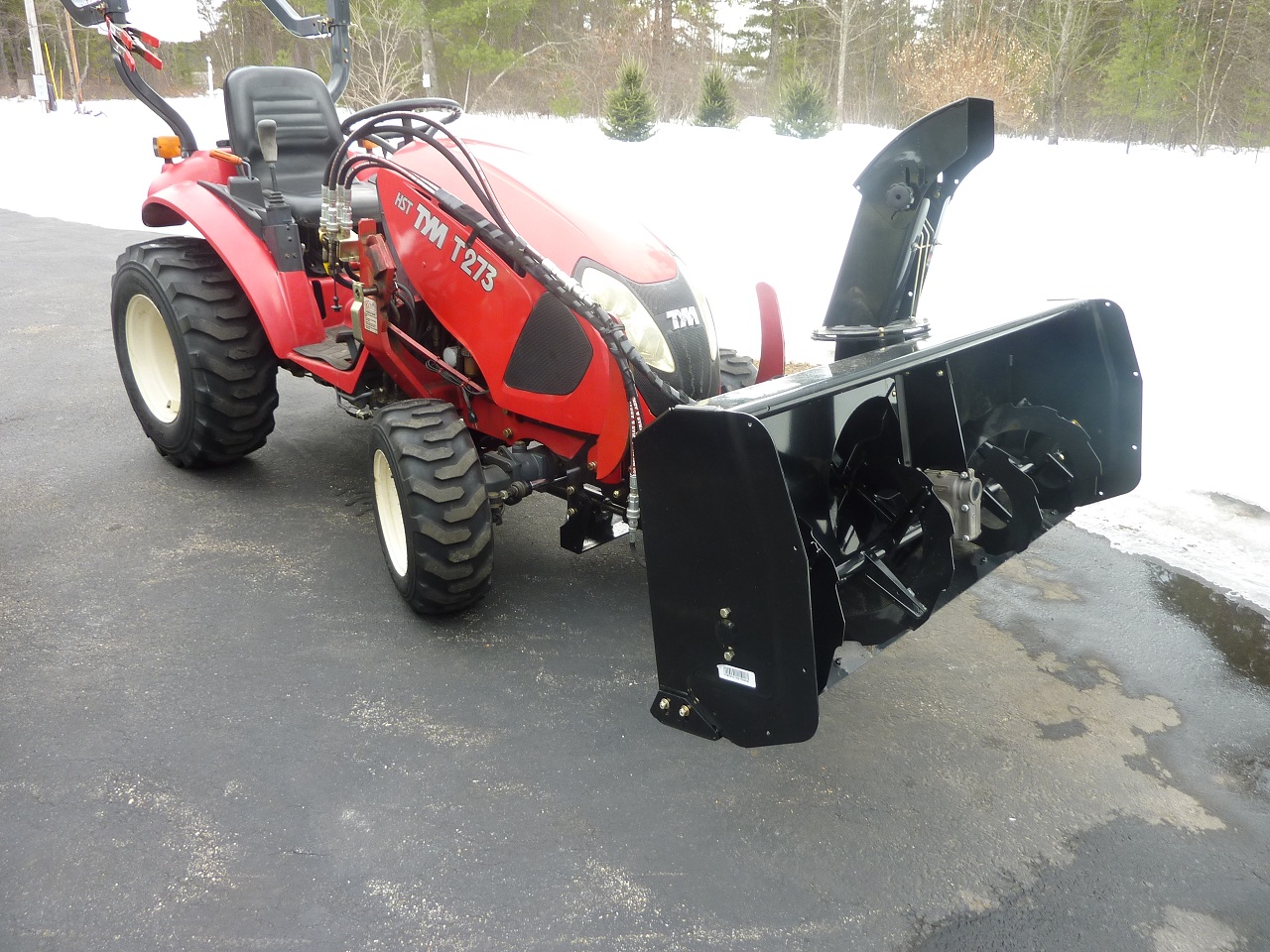

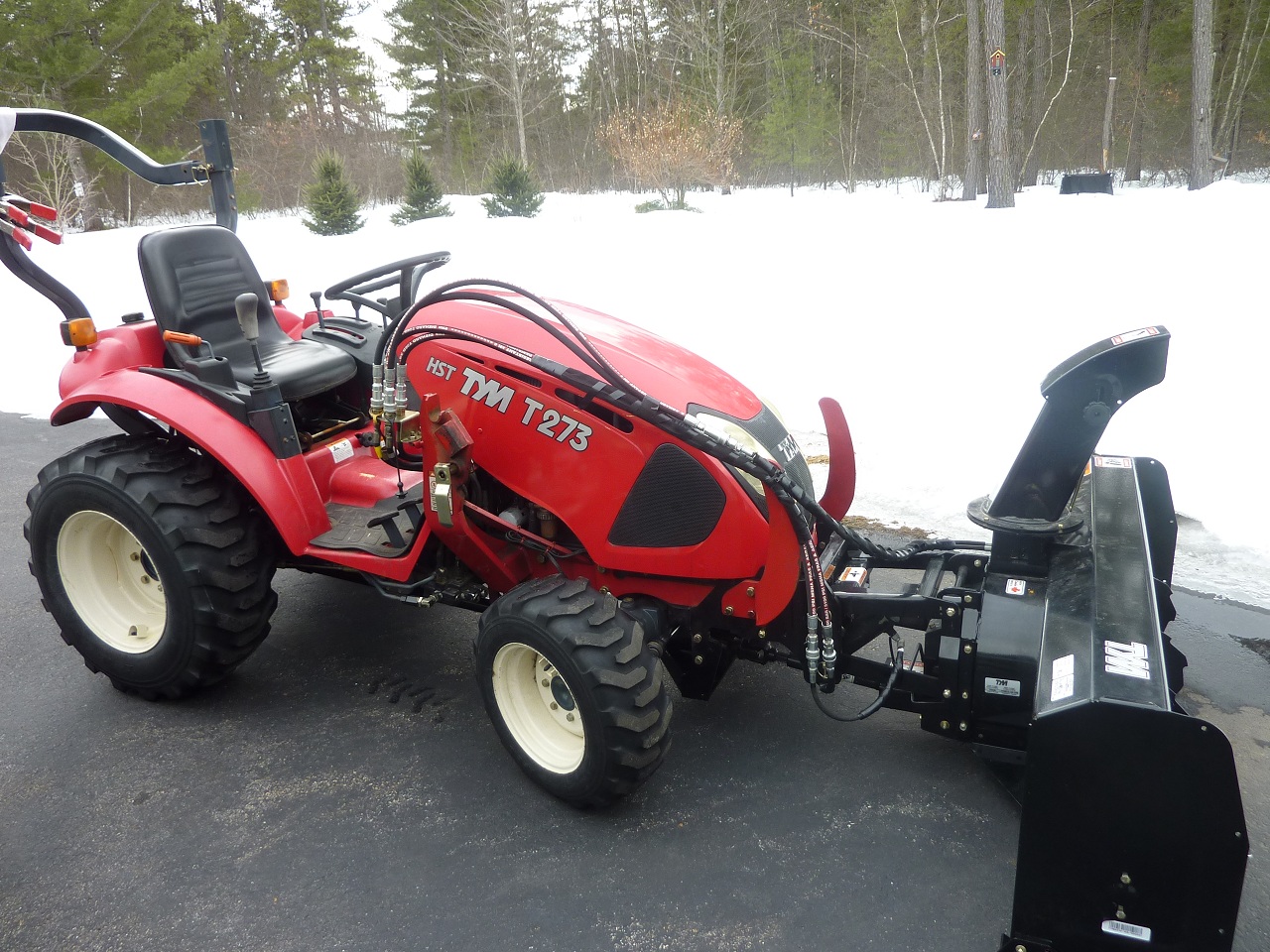

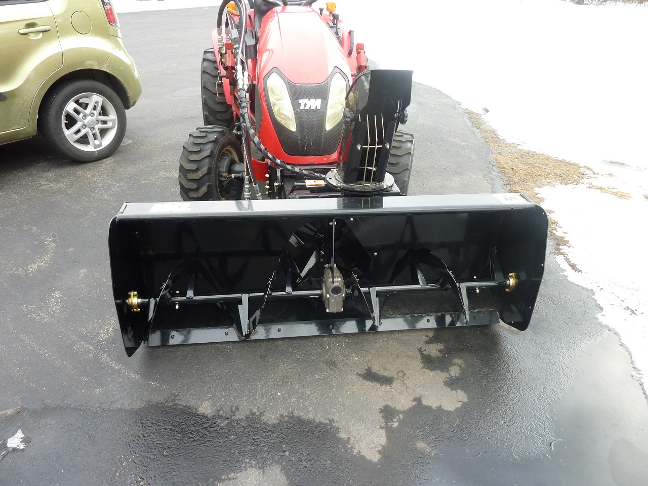

Wow, Finally got a pic to upload. have to try again .......... I guess my pics were too large before??? Reduced them 50% and they uploaded.

Do those hoses always go over the hood?
They do not actually go over the hood. They are anchored to the left front grill support and follow up the side of the hood to the Hy connections. Not a problem opening the hood.

The pictures are misleading. I have a diferent blower and mine are much lower.

Just after I took the pics of my TYM Snowblower I lost the blower gearbox. Bergmac from Canada built it and covered the defective gearbox. A local Machindra dealer who is a Bergmac dealer made the repairs for me under the warranty. Just installed it back on my TYM273 yesterday and today we're looking at a foot or more of snow. Great Timing!
