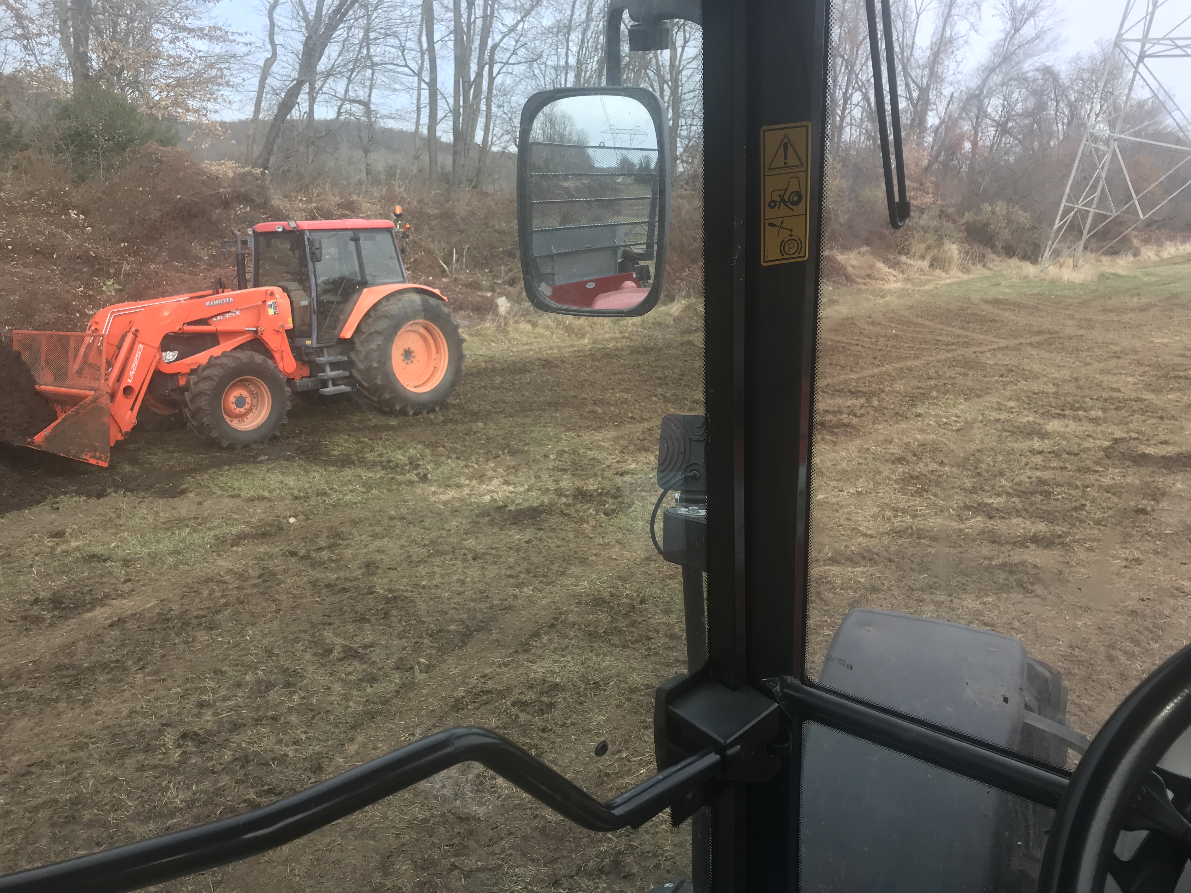

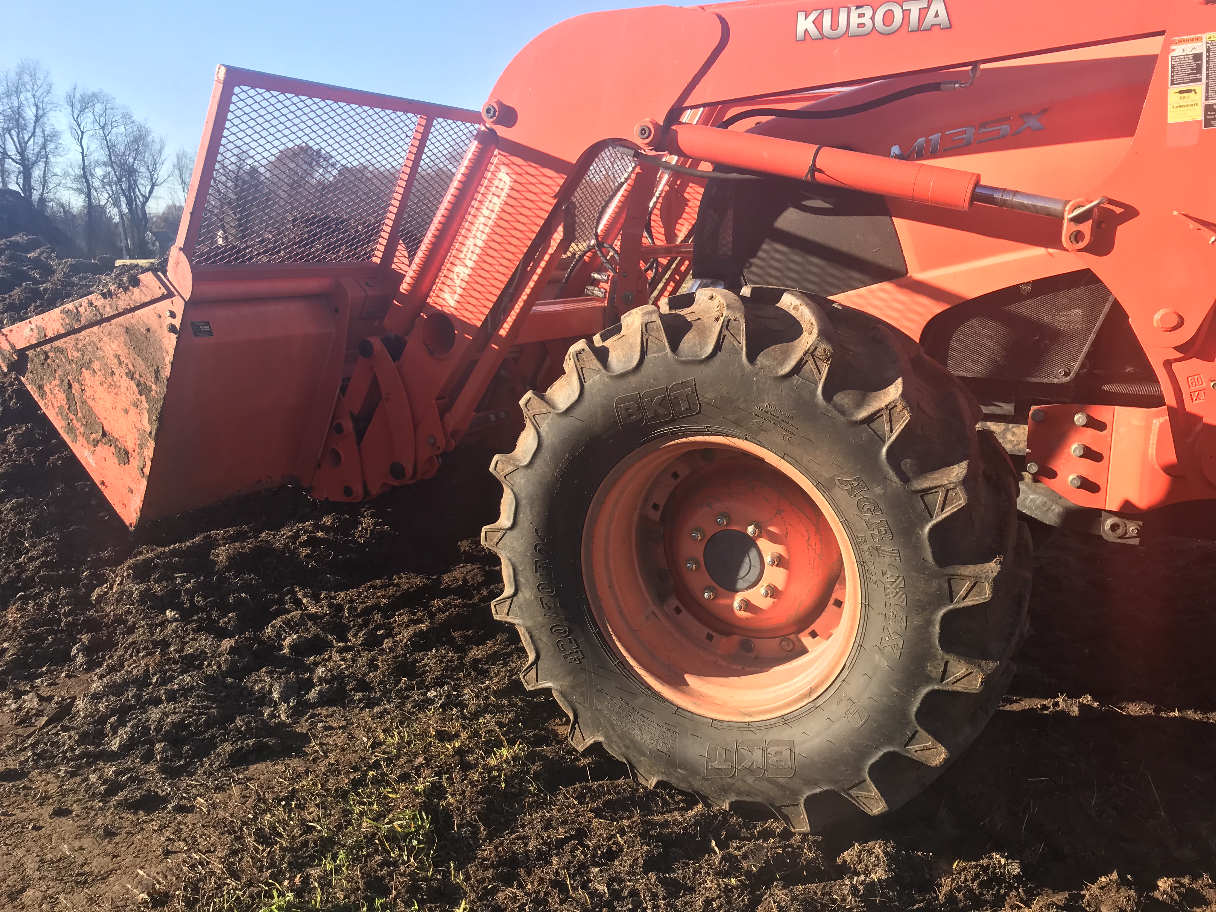

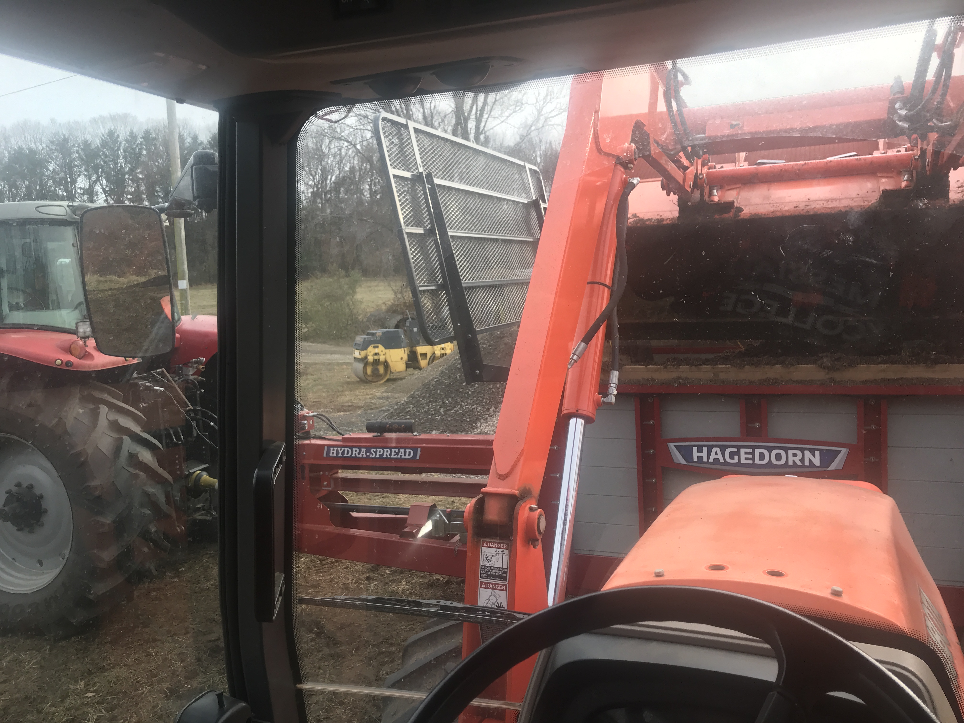

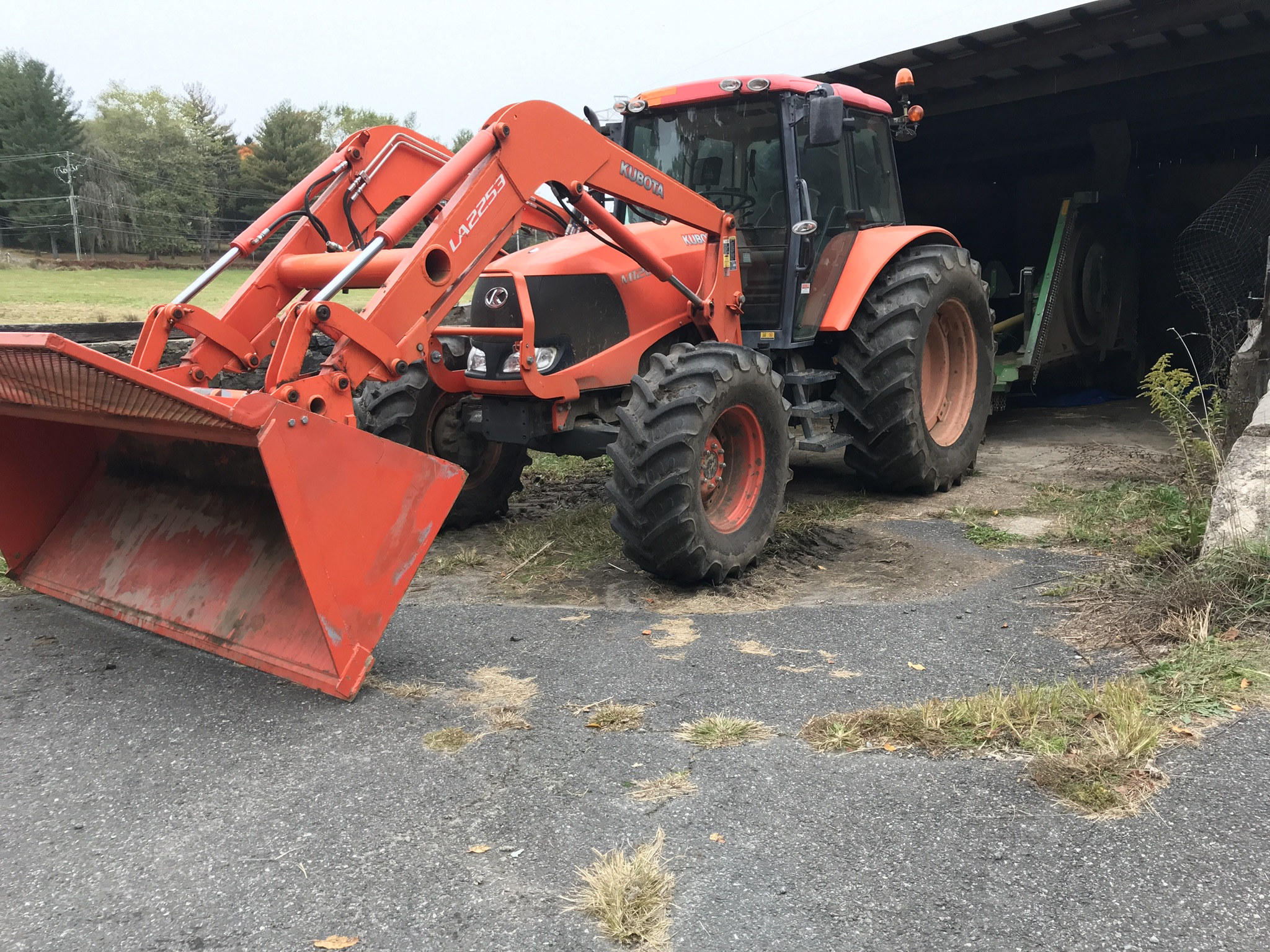

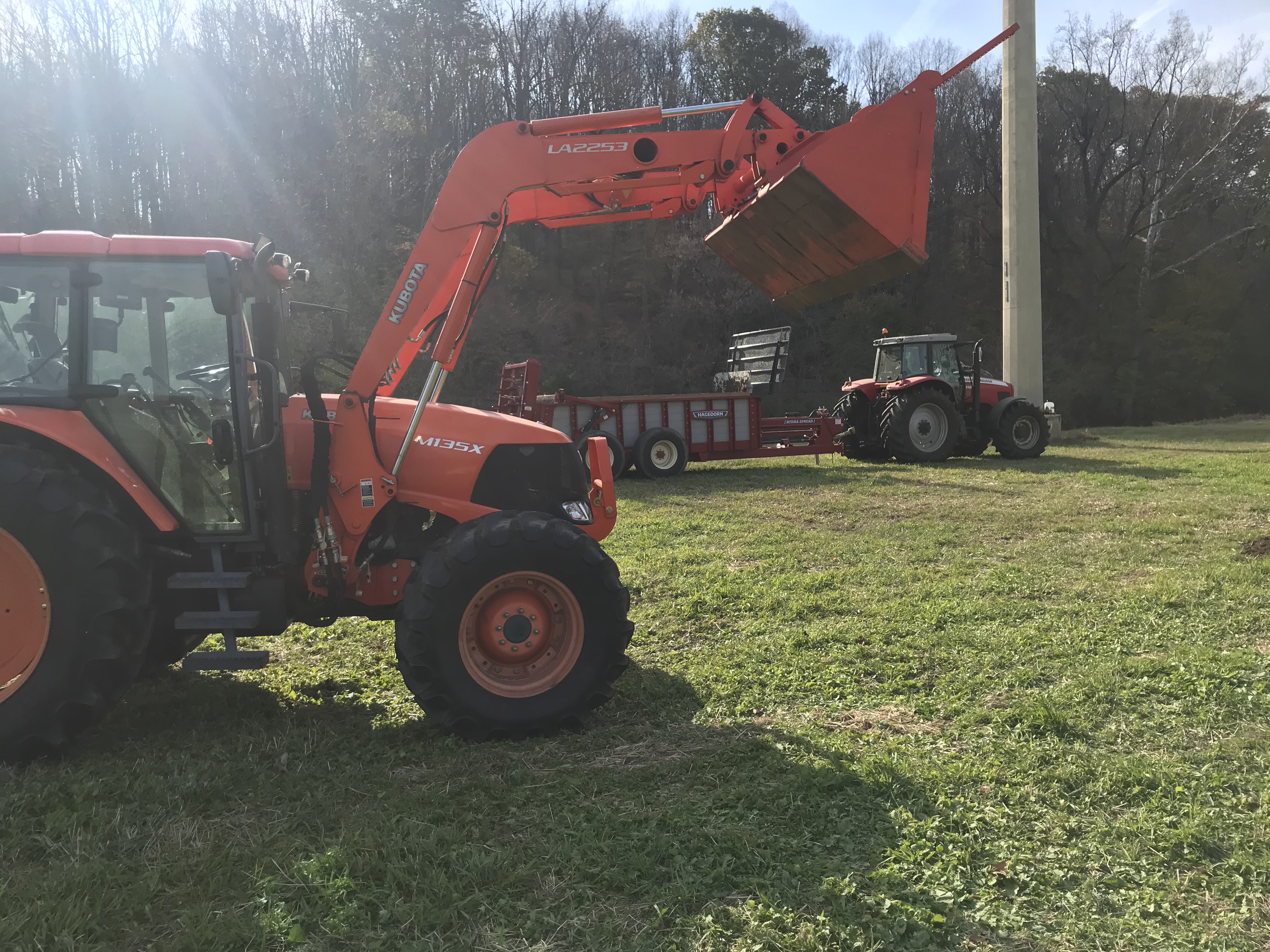

I have the Kubota 8 light materials/snow bucket.
Its not heavy duty, but its plenty strong enough for snow, topsoil or stone. I have run thousands of scoops of top dressing soil and buckets of snow through them and they have held up great
That a nice size bucket . I call the deal today to get specs for the bucket it a HD bucket she toll me the other bucket is the same size as my bucket that why am trying to get the specs to see if they are the same size .My friend here has a M1811 bucket that he got at the same dealer .
