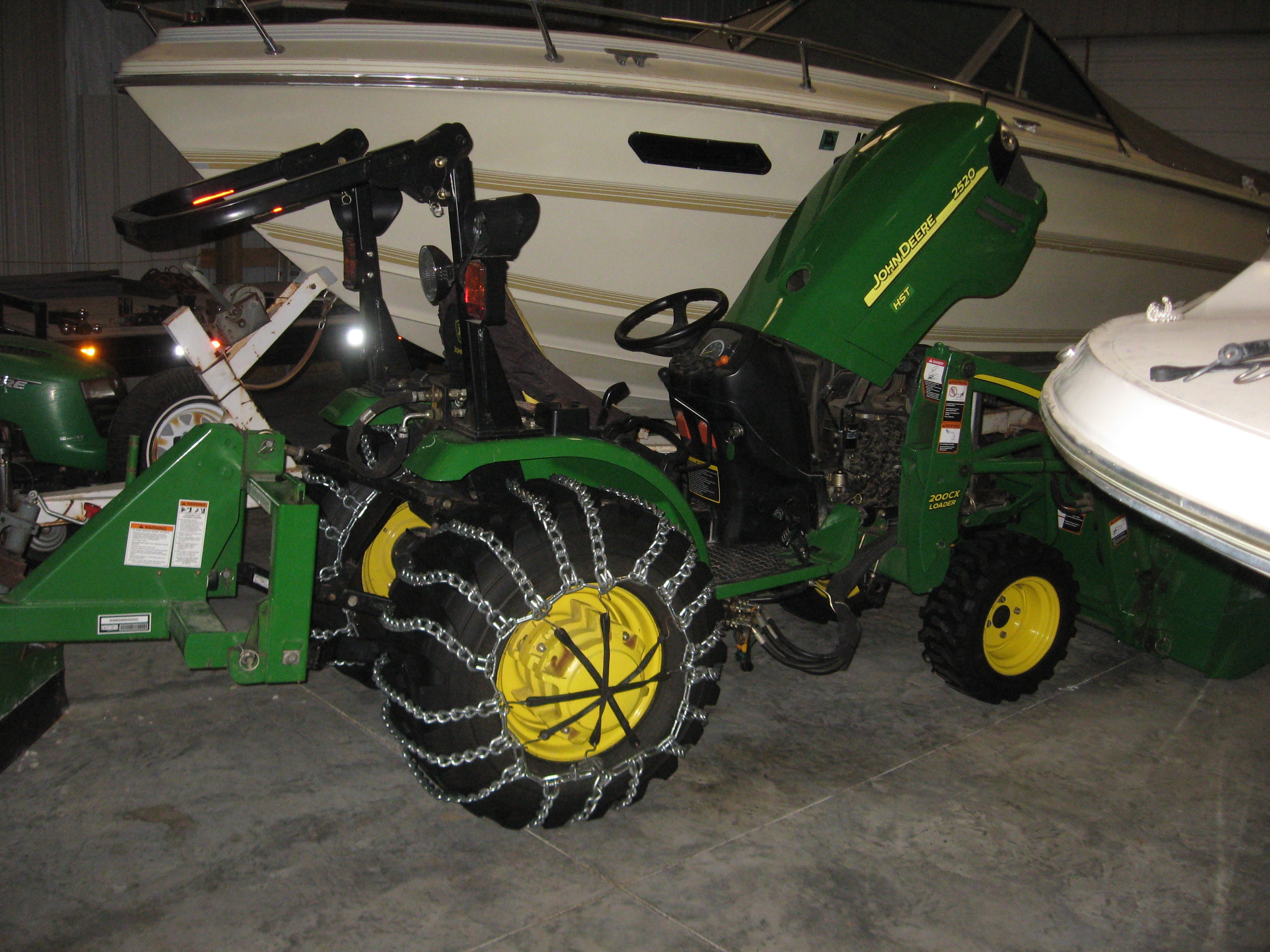

I envy you guys that can get such a tight fit with your chains. As tight as I can get them, I still have to use bungee cords to make sure there is no slack.

First question for you, is the inner chain as tight as it can be locked to the last useable link?
If not, you can release some air straighten the ladder chains and then reattach the locking link and tighten the outer locking
link to the same tension and then reinflate the tire and you should no longer need the bungee snakes.

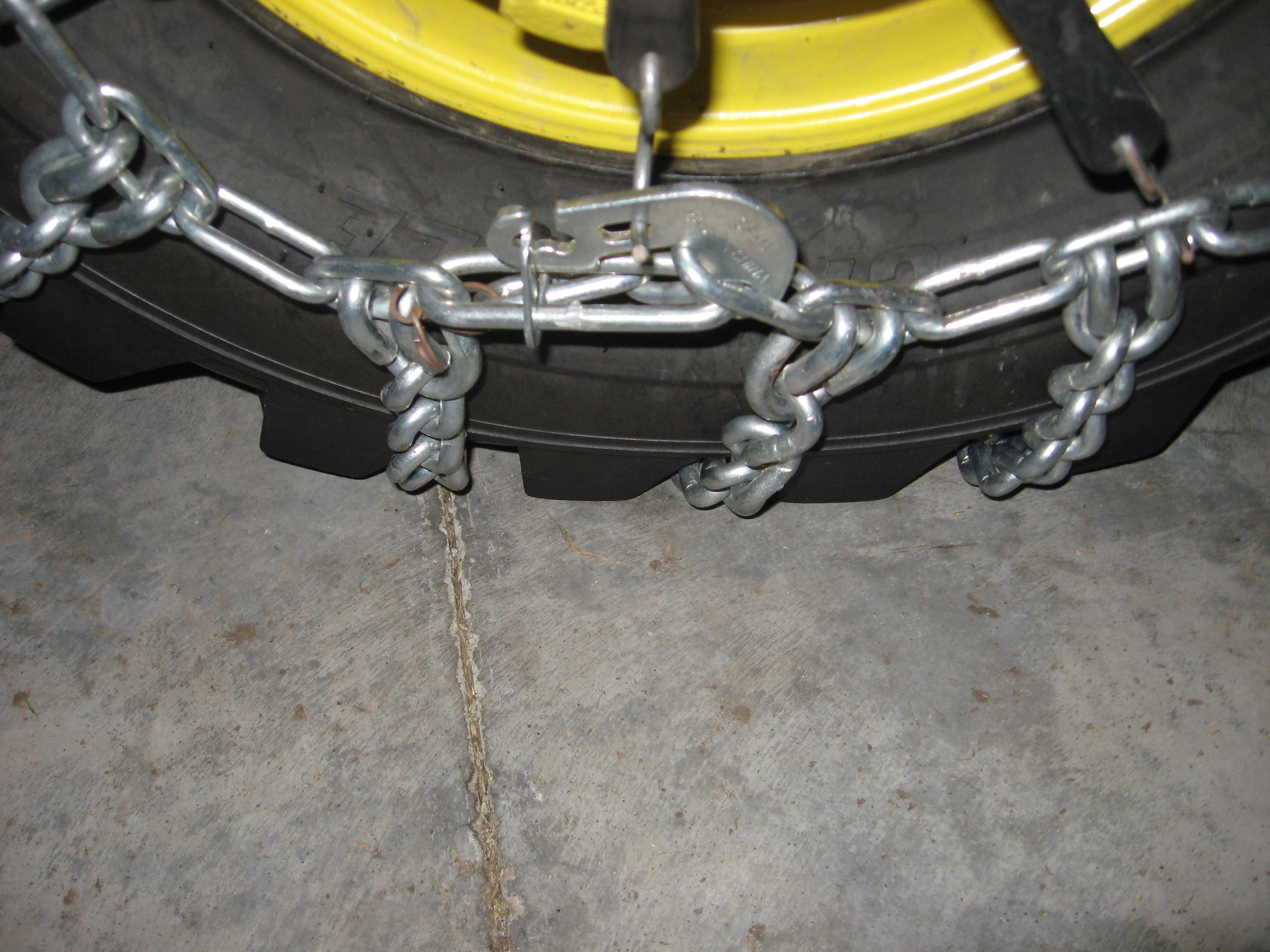

Those are excellent suggestions, thanks. Pretty much have them on the last links available outside (first pic) and inside (second pic). Have also tried increasing tire pressure after mounting and it does help somewhat.
Although these chains were recommended for my tire size, I had to adjust by removing one cross link and shortening the sides a little, but this was as small as I could go.
They aren't crazy loose without the bungees, but I am pretty paranoid about having them hit the three-point arms or fenders.

To the best of my knowledge no chain manufacture recommends reducing tire pressure to install tire chains and most have cautions against inflating tires to tighten the chains.
