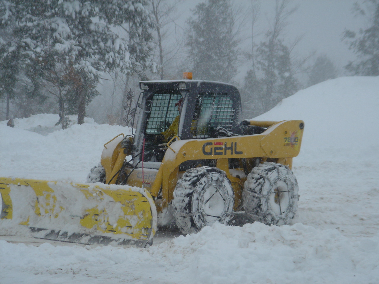

   / Snow Clearing Technique, what is yours? #39
Think snow!
