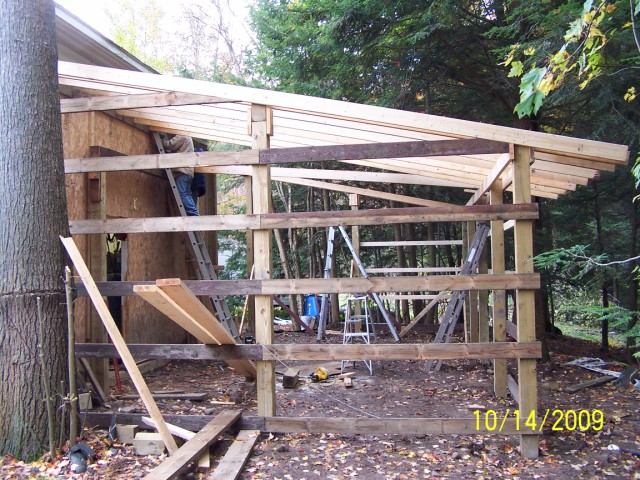

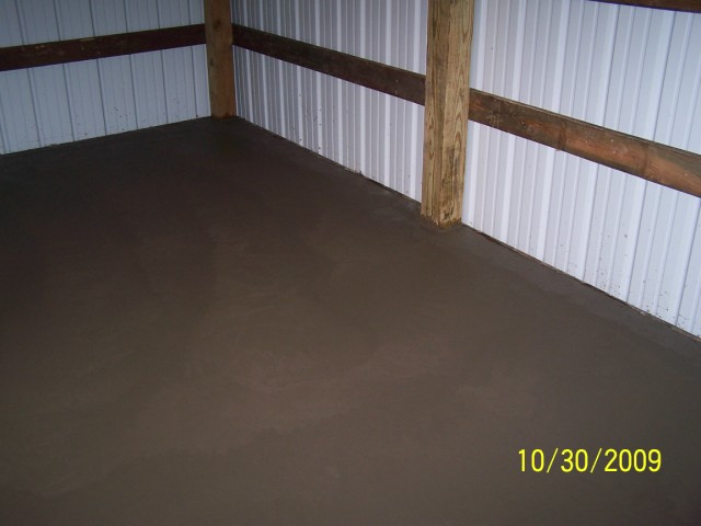

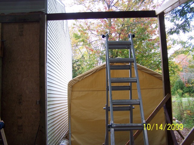

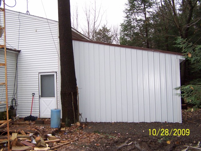

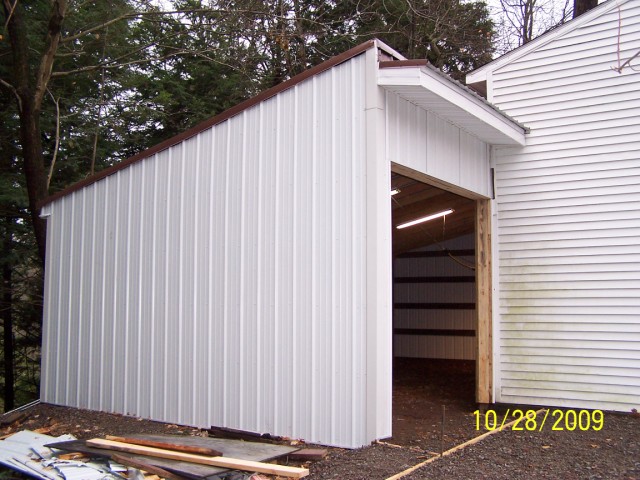

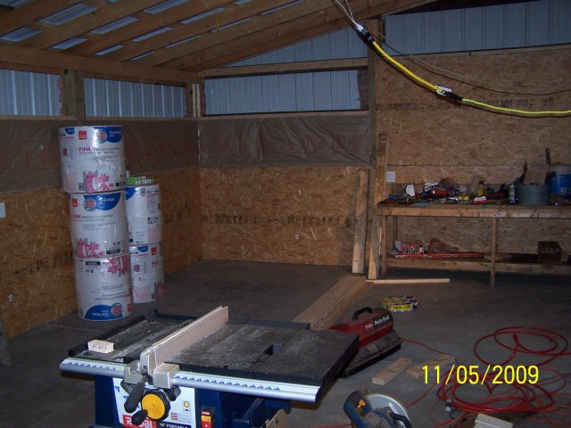

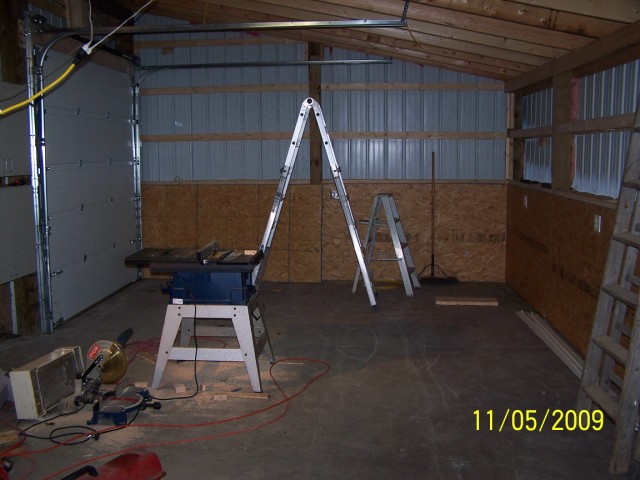

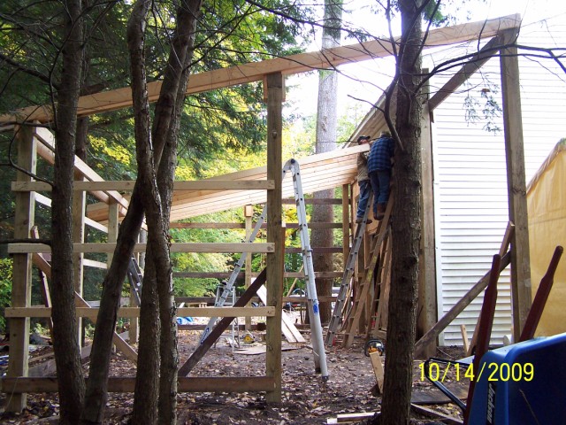

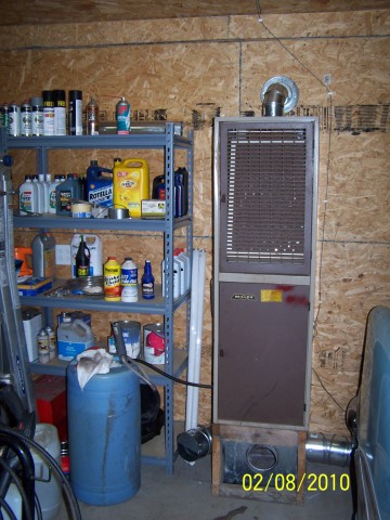

I had the same thing happen last winter to a 10 x 20 tarp style carport. I bought two and had them anchored down and connected end to end making it 10 x 40. One of them collapsed on top of one of my classic cars during a 2' snowfall 2 days before Christmas last year. The second one collapsed last week after 3 days of heavy wet snow. Fortunately there was nothing in it this time. I've since fixed and repainted the car and built a 16' x 32' pole barn addition onto the back of my existing garage. I used 6 x 6 pressure treated posts on 8' centers. I used metal siding and roofing. Then had the floor poured. When that was set up enough to work in I insulated the side walls and ceiling, installed outlets and wiring for lighting and put 7/16". sheathing on the inside. Here's a few pics.
