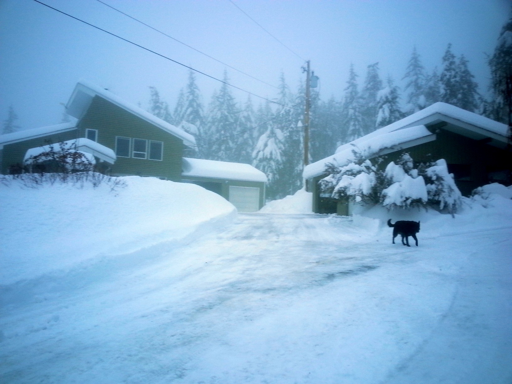

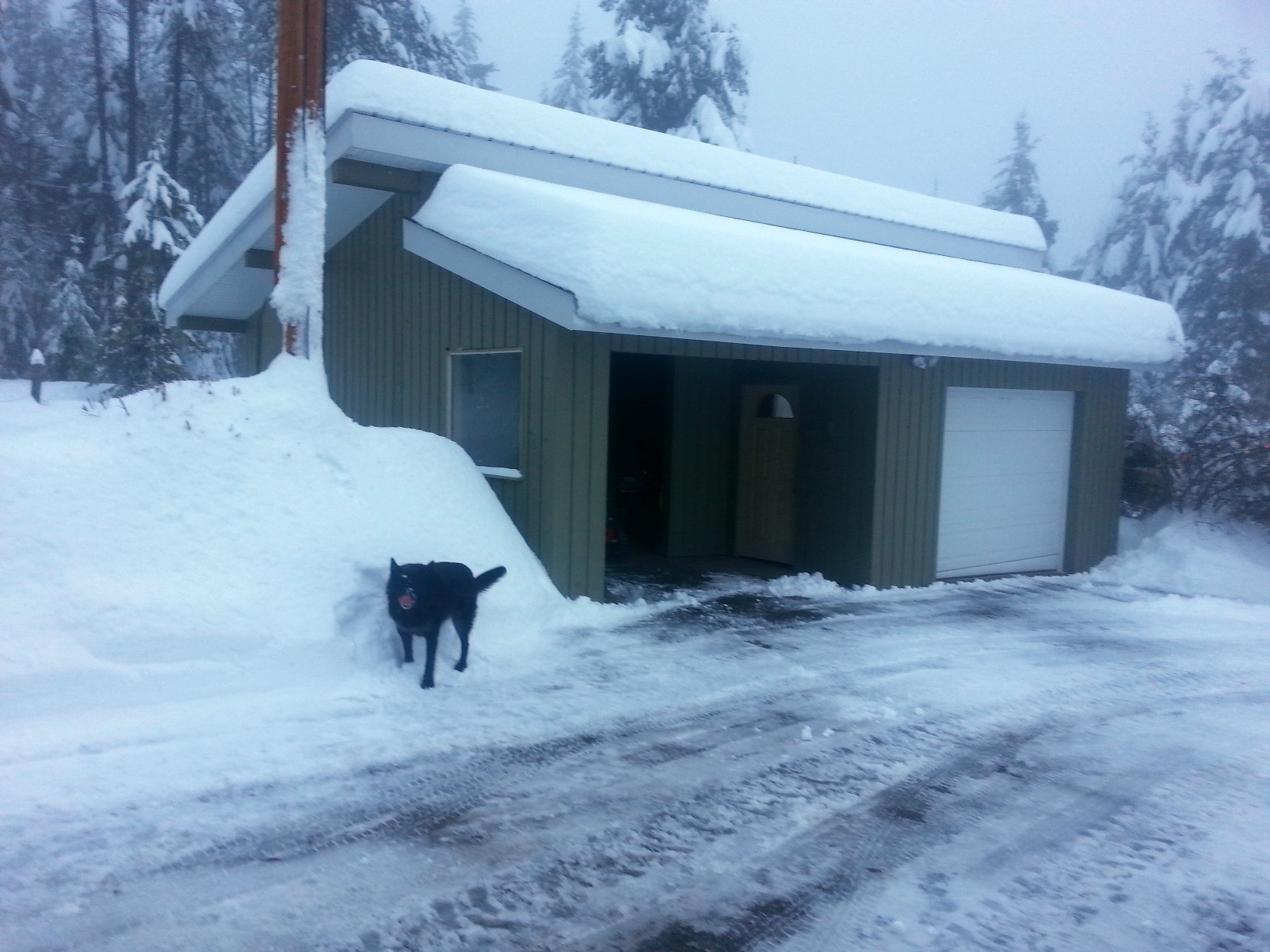

This is a timely thread for me since I plan to install some kind of shields on this shed:
When the snow is wet and dense as shown in the photos it is just about like concrete as soon as it falls off, and it is often dangerous until it does fall off. It slowly slides down leaving a 3 or 4' length hanging from the roof edge. I worry about the pets and go and knock it down with a shovel. But then it is still a chore to back-drag with the bucket so I can clear it with the blower. It is almost impossible to shovel as soon as it does drop off, and definitely impossible once it freezes.
The roofs on the house are asphalt shingles. The snow stays up all winter.
As mykleh states, it is good to speak with builders familiar with your local conditions and follow their advice. You also need to make sure your roof will handle the snow for the worst snow conditions. The design load condition may be more severe with adding snow guards since some design specs allow for maximum snow load on metal roofs without guards. The actual snow load will certainly increase from adding the guards.
My shed is a 35 year old pole shed which I am sure was not built to any codes. It has stood this long with no problem or clearing so I'm confident it will withstand the snow. Plus...it's a shed, and not too serious if it did get damaged. I would be more fussy checking it out if it was the house roof that I was planning to change.

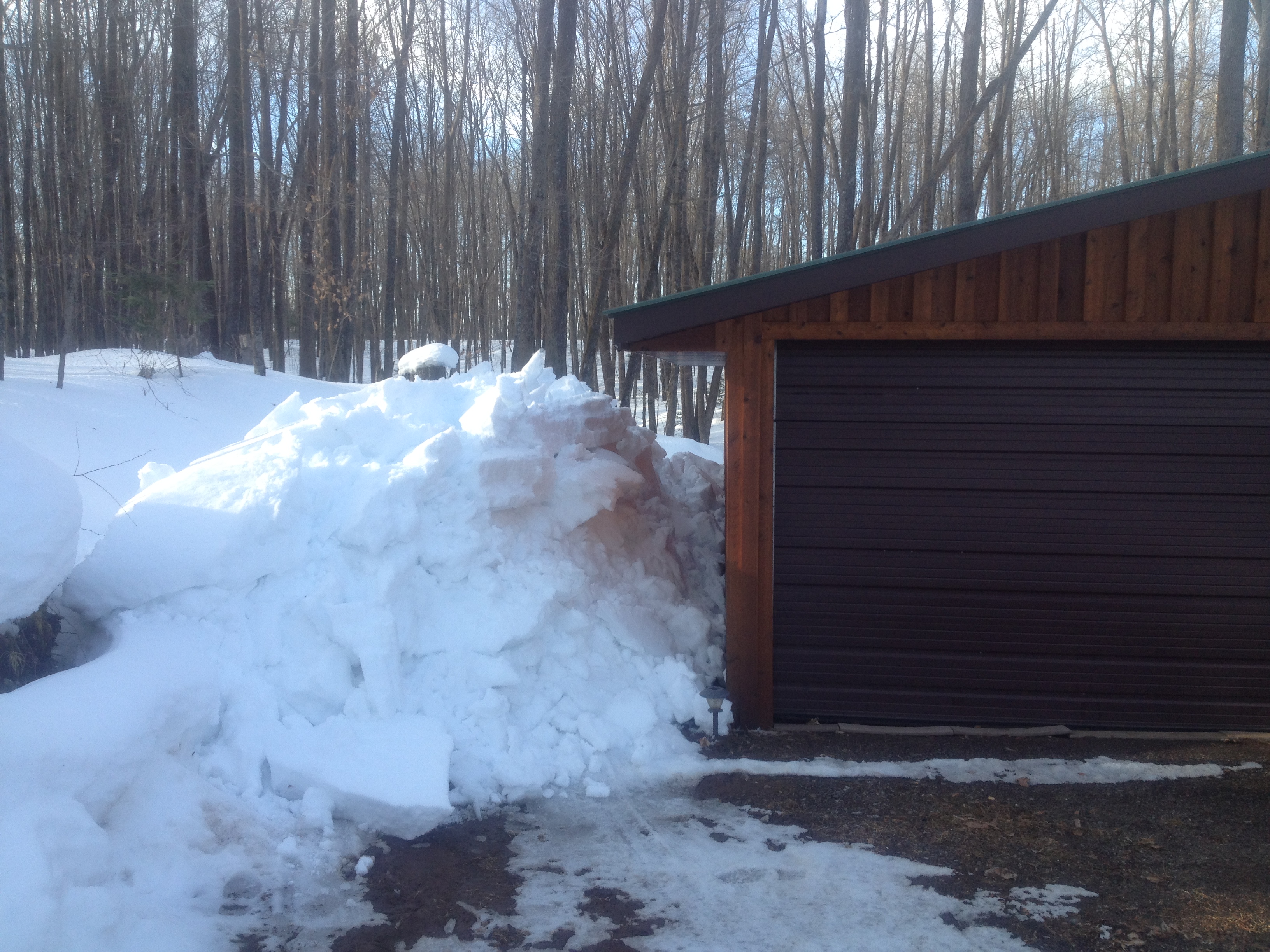

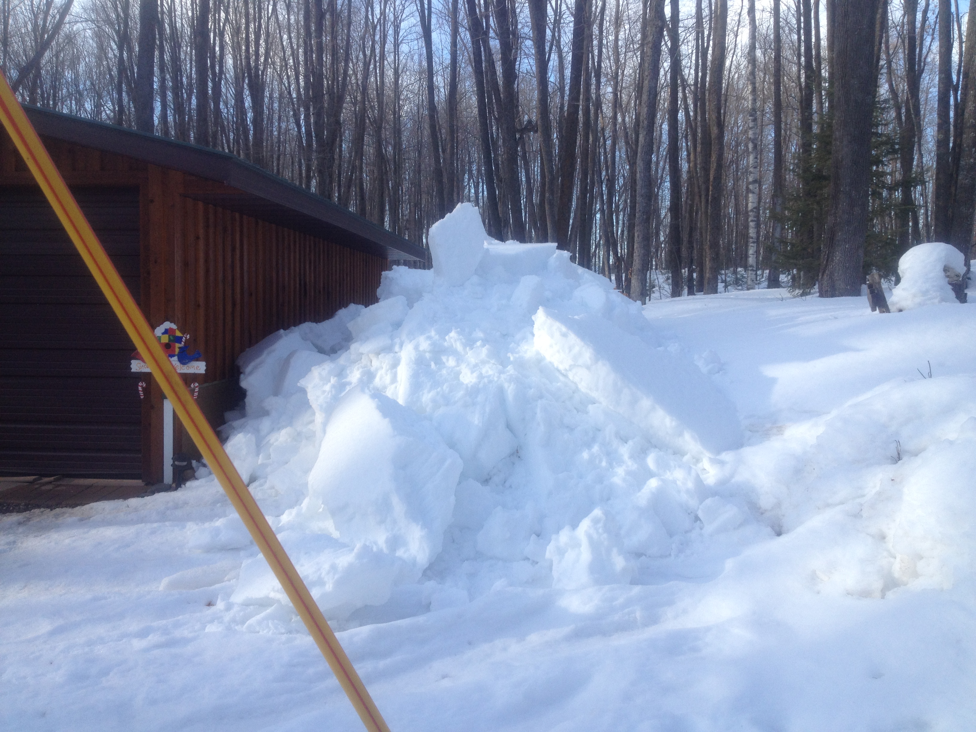

one other thing to think about is area around when it comes off.. here are pics of when it comes off my garage.. I made sure I had enough clearance on each side of the building clear for it to have somewhere to go and not smack back against the building or fall on something..20140311_221839248_iOS.jpg20140311_221858696_iOS.jpg
