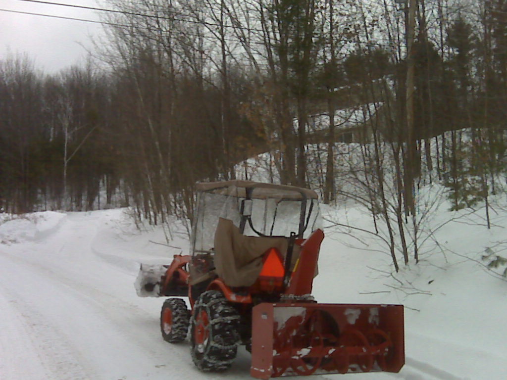

If you have a gravel hilly driveway, chains are the best investment you can make. I have a long steep gravel drive and when the ground freezes for the winter the snow gets packed and icy. R-4's or Ag tires dont matter. I put a set of rear V-Bar chains on my little 20hp machine and now it's a tank.

Oops. Forgot to add to my prior post....
I got the V-Bar chains from tirechain.com a couple of years ago, I think they were about $160 for the set.

Looks like I'm going to be getting some v-bar chains from tirechains.com. I'm pretty confident now that if I can maintain traction I can make my loader and box blade work for moving the snow. It might take me longer, but thats OK. Thank you everyone for the advice and happy new year.

I have a CK30hst and plow snow with a 6ft back blade. We get good snows here of a foot or more. Sometimes I use the fel bucket to move piles around. One thing that helps when using the bucket is to keep the bucket just off the ground which lets the extra fel weight stay on the front tires for more traction and better steering when it's icy. I do have chains for the rear, from tirechain.com, about $275, that really help. The duogrip work great, had them on an older tractor, but they don't make them for the 15-19.5. I have the ladder chains without the v-bar but bought the two link instead of the four link. I plow my cement driveway and my neighbors asphalt driveway and don't want to tear it up to much. V-bars can dig in if you spin and the two link will keep you from bouncing. Either way, you should be fine with a set of rear chains. Have fun with the snow. I've plowed about five times so far this year and it's falling now. I'll have something to do in the morning. :)
