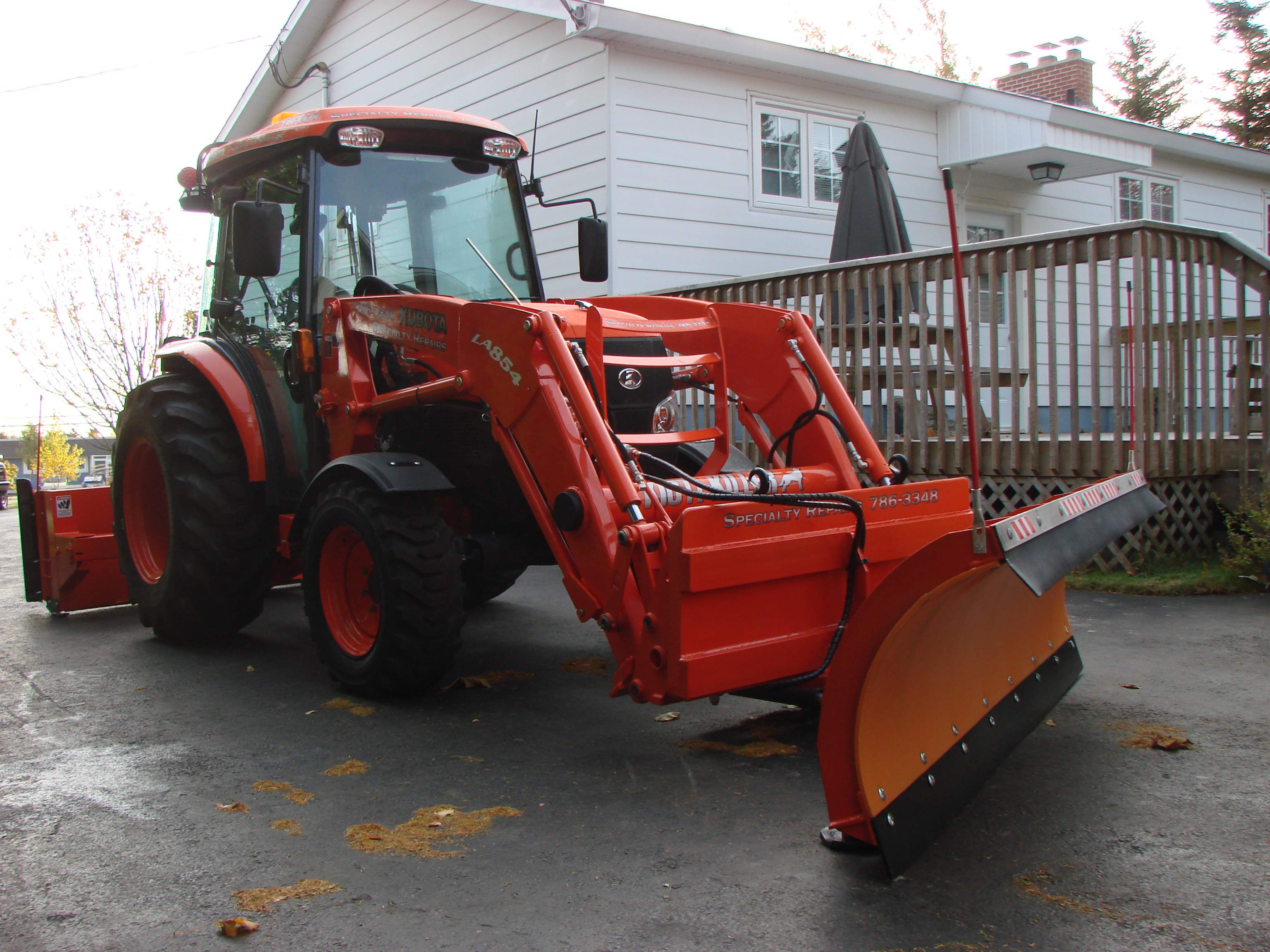

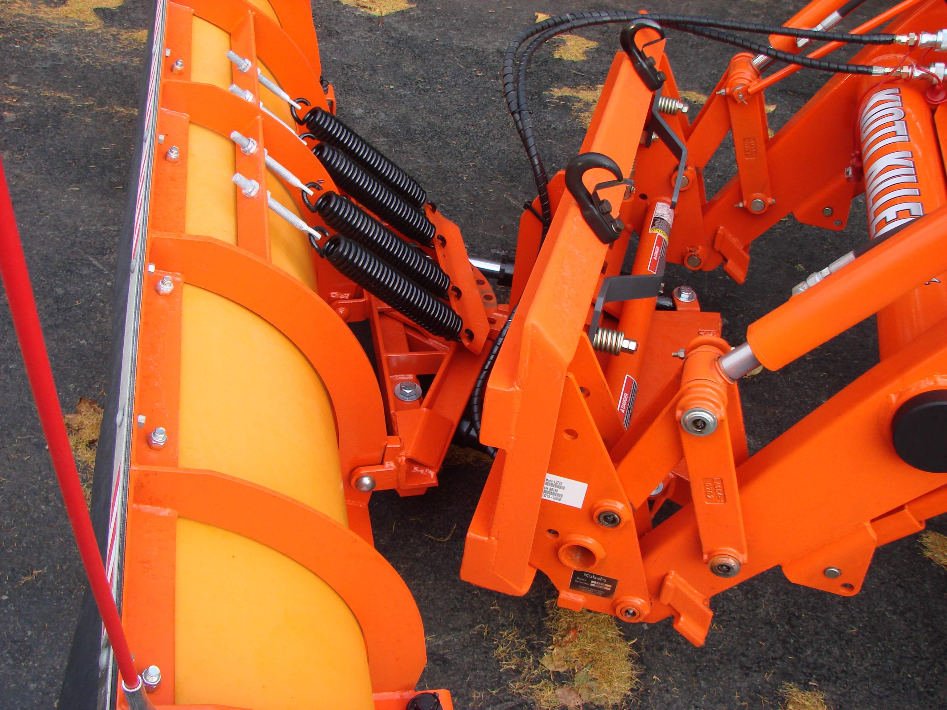

Very nice job! I like the way you brought the blade in close to the mount. My factory blade hangs out at least a foot further than yours which makes it clumsy to manuever at times. If you have to plow any areas that are not paved, you might want to hing or float the blade on the mount. On my gravel drive I cannot float the FEL arms or it will dig into the driveway.
Can't wait for the snow pics from you.

Thanks Ford850. I wanted to try and bring it in as close as I could. It would have looked so odd seeing it mounted right up on the front I had to do it that way :rolleyes:
All the places I'll be plowing are all paved but I've always kept the skid pads on the blade throughout the years and there still on there now. There's so much pavement around here I'd have trouble finding dirt :D Thanks for your reply.
Someone asked how far it angles. Here's a few pics.

WOW what a professional looking job.
I wish you were in my area so i could hire you -I have a sno-way plow and would like to do the same after seeing yours I have to do something.
again nice job...

Loosely translated.......... not only do you do nice fab work, you also made sure everything is painted nicely to match the tractor.
What i'm saying is...... nice work ! I'm jealous !:):)

Beautiful Work!
   / Snow plow adapted to the FEL #20
Very nice job!
My plow setup uses the pins from the old plow frame on the skid steer mount and thus places the plow much further forward than yours. I really like how much you have been able to shave off that distance to the plow.
I hope to read how your setup works for you this winter. Good luck with it!
