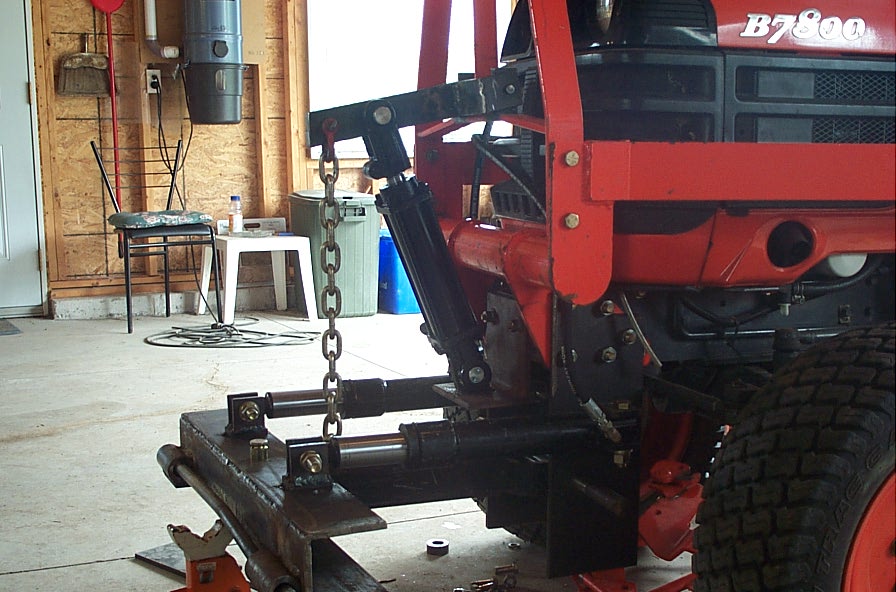

If you look at my plow lift you can see I got some influence from ASGAR.
Thanks :)

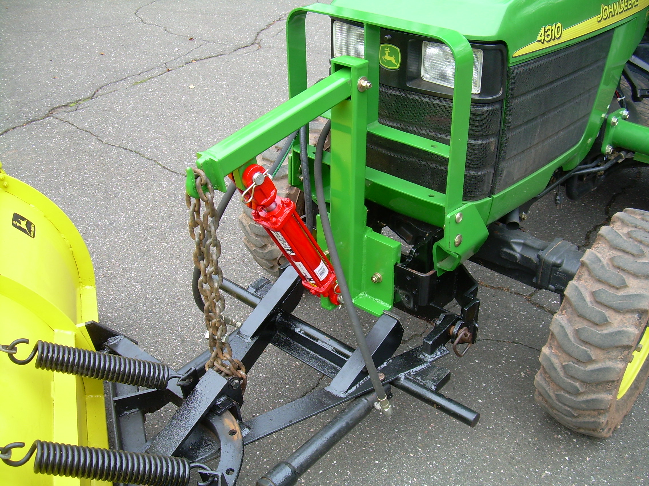

I am a new member, joined-up this week. This is by far the best info site I have reviewed...
I wish I had discovered TBN site before I built my own plow. I would not have suffered through the regenerative hydraulic antics you described so well ASGAR. Thanks for taking the time to write the explanation, very helpful.
Also, I'm interested in your comments regarding my plow design. I made the blade out of 1/8" material, it is a 72" x 24" blade. I will upload more pictures shortly. Actaully, I'd appreciate comments by everyone...
I also used a tie-rod type cylinder for lift and 2 x single acting cylinders on the blade swing.
I like your plow harness. I am now considering adding longitudinal members on mine once the snow season subsides.
Lastly, thanks to your comments earlier, I installed a new hydraulic control valve this weekend, this sresolved the hydraulic lock-up issues I was having trying to adapt the Kubots L402 loader control valve to a combination double acting lift and two single acting blade swing cylinders... the new dual lever valve open centre spool valve works very well... thanks again
Dan

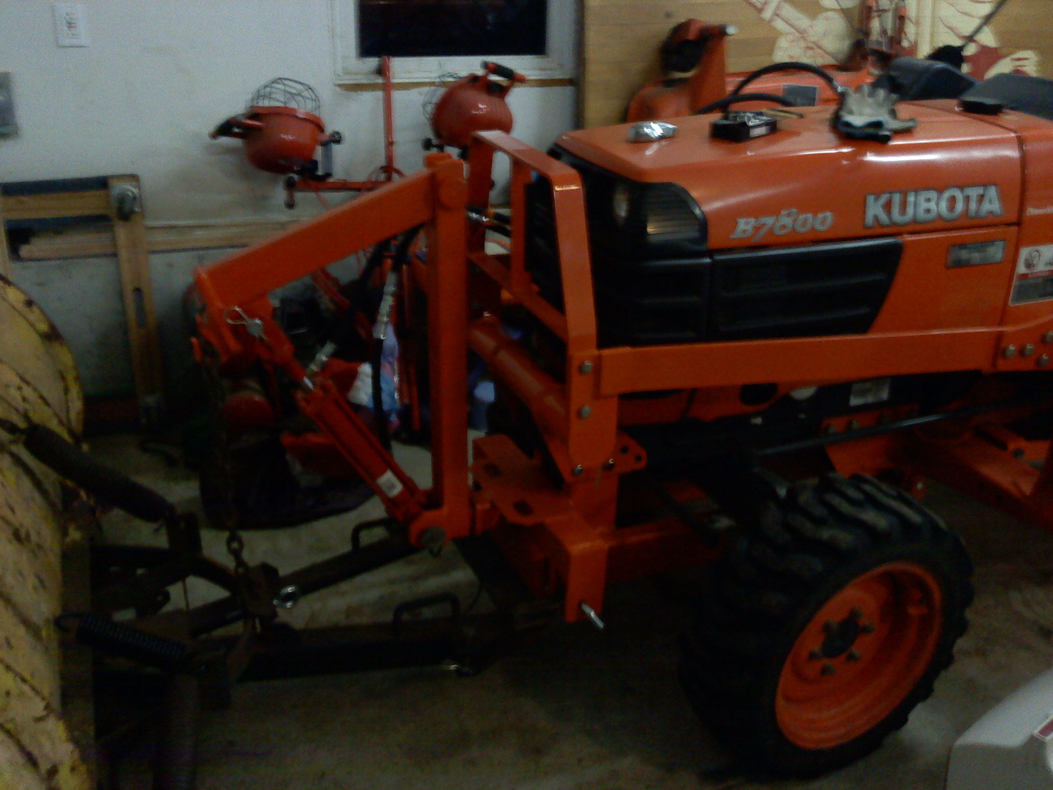

Thanks AZGAR for all the info. It worked out well for me on my B7800. Plow was cheap ($100) materials were anout $125. Hoses and couplings from Kubota were outrageous. $175 for two hoses and two quick connects! Since I don't weld, but am a decent carpenter, I mocked up a subframe out of plywood and 2x4's and brought it to a local vocational high school to weld. Speedy Metals was very reasonable I thought and they will cut your stock to any size. That made things easier for the school to do. I also salvaged a receiver hitch from an old truck to save time and materials. Thanks again. Can't wait for snow and some new trip springs (the thing trips over way too easily).- J-Ski
