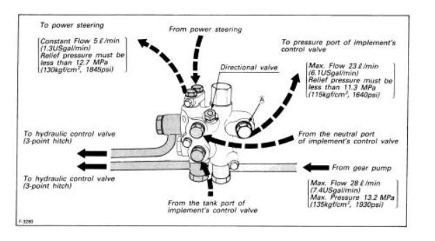

Well I think I can remove the FEL and use the aux. hydraulic block to get hyd. power to the valve bank on the snow plow's head gear. Judging by the attached picture I should be able to connect the pressure port to my inlet and my outlet to the tank port. The power steering and 3 pt hitch should still work A-OK. I will post some pictures as soon as I fab the plow headgear to the front of my already fab'd plow frame.

You DEFINITELY don't need to come back to the power steering diverter valve to make this operate. If you add a valve at that point, it must be in series with the circuit, or nothing will operate.

I even switched the hoses at the plow to see if one cyl was bad and when I tried it, it just angled the opposite way and jammed in the other.
The post by Kubmech about the regen. feature of dump is the best explination I've heard about what is happening. Pressure to both cylinders while pushing the joystick to dump (or angle right when the plow is on) would cause the cylinders to lock.
I have no overload relief valve that I have installed I'm sure there is one built into the tractor valve bank and built into the plow's valve bank. So that is out.
"You DEFINITELY don't need to come back to the power steering diverter valve to make this operate"... Well I'm not really going back to it, I'm going to the quick-connects that the FEL was hooked to; they in turn run back to the previously attached diagram's hydraulic block (the power steering diverter valve).
I think I'm all set now, I feel confident about the info I've gotten and I'm ready to go back to work reattaching the plow's head gear(the lift piston assembly). As I said before I will post some pics when its done! hopefully by the end of the week!
Thanks for all the help!!
