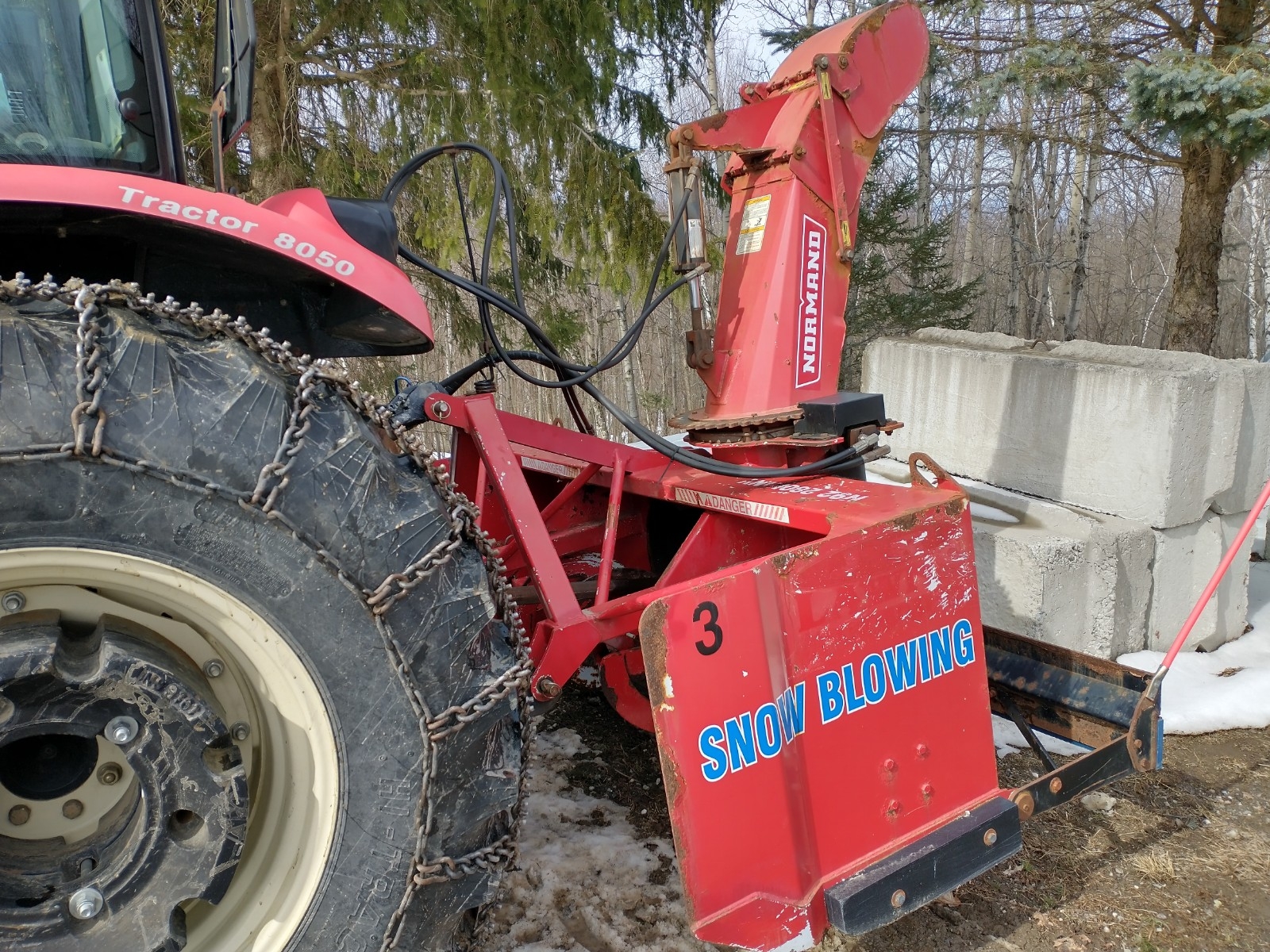

I have a front blade for the SSQA, it works good when the driveway is froze up hard, when it's thawed and soft not worth a damn. The bucket with edge tamers works better on softer ground or the back blade run backwards.
The pull type blower works real good 99% of the time and places.

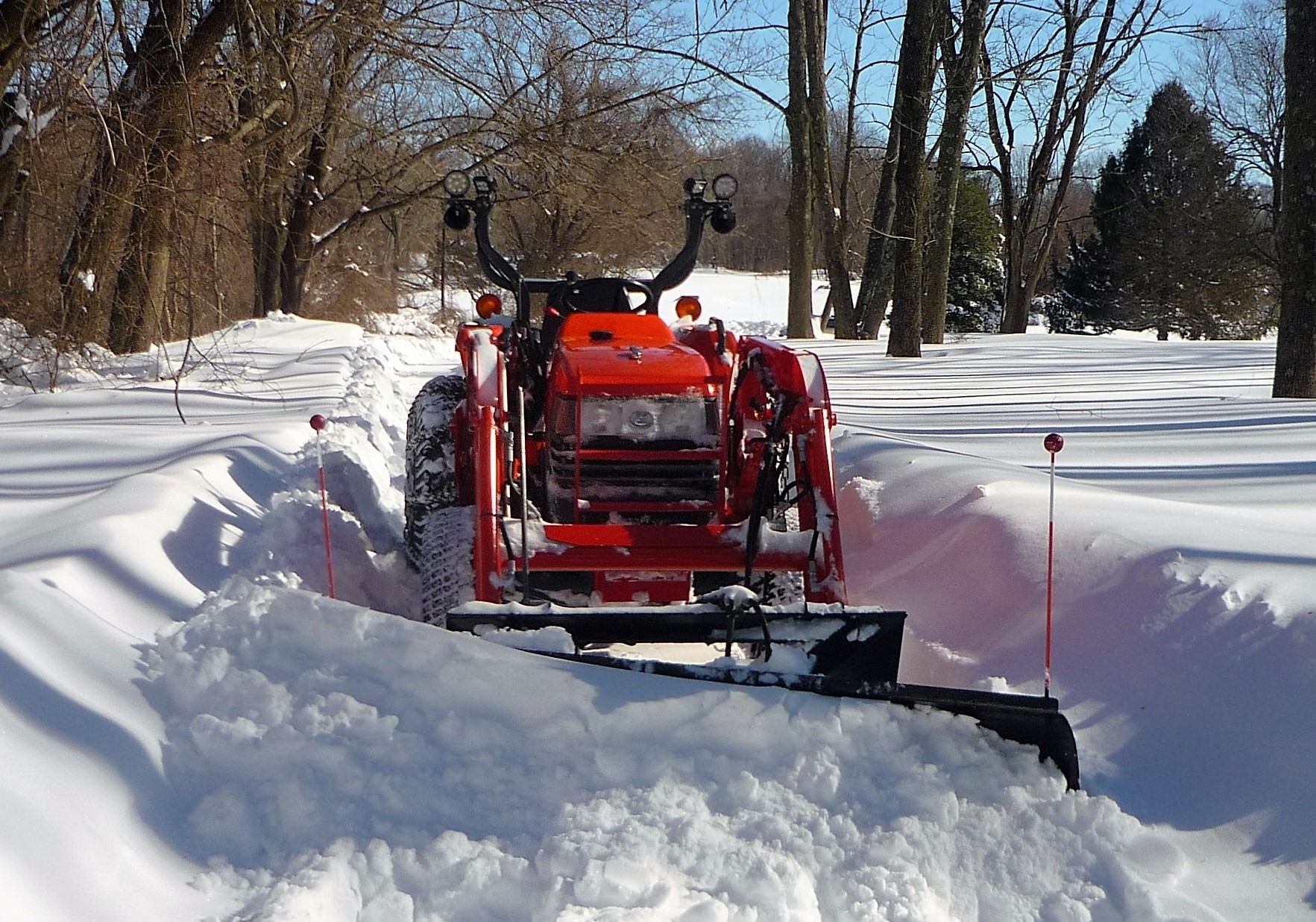

As you can see from my avatar photo, I have a 78" Horst Welding plow (SSQA) on my L3400. It worked for me (I say worked because it's been some years since we had any snow here). The comments about sticking out are correct. I mitigated the pushing effect by putting some 2" Kubota spacers behind the rear wheels, and I have chains for all four tires, but I'd only use them in "real" snow storms. I have one rear remote which works fine for angling the plow.
In Vermont, you might have regular snows that we would term blizzards, so I'd go for a plow that will be just as wide as your rear tires, when angled, of course. I've used the bucket and a rear blade to move snow, and the plow is so much better. If I just had a cab...
