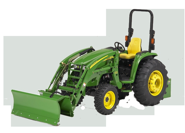

Hi All -
I need a Quick mount snow plow for the front of my 400 loader on my 4120. Definitely need to have hydo angle adjust. I think that means 3rd channel up front - correct? ANybody have any experience with the Frontier AF11 84" blade? What does a new one cost? What does it cost to have the tjird channel put in (with new control lever) at the dealer? Any other suggestions for a quick attach snow blade? Your help is appreciated.
Looks like a nice unit. Deere do not list a price for some reason. :confused:

Attached :licking:

Rockgod said:
Attached :licking:
Notice the wheel weights in the picture. Probably a good idea for this application. Lack of weight seems to be the biggest challenge when using these tractors to clear snow.
