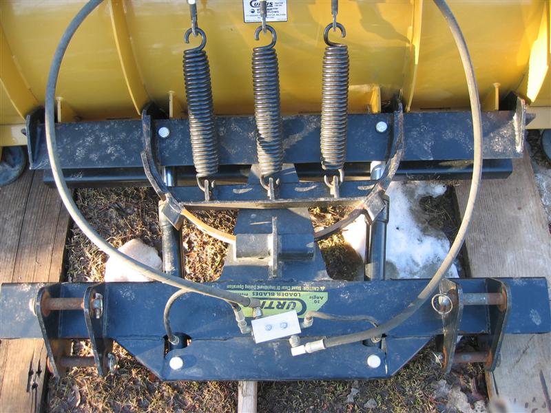

Does Curtis supply a cross over relief valve on their FEL mount snow plows? What is the small block with hyd. hoses attached for in the pic?

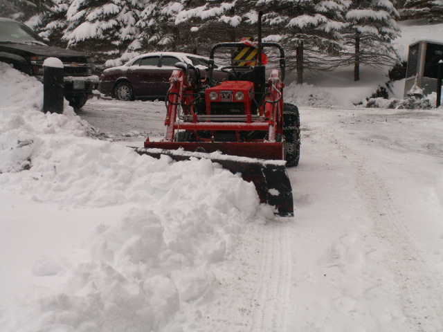

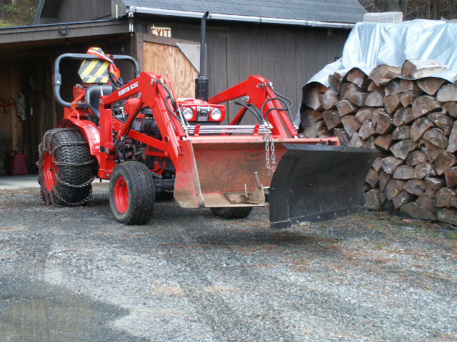

Plow my driveway and neighbors etc. for 14 years w/this setup,never had problem other than hitting mailbox handful of times :(..go slow until you get the hang of it. :)
Yes, that is it with the hoses attached to.
I have nearly the same plow.
Thomas, Are you going to use this setup on your new tractor ?

johndeere4300
"Are you going to use this setup on your new tractor ?"
Yes Sir..heavier frame w/7'6" plow this time but same height.
