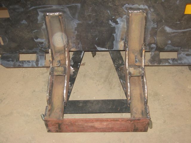

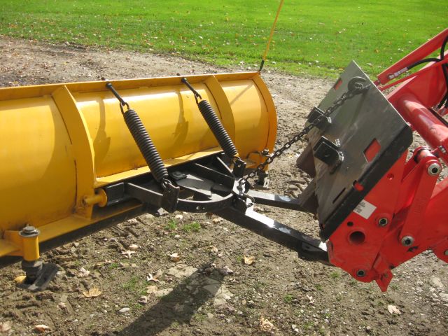

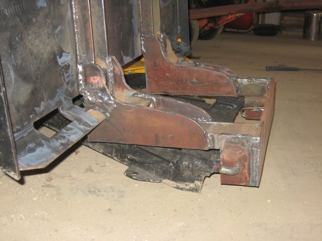

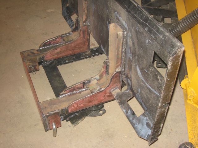

I built mine last year and it has worked out great. I bought a Meyers 6.5' plow that someone had attached to a QA plate but found it stuck out too far. So I made up new attachment points underneath and behind the plate. This way it is closer to the tractor,still will float with the chain, but still keeps the original frame intact so you can angle it with the cylinders(which I will get one of these days). I can also put downpressure by dropping and dumping the loader so the plate pushes down on the frame of the plow. Here are some pics before it got painted.
Jeff

Thanks for the pics. I had to look at them a couple of times each to see what you had done. I see the Meyers plow has a pivot point where the turn circle meets the back of the plow blade. My Fisher does not. If I see it right your plow can drop down until the lift chain comes tight and can pivot up only until the A frame hits the underside of the arms you used to move the attachment point to the rear. How dose it work? Do you get enough up and down travel for it to follow the ground or do you need to keep adjusting as you go?
   / Snow Plow Float, Chain, or Rigid #30
Full-trip plows will have that A-Frame pivot point on the blade. The Fisher plow is likely a Trip-edge design, the hinge is on the bottom of the blade.
